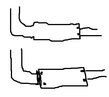

Well the 172 mk1 cat is designed to bolt on the same as the de-cat would.
Therefore if you had a downpipe made and then a de-cat pipe that's easily bolted on and off you would have to get a cat that was the same size when it comes to MOT time... if that makes sense.
Here's a crap pic i've drawn in paint which kinda shows it lol.
The silenced de-cat I have includes the downpipe so does the standard twin cats.
If you had a downpipe made up allowing you to just simply bolt and unbolt a de-cat pipe then you would have to get a cat that was the same size (without the downpipe). Do 182 cats have the downpipe built in?

So looking at your drawing Chris, would I need to get the cat cut out of the exhaust, and then fit a de-cat which could then be unbolted, with the original cat bolted back in?
I might be looking at having this done.
You would basically remove your 172 mk1 cat which stretches up to your manifold.
You'd get a custom exhaust place to create you a downpipe and then you could buy a 182 de-cat and 182 cat which is basically a straight pipe (without the downpipe attached) so it's easier to remove and put back on come MOT time.
