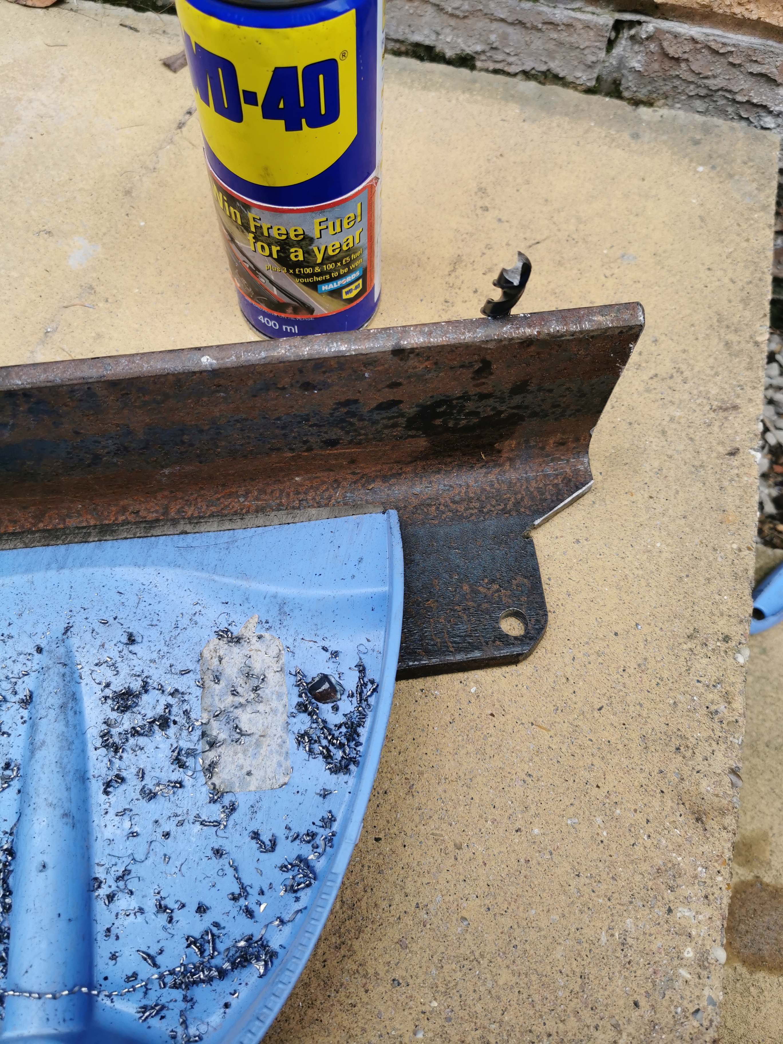

I managed to drill a 10mm hole through a chunk of angle iron with a cheap ass b&q drill I've had 20 years. Pilot drilled 4mm and tickled it up on an angle grinder. Ran it slow and used a bit of WD40 for lube and it went through easy. As you can see it cut nicely with no vibration or chatter and didn't blunt or overheat. Expensive drills aren't needed if you do it right.
