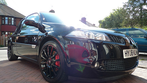

This rather tasty black R26 with Lux and 'Black Pack' belongs to a fellow forum member, who contacted me to see what I could do with the paint on his Deep Black R26.

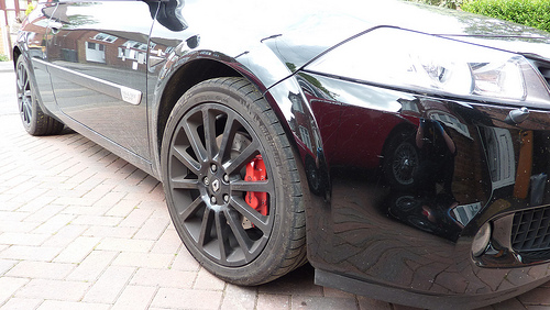

A few before pics - nothing too scary so far, just a pretty dirty Meg :)

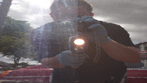

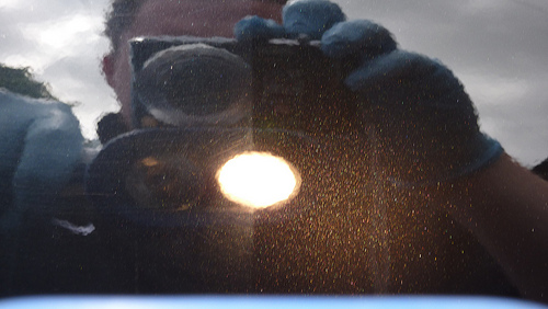

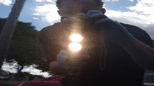

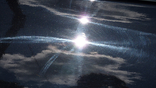

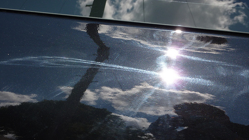

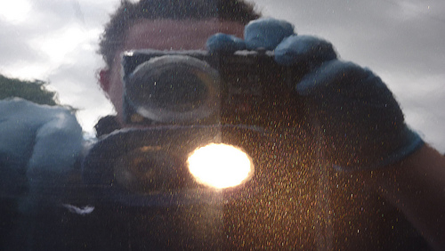

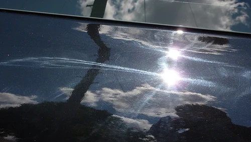

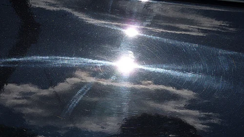

At this stage, the condition of the paint was becoming apparent under the unforgiving 11am sunlight/Brinkmann

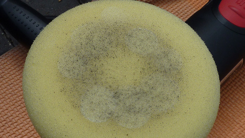

I began testing combinations of pads and polish. Now, for me, Deep Black (along with Racing Blue) has got to be one of THE hardest colours to correct, especially when trying to do so in the space of 8 hours or so. It marks VERY easily, yet can be a right bugger to correct. Use too firm a pad and you will marr the paint, too soft and you will do nothing! I had to use different combinations on most panels, and most panels had more than one set to get them to an acceptable level. Generally, I used 3.02 with either a polishing or cutting pad (new Megs 4" ones - great btw!), with the exception of the bonnet, which needed Power Gloss (S100) to get anywhere with, coupled with Menzerna's breeze block esque White Compounding pad.

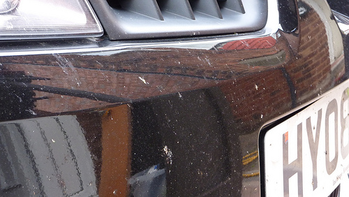

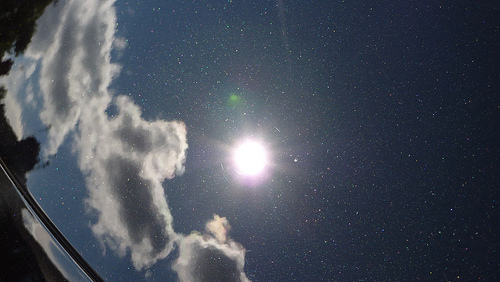

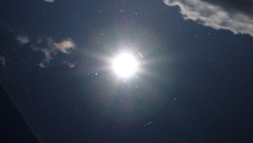

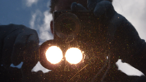

Here are a few 50/50's:
We also had a slight issue with overspray on the roof!!! :scared:
Which came off at the cost of my poor, brand new, pad!!

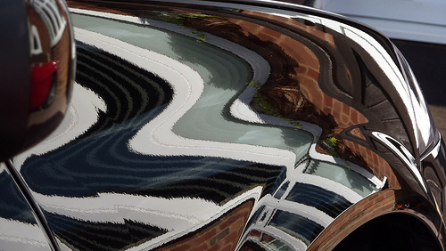

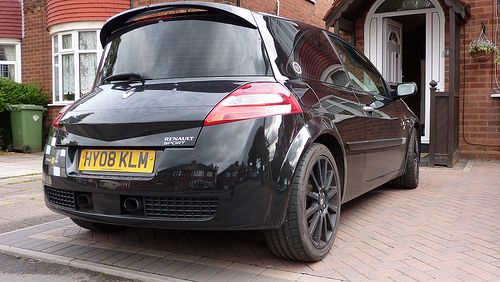

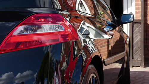

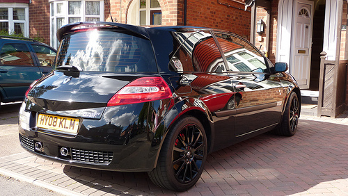

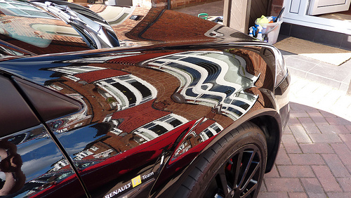

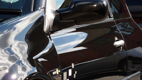

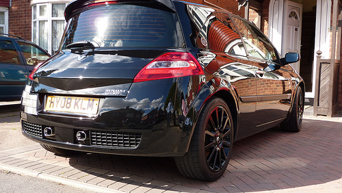

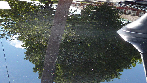

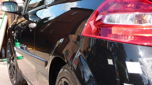

Some afters:
It was hard work this one, but it looked stunning when I was finished (excuse the modesty lol!)
