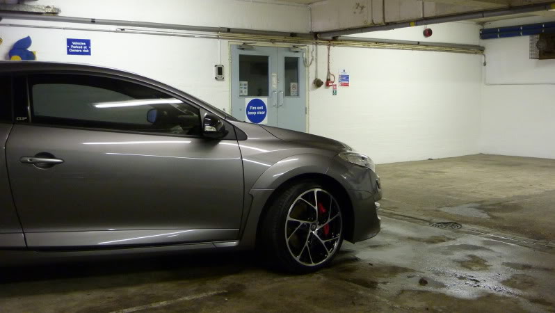

Today's car was a rather sexy RenaultSport Megane 250 Cup, in Oyster Grey, with optional Recaro's and 19" Speedline wheels. What a car! The build quality of this thing is incredible for a French hatch, it just feels so solid! I want one...
Anyway... you may recognise the location for this one; I have a detailed a number of cars here for the owner of this 250. He has recently bought this 250, and asked me to take a look at it for him to give it a good spruce up. I went armed with heavy duty correction on the cards, but was happily greeted with little more than minor hazing and swirling in the clearcoat. Otherwise, the car just needed a damn good clean and some protection.

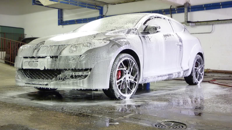

- Car snow foamed with Autosmart Autowash:
This was left to soak for 10 minutes or so, whilst I went around the car with another Envy brush, working the formula into the various shuts, sills and grilles.

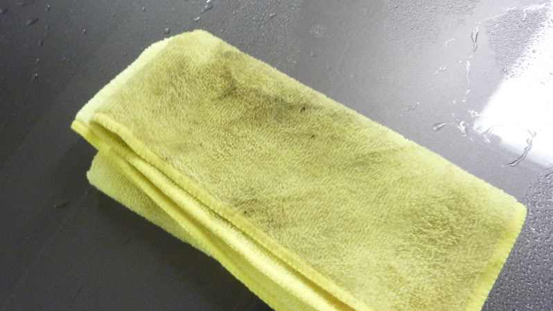

- I then proceeded to deal with the surprisingly high amount of tar, which Autosmart Tardis made very short work of.
Pic of the MF after removing the tar:

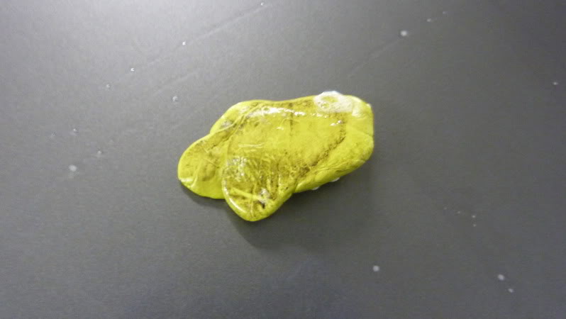

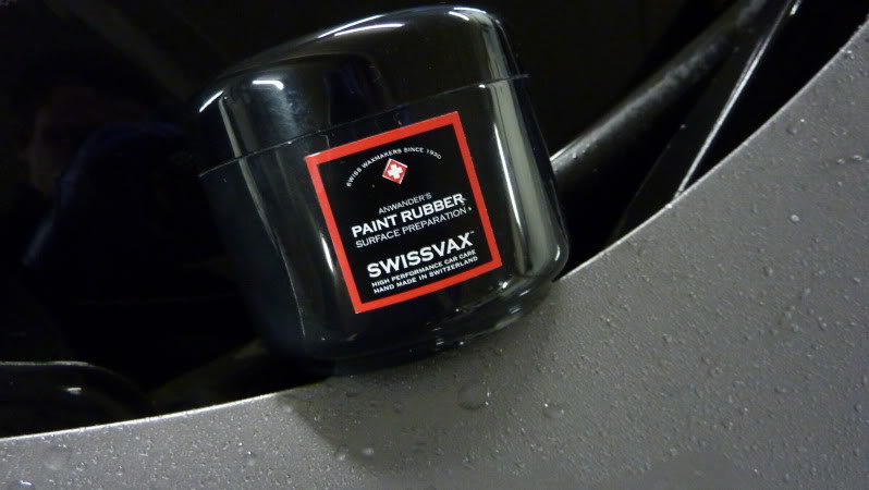

The next step was to decide whether or not to clay the car. As I rubbed my hand over the lower panels, I was shocked to feel just how many bonded contaminents were present - I feared I'd be claying this for a while, which is surprising for a Feb 10 car!
So, out came Dodo Born Slippy and Swissvax Paint Rubber:
Quite a bit on there, but it came straight off!!
(That's after just 1 door!!!!)

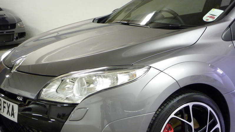

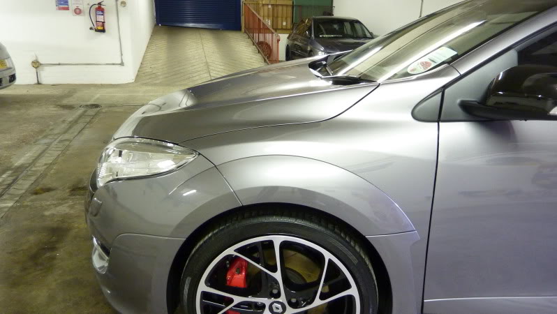

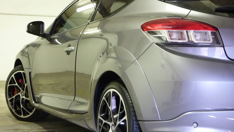

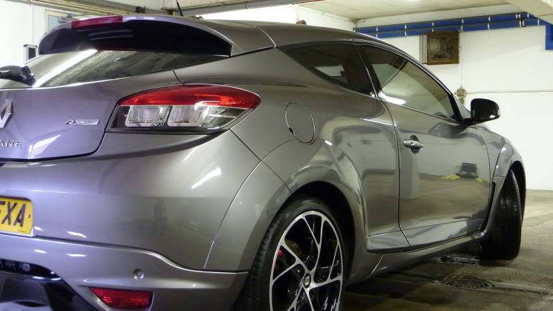

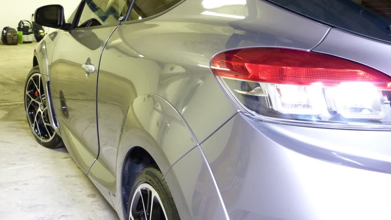

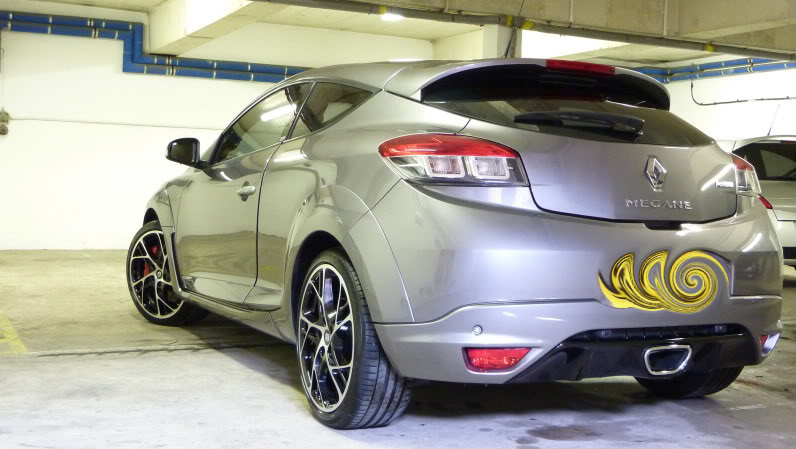

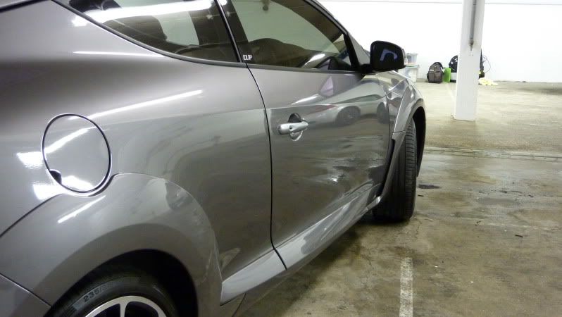

Some afters... it cleared MUCH better in the flesh, I need to really learn how to get the best from this indoor lighting!
I'm on love and now want one...
