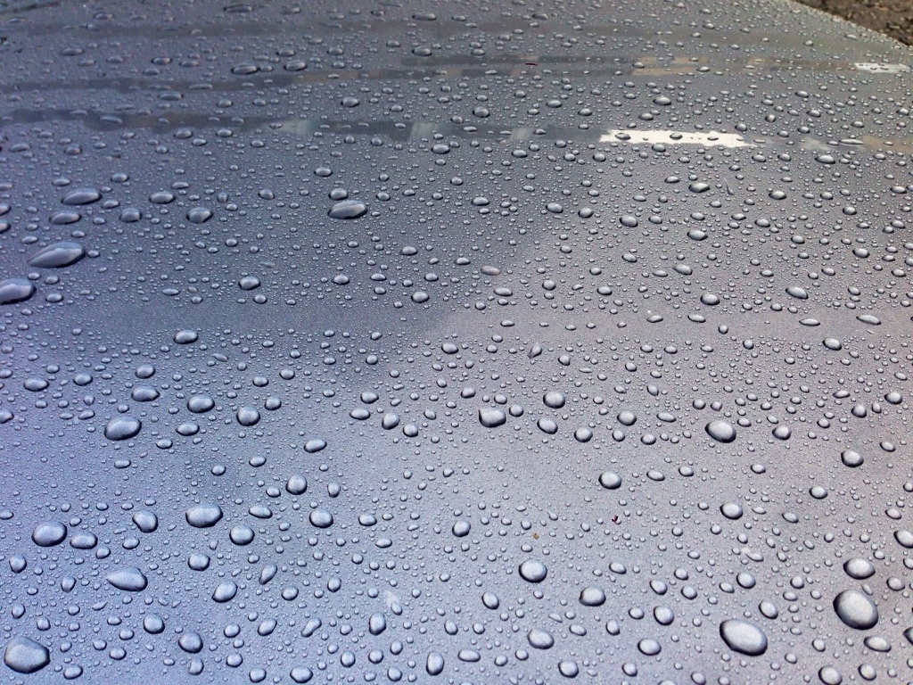

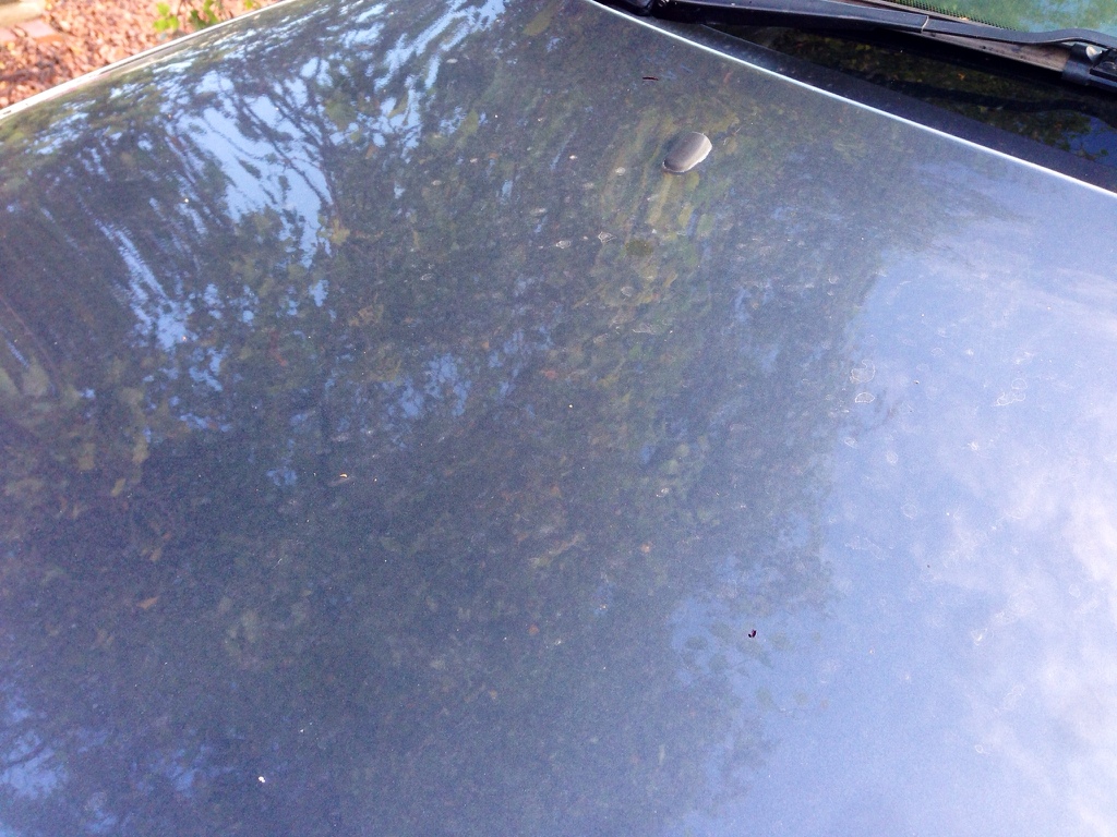

How can you tell if it's clean it's soaking wet! If it's dry tomorrow i'll image the dirt.

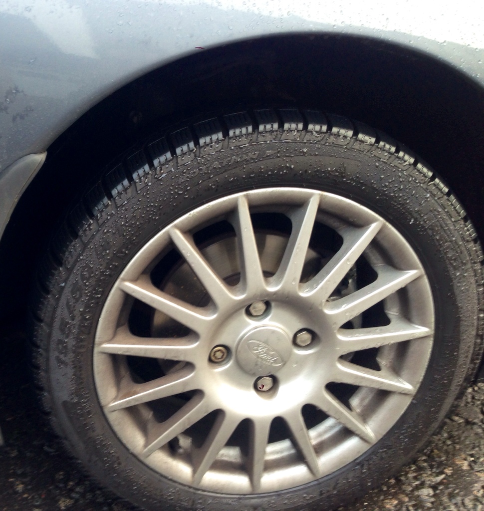

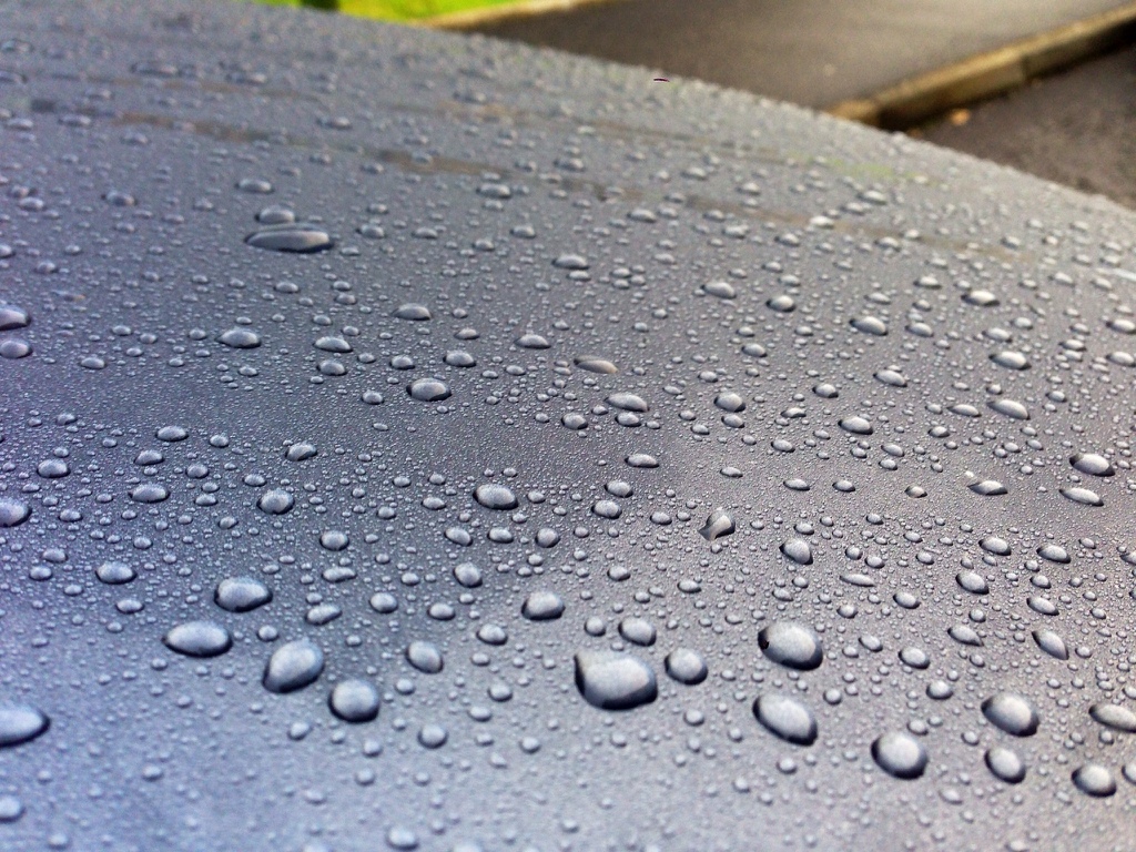

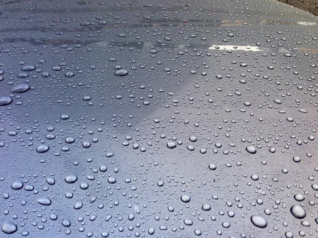

Some more pics...
Let me know if you can see the dirt ingrained on the bonnet...

The rear is minging on mine. I'll grab pics. It's a hack and test bed for products.
Well, considering how much dust/dirt you can see on the bonnet, I'm damn impressed with the beading tbh!
Still need to see how well my CQUK is working after polishing it. If it's ok I'll put reload on a test panel and see how it goes, if I still don't like it I'll just go back to Hydro2 tbh. Still got some left from the Clio.
