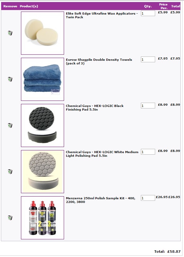

Ideally I want that menz sampler polish pack, suitable pads to apply, those two you're talking about sound find and dandy.. and then a nice wax to top it off (I was going to go old school and go autoglym HD?) Or no wax and zaino z8 instead? Was really impressed with that before.
Oh and a nice hand applicator for said wax?

This little lot plus some AG HD Wax?
Rob have you considered some Vic's wax instead? AG HD wax is ok but it's bloody hard work and not very nice to use.
I haven't considered any wax tbh mate, I've used AG HD before and it seemed nice enough. Researching about these things bores me to death, genuinely, so I'm happy to take peoples experience in here and just buy something.

Applicators I'd suggest a pack of the tri foam or German coloured aplicators. The soft black side is perfect for waxing whereas the yellow or white sides are nice and firm for polishes, cleaners and all in ones like tripple or the menz polishes by hand
http://www.elitecarcare.co.uk/gtechniq-tri-foam-hand-polishing-pad.php

I'm quite a fan of AG HD wax, it's a lot cheaper on eBay than anywhere else so I'll order that separate. Only like £32 delivered!
Thanks for the link to the hand applicator, I'll change mine. As for the spray sealant, I've used zaino z8 iirc a number of times and was really impressed. Any reason you'd recommend what you've put there over it?
I'll order this little lot tomorrow, and a spray sealant, which one depending upon what you say.
Z8 isn't a spray sealant as such, it just has some properties, pick up some C2V3, seems easier for new users to use than reload on some colours. Don't buy a carnauba spray unless you're confident, some can be a pain due to the wax in them.

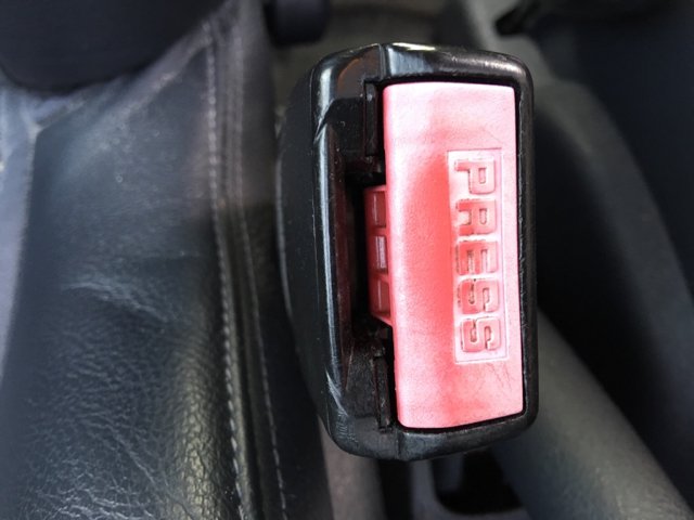

Looking for advice on what I can use to get colour back into these?
Ive looked in to this before too. Didnt find any solutions. I trawled ebay and googled for hours trying to find brand new replacements buttons too.

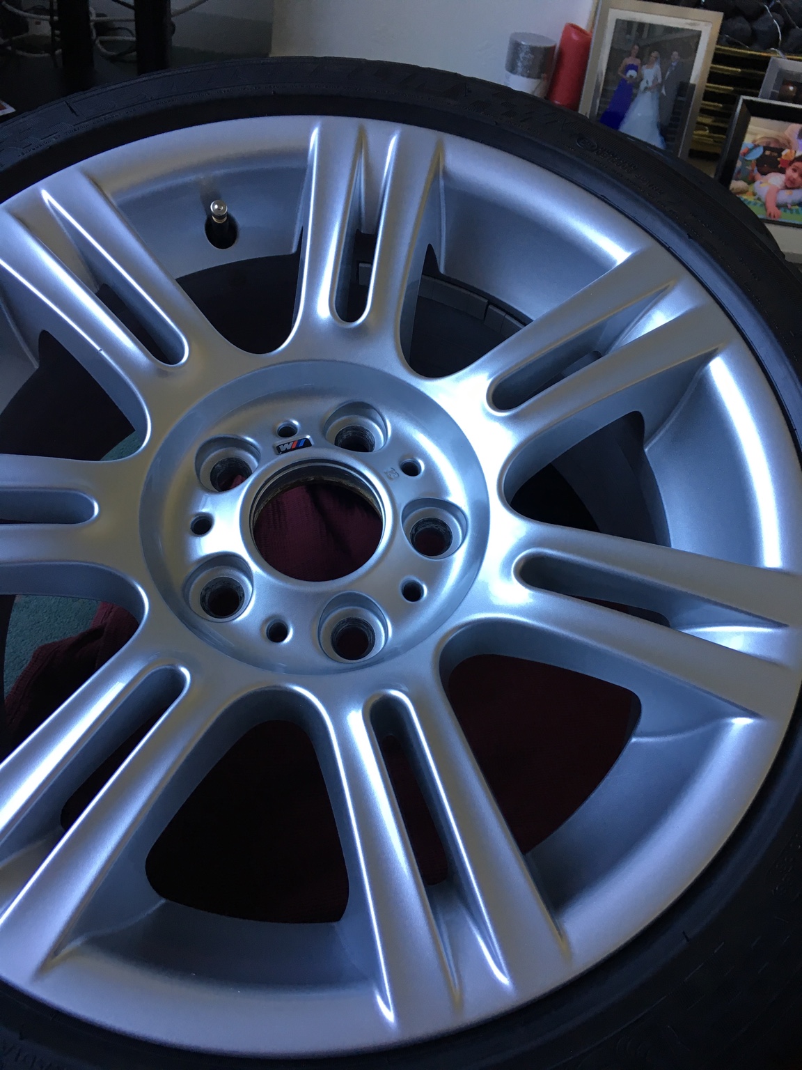

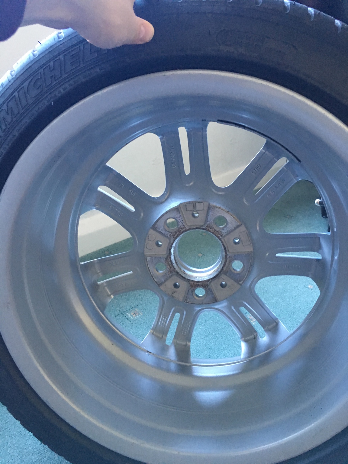

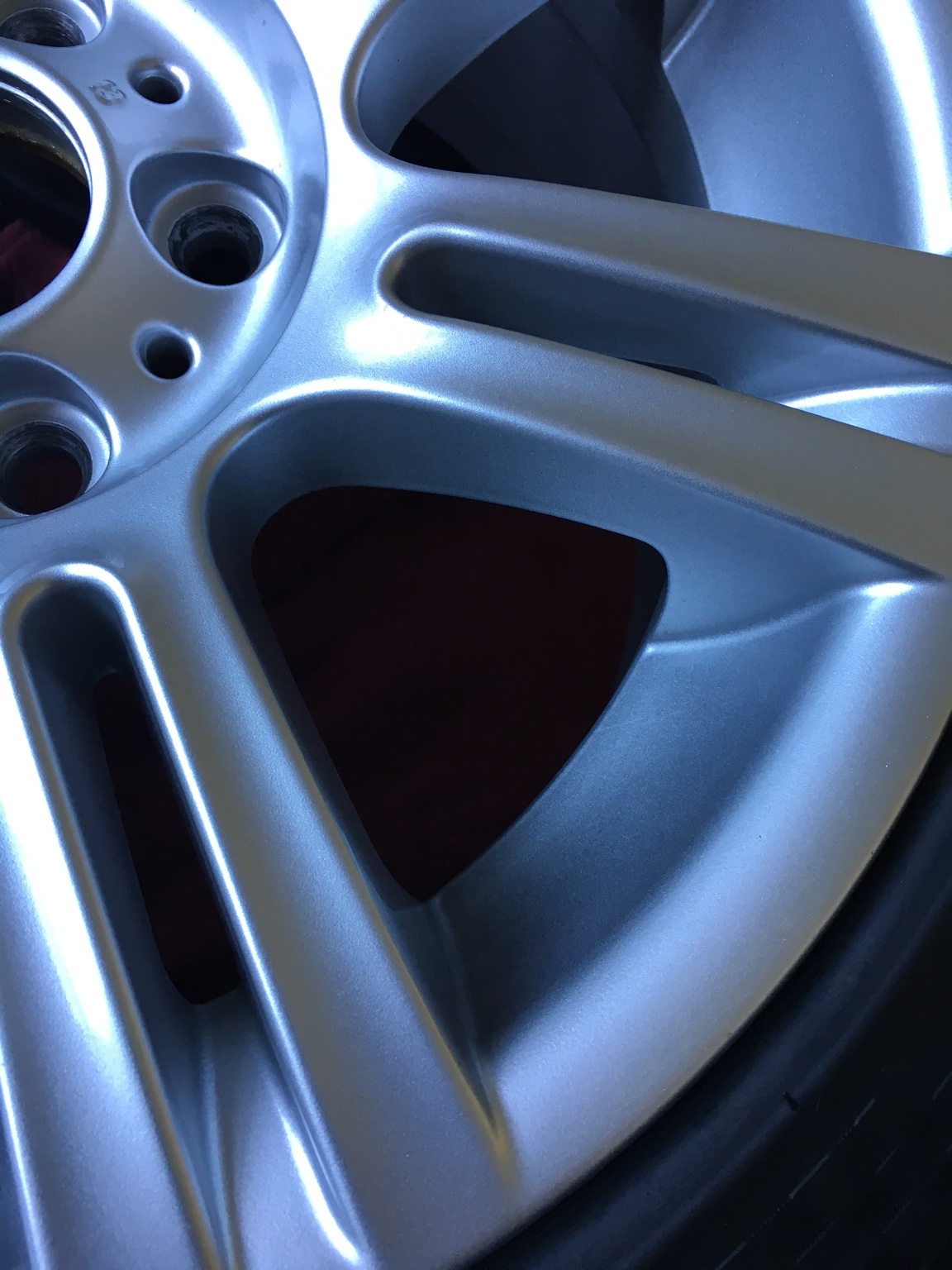

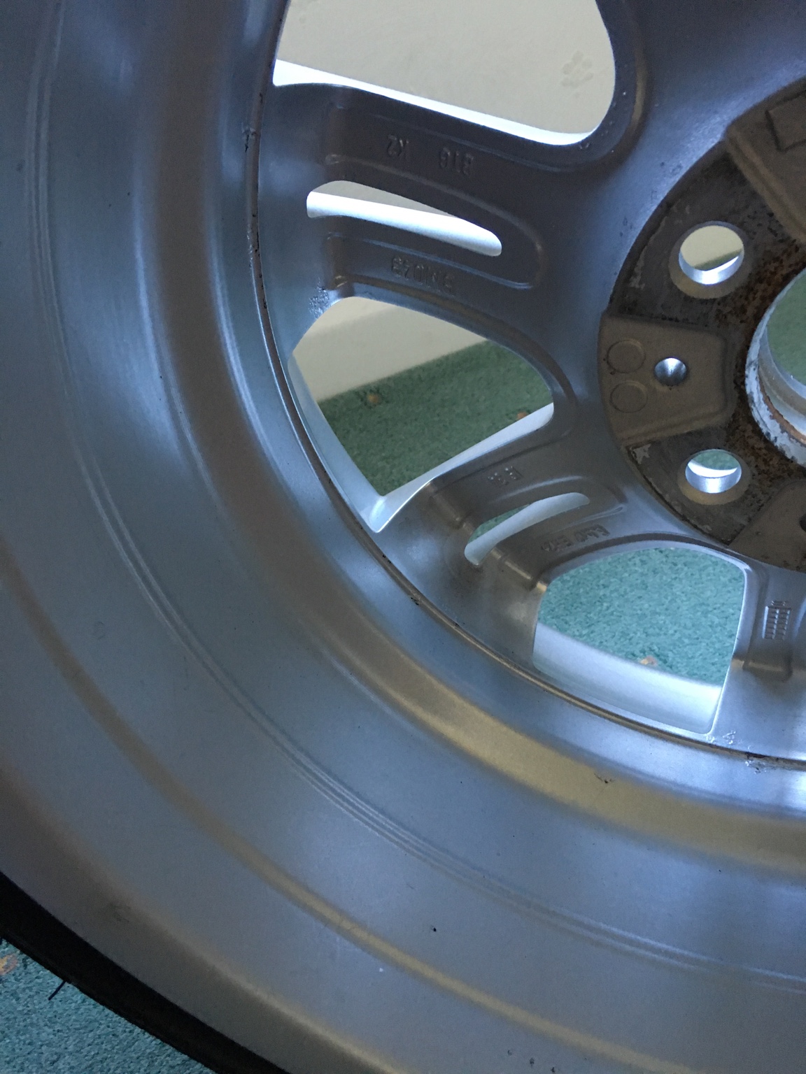

Looking loads better, although really they are ready for a re finish
