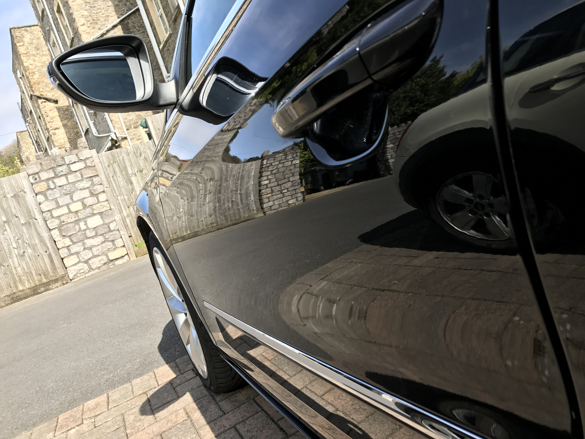

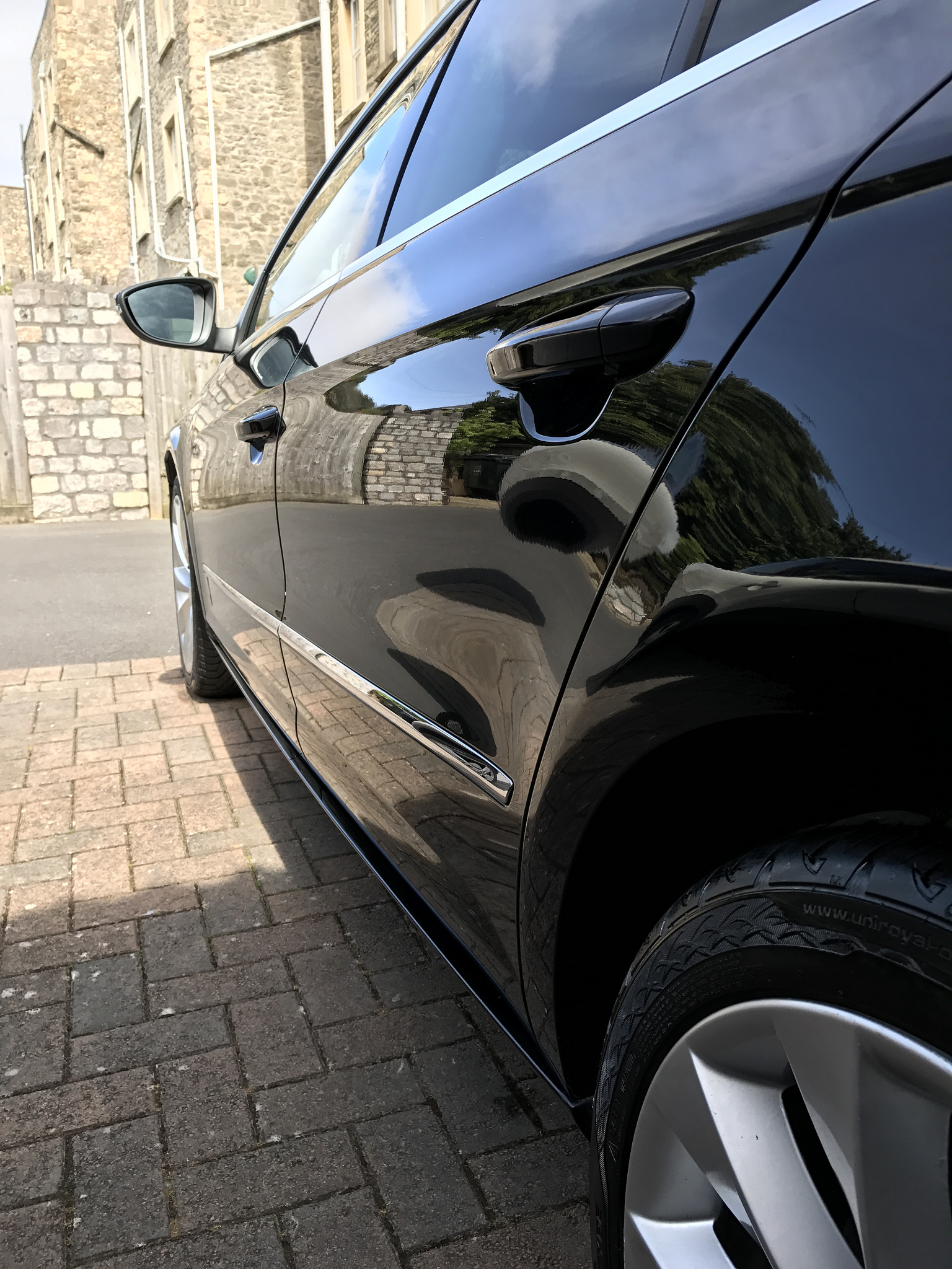

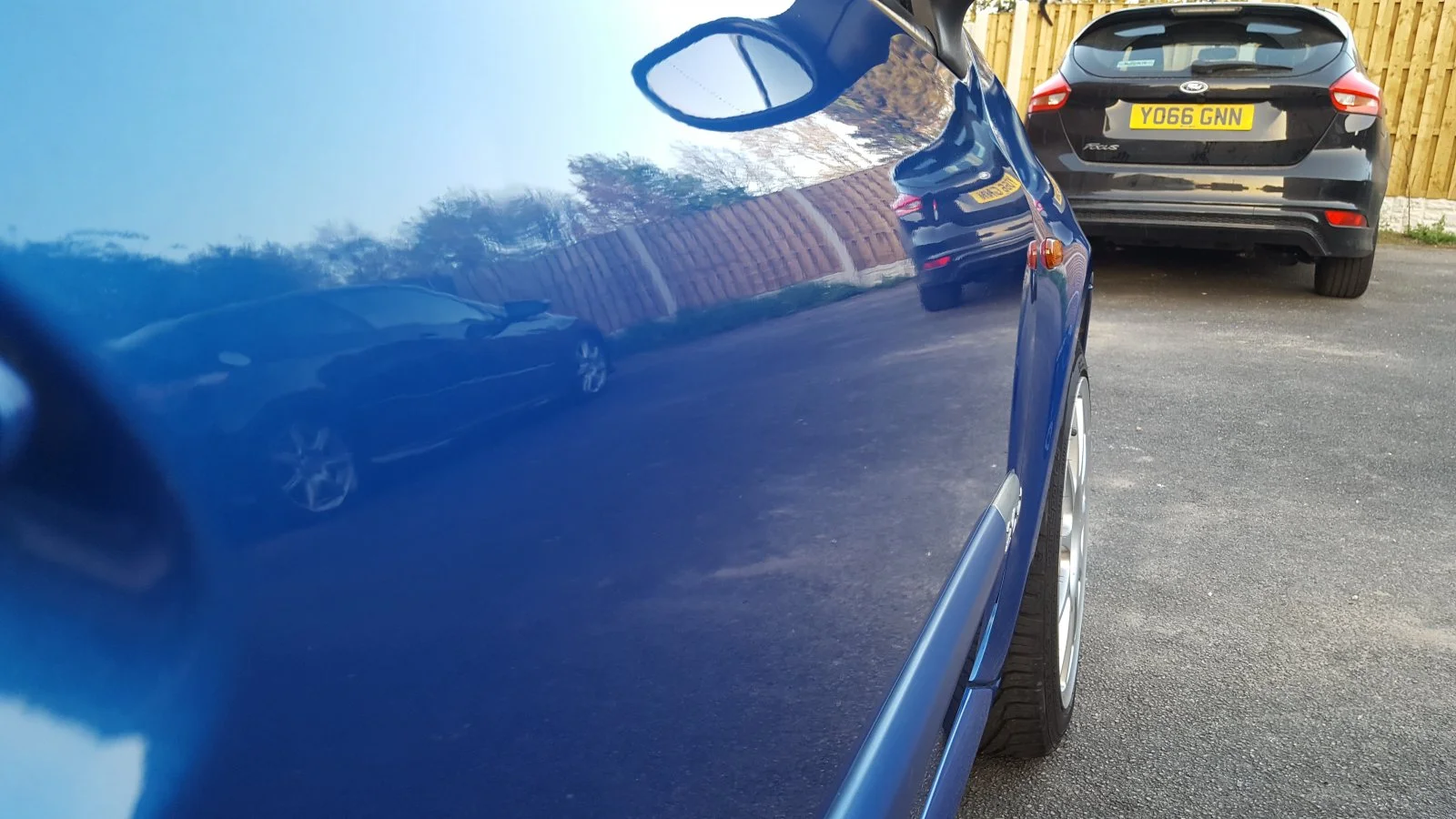

Found I barely had to put any pressure on it before the spot was visible. Still, had a crack with it and it's improved the Cup. Ended up using the official DAS pad (supposed to be ideal for 1 stage polishing) and the 2200 menzerna, then topped with a coat of Bilt Hamber wax.
Have to excuse the plastics, did them after I'd taken the pictures.
It does need something more aggressive on it to get the remaining defects out. The question is should I go for the Menzerna FG400, to compliment what I already have, or Meguiars ultimate compound that I can pick up readily and cheaply from Halfords?

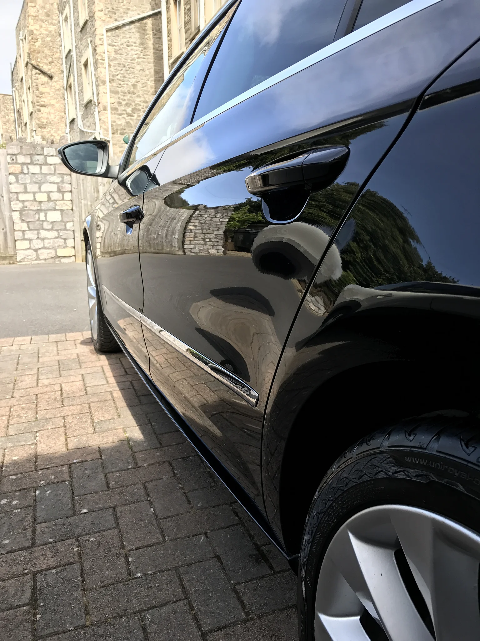

Love Black cars when clean but f**k owning one again.
Gave my Inferno a quick clean yesterday, first clean after I fully sealed it with Collinite 845 a couple of weeks ago, forgotten just how much easier it is to clean a car that's properly sealed!
Super old school wax but an original caranuba wax. Lasts about 30 minutes durability wise but lovely wax.
