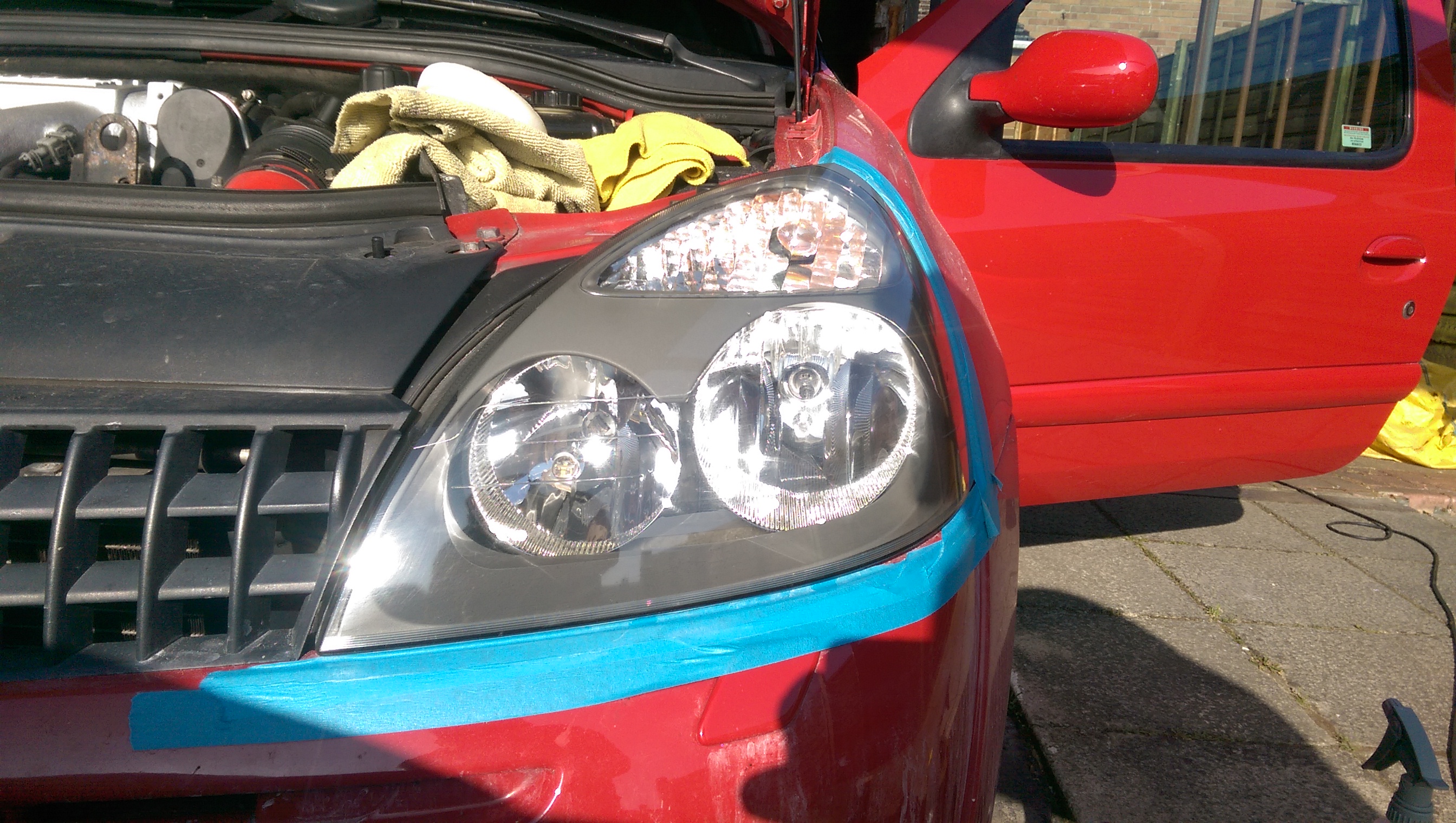

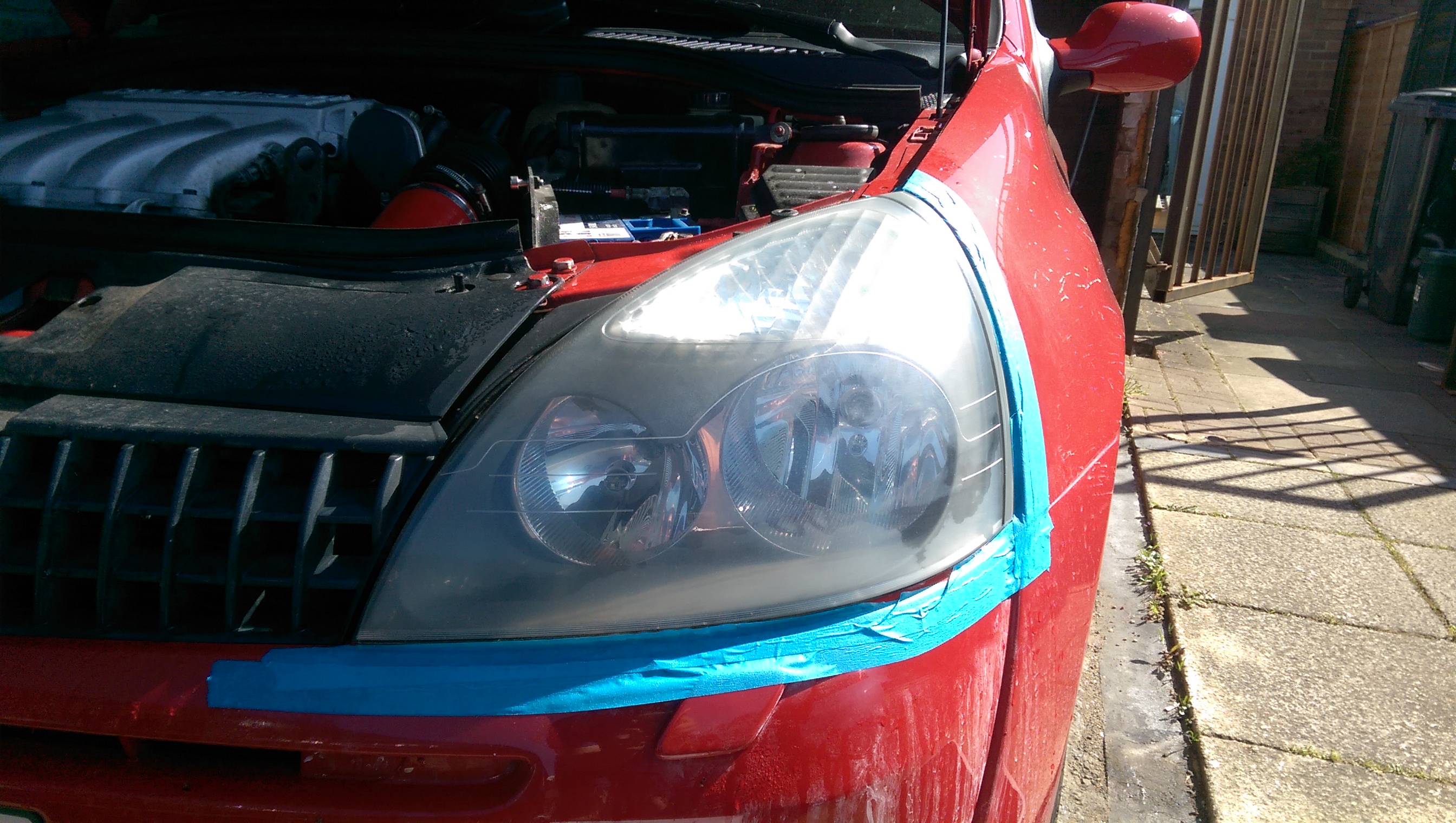

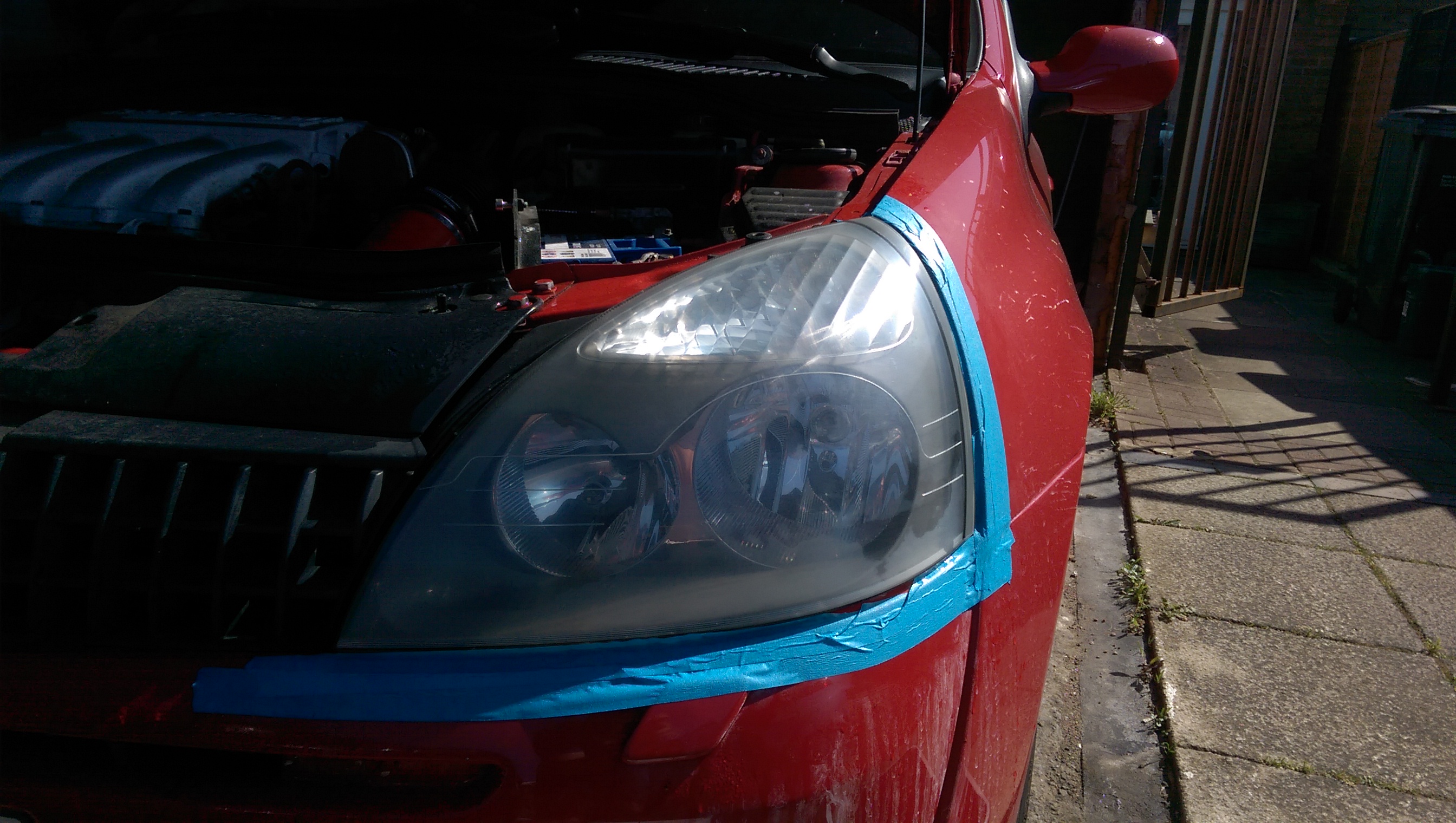

Headlights... worked my way up the grades - 500, 1000, 2000, 3000. Can't decide if they're ready to polish or if they need more sanding as there are some patchy bits still.
Just a pack of Amazon wet sanding discs with velcro on, did it by hand though. Then ultimate compound on the 3m headlight polishing disc as a white hex logic didn't touch it (with da).
