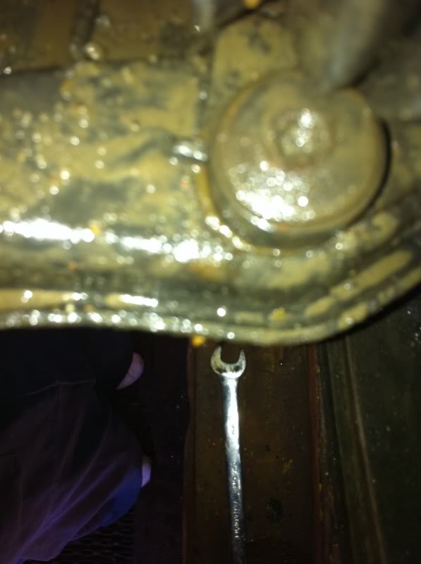

Under the car this weekend an only photo I have but all my other Ph1's have had 4 clamp style bushes, on my current one it has the two clamps in the middle but the end ones on the wishbone go through the ARB?!
Thats what I thought :S
Could you check the plate N11 BUB for me please ;)
Done a check on AskMID and comes up as a Renault Sport.
It was a Cat D, but maybe the subframe was changed too. Are wishbones shorter? Bit concerned as to what else coudl now be different!
get some better pics for me, i think they've bolted on a non sport complete subframe
does it thin out at the ends??
The ARB? The ends are flat with a hole in for the bushes. Differences in Subfram from Sport and Non sport??
subframe is the same dimensions, its missing the hole for the front lower box mount (unless they added it)
that's 100% a non sport setup
If thats all there is different I'm not worried. But that ARB end fixing really isn't man enough!
As long as hubs etc are all Sport ones I can't see a problem TBH
Ive got a non sport sub frame with sport arb's, can get a pic if it helps, , mines a mk2 with mk1 arb
I've got another Ph1 its just not here at the moment to compare to, but thanks anyway!
Fred - I know what you mean it ripped the end clean off of my OS one, so its been nut, bolted and big washers now to keep the b*****d in place!
