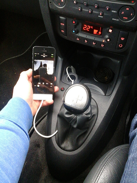

Aux Setup by Simon_89, on Flickr
Got a few things for Xmas to allow me to listen to my iPhone a bit easier in the car, this cable utilises an aux cable and charger into a dock.
I removed the cigarette lighter, covered any exposed metal on it to prevent any possible short circuits. I then fed the cables through the hole, rerouted the original aux cable down behind the head unit and to the area beneath the cup holders. Using a twin female audio connector I simply joined the wires up that attach from the aux cable that plugs into the back of the head unit and the aux cable from the iPhone dock and hey presto an audio solution that charges and plays music whilst not having cables all over the place

I've done a similar thing but got the cable coming through between the cup holder and ash tray... like the ikdea of using the cigi lighter hole though!

I never use the cig lighter for anything other than charging my phone, so if need's be I could use a USB extension cable in place of the additional iPhone cable.
Thinking about putting a grommet over the hole and drilling a suitably sized hole just to prevent the cables from rubbing on the plastic.
