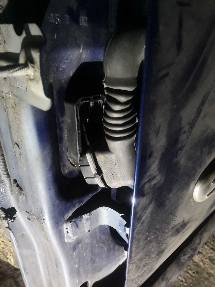

Struggling to disconnect door from wiring loom. Found 2 bolts on the outside that I've removed but still doesn't disconnect? Anyone know?

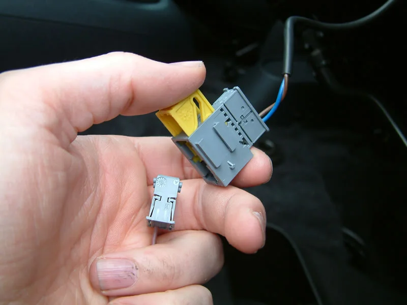

Pretty sure there is a clip at the top of the plug you pull up to release the plug. No bolts. It's a little while since I have done it. Same as the ECU plug.

Will give it another go tommorow. Cheers

Awesome, cheers. Hard to see with everything in the way blocking view

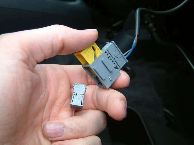

JamesBryan
Similar principle to this.

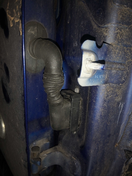

Mbeau
  Clio 172
Is that the door? If so it's the other end you need to disconnect from the Pillar.

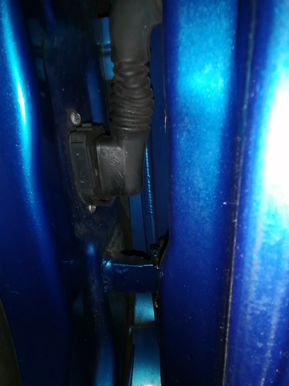

Dex90
  11Megne250/02Clio172
Can't pull rubber off to see it?

Dex90
Doh, the plastic surround pulls off

It's not obvious like every other clip, usually different color the thing you pull or push

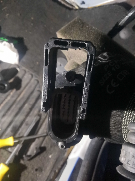

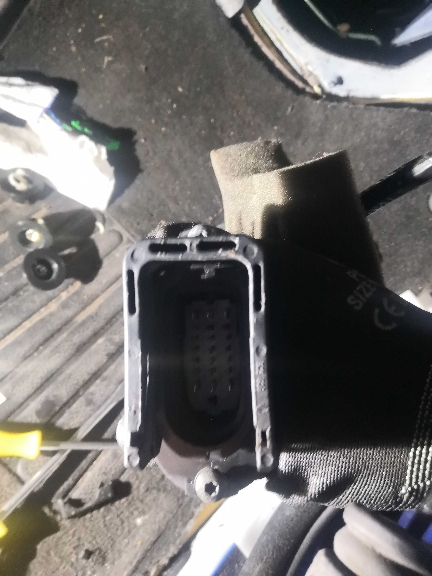

Dex90
Better pic for anyone stuck in the future
