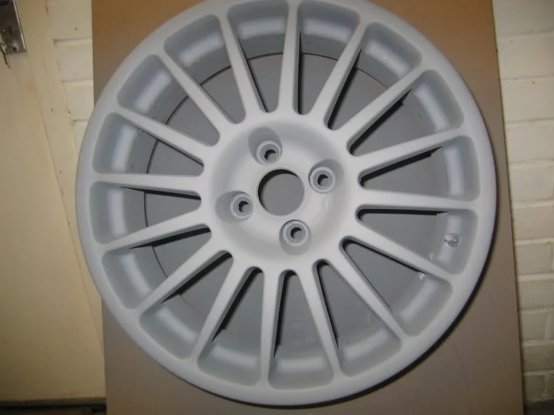

Mate, pay £10 join the club... in the guide section... there is a brilliant DIY refurb guide... I did mine about a year ago mate, they were wrecked... about £50 spent on sprays and sandpaper etc... they were like new!!!

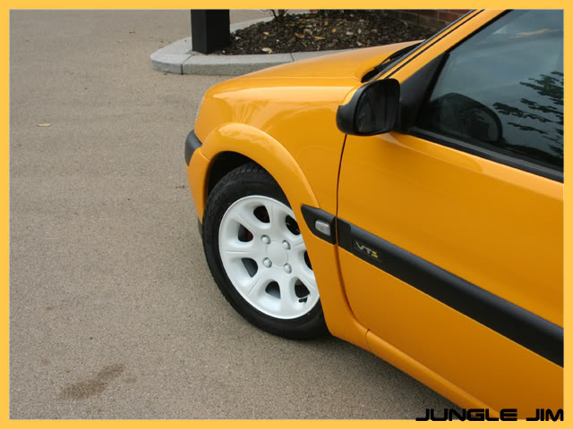

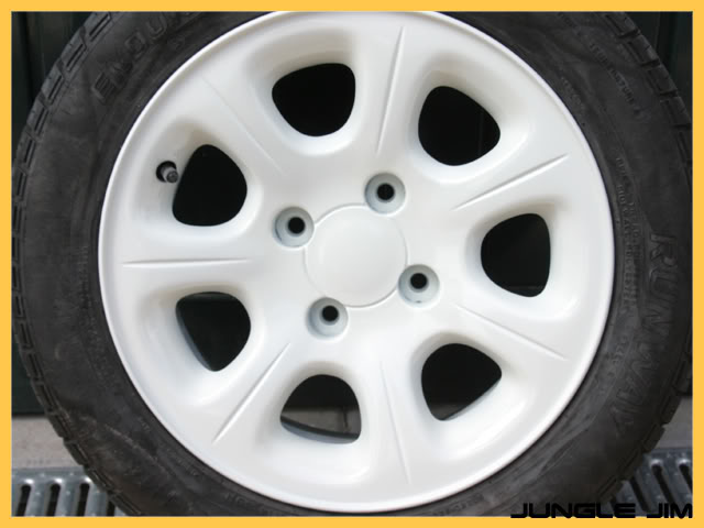

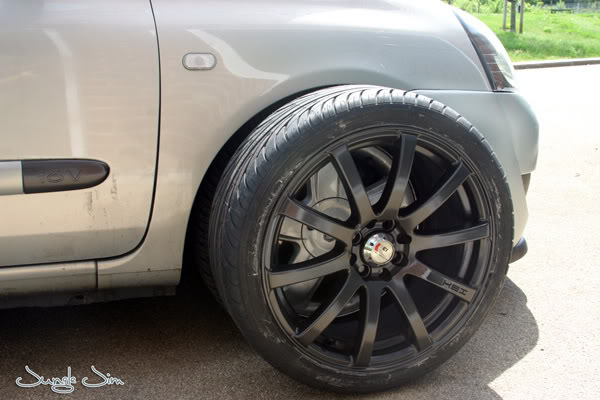

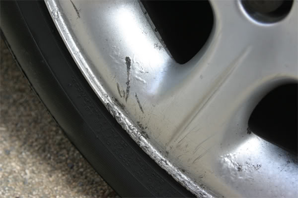

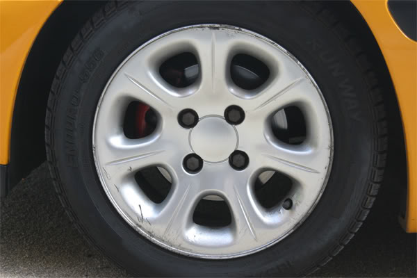

Here are some pictures of when I did mine:
so it is do able and they will not look s**t? ive been meaning to join for ages ill get it done!
Mate, as long as you have patience and sand them down properly and follow the guide you will be fine! mine where better than new, just bought some new center caps as well because my old ones had corroded! Ideally easier if you can get someone to take the tyres off.... because you constantly have to wash them down between sanding etc..
sign up and become a full member and you can see my 'how to guide'

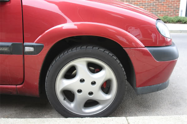

its easy mate, ive done a couple now
these
to this (white stuff on tyres is tyre paste when they fitted new tyres)

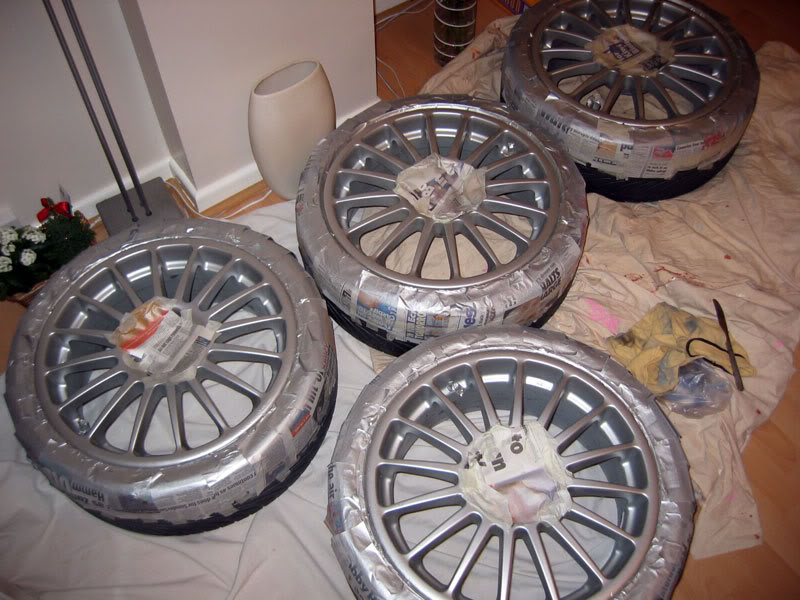

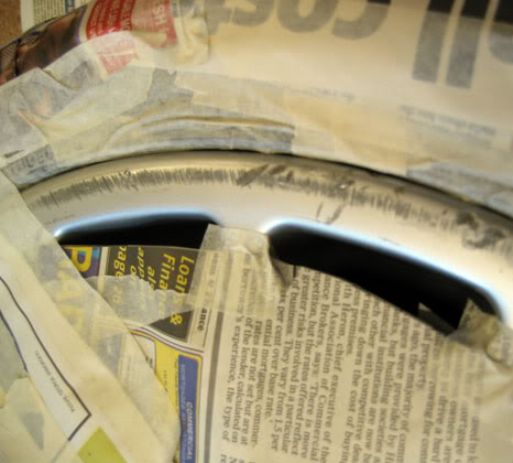

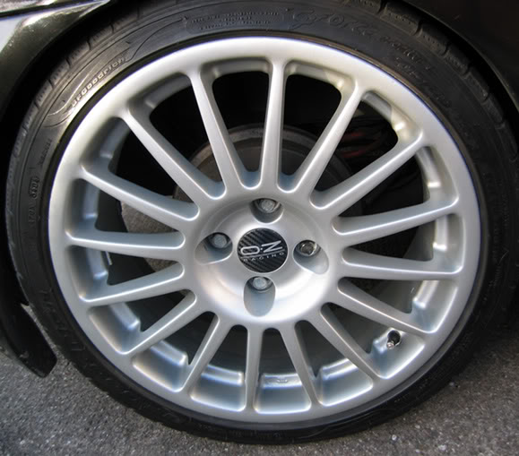

and
these
to
this

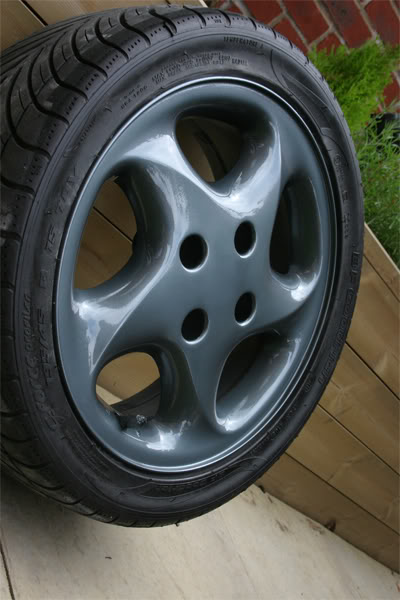

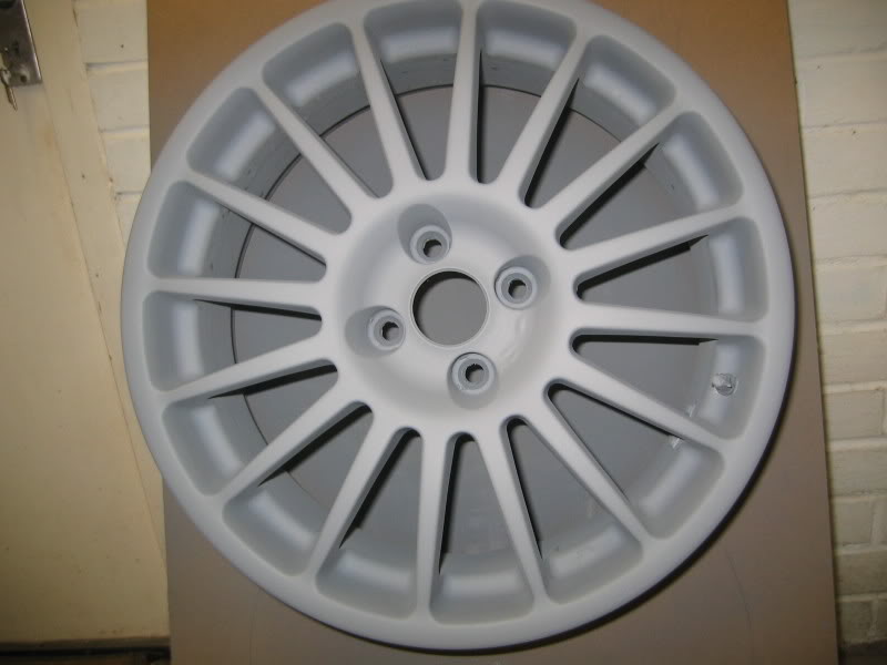

I've sprayed mine, it took loads of effort, patience and good weather (with not having room indoors), to be honest I wouldn't do it again. They need a good clean and polish to look good and do chip easily. Look better than they did tho.

amazing jim top work. ive done the rest of the paint work on my car interior strips and engine bay etc and they came out fine just dident know wether rattle cans would look good on such a big area but seems it will ive got my Dynamique wheels to roll around on so it can take as long as it takes i guess.
Dead easy. Have the tyres taken off, sand them down properly, fill any chips and scratches with bodyfiller, plenty of hi-build primer, lots of rubbing down with wet & dry, lots of thin coats of paint, same for lacquer, then polish up.
Or do them matt black and cut out the lacquering and polishing.
i would use isopon metalik (its a metal compound filler) rather than standard car bodyfiller (p38) it will last longer / join better

i did my own, took me just under 2 days, they came out brillant just took a lot of patience while waiting for suft to dry, they will chip easy but then any wheel wil do if you hit a curb lol
