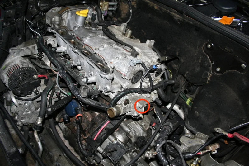

Old thread is old, where is the thermostat on F4R?
Just to the left of the airbox - you'll see a big hose going into the housing. The picture below actually highlights the bleed screw on the thermostat housing...but it'll at least show you what to look out for :)
