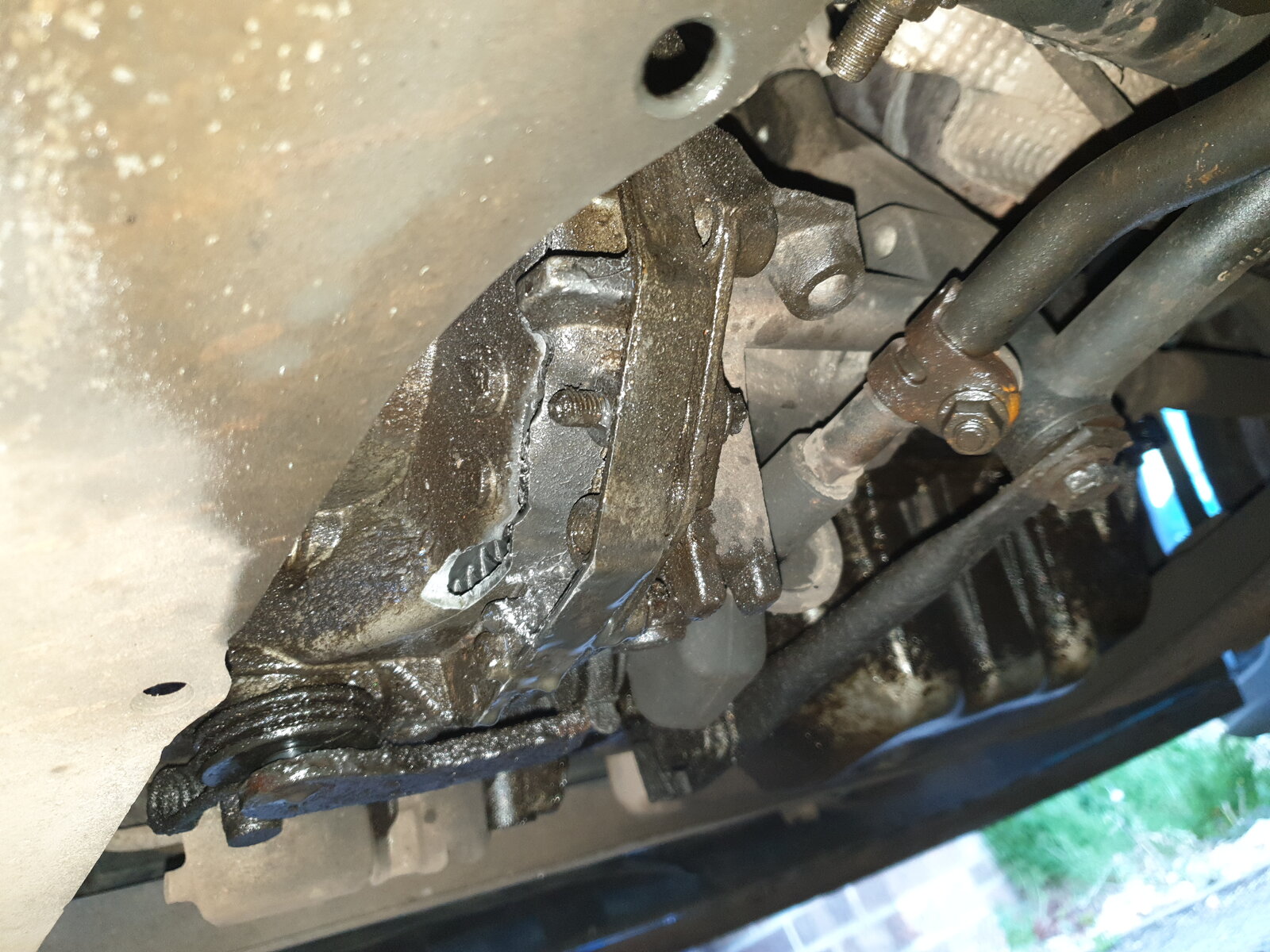

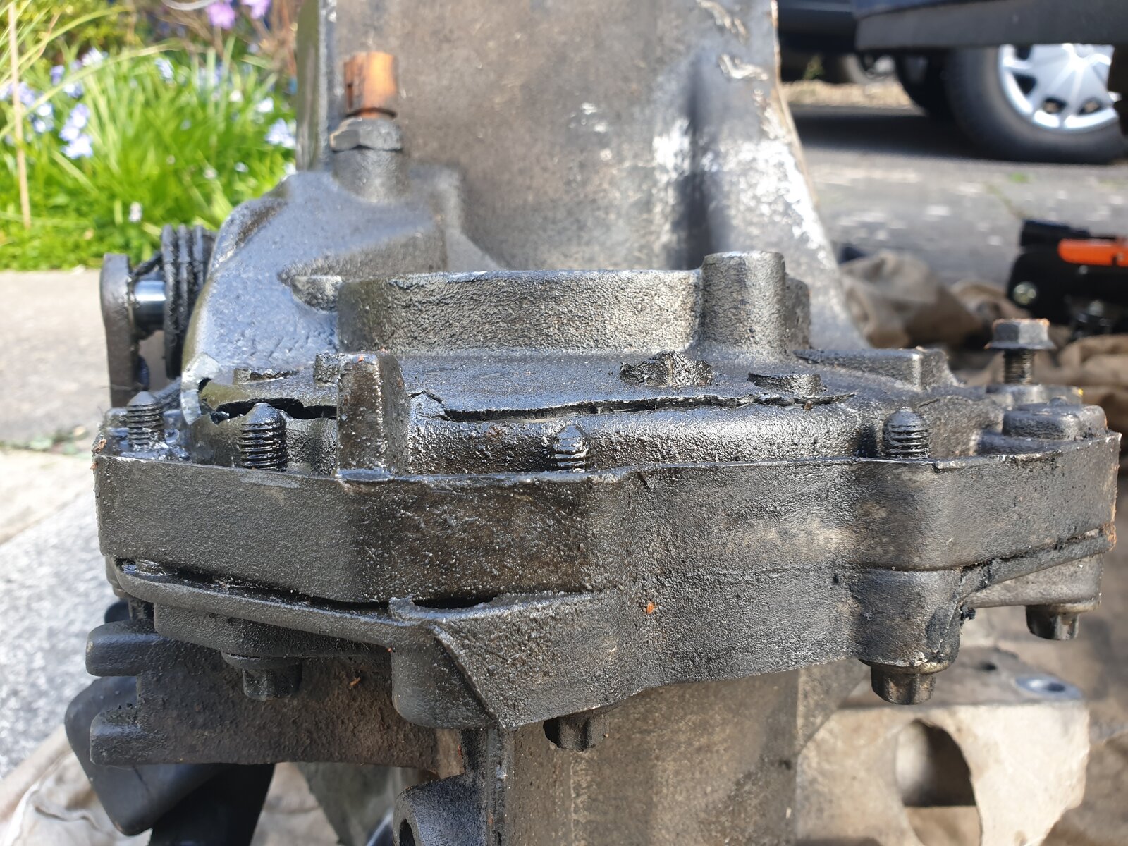

Does this look terminal!
I think it might be 🤣
I noticed a very faint noise appear like a brake pad on the metal from the front of my 172 cup earlier on, I carried on driving for a few mins to see if I could hear where it was coming from. I heard something ping off the exhaust then the noise stopped, then I could smell burning oil.
This is all I need at the moment FFS 😭
That’s the diff crown wheel exposed.. Its FUBAR.... Complete gearbox required....
I've only got sellotape, will that do 🤔
Luckily I was nearly home when it happened, surprisingly it still drives fine and will select all gears so I'm curious as to what part of the box has escaped through that hole.
Might take it off later in the week and get the box apart for a look.
You laugh but I had some sequential gearboxes from 90's peugeot touring cars that had all had their casings repaired with jb weld. Might get you out of a fix as an emergency get you home measure but you can see that fatigue crack go a fair way round that casing. As you are home already it wouldnt be worth any effort when replacements are common.
Seen one patched up with fibreglass and hopes and prayers before :D
Yeah, that's shot, even if you repaired it it'll crack further around, you can see where it's propagating. That and the casing will have shifted when it went under load so the diff bearings won't be true to each other any more anyway.
I wouldn't even attempt it, that casing is fit for the scrap bin only 😉

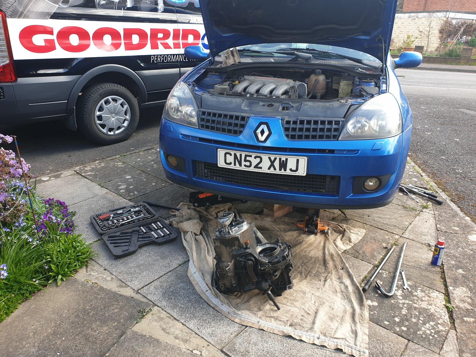

Well it's out now, I would normally have taken it up my mates workshop and used his ramp but with this lockdown had to make do with the driveway and a few trolley jacks ☹
Anyone want to guess what happened before I whip the casing off, something has got wedged somewhere I reckon to push the casing out that much 😱

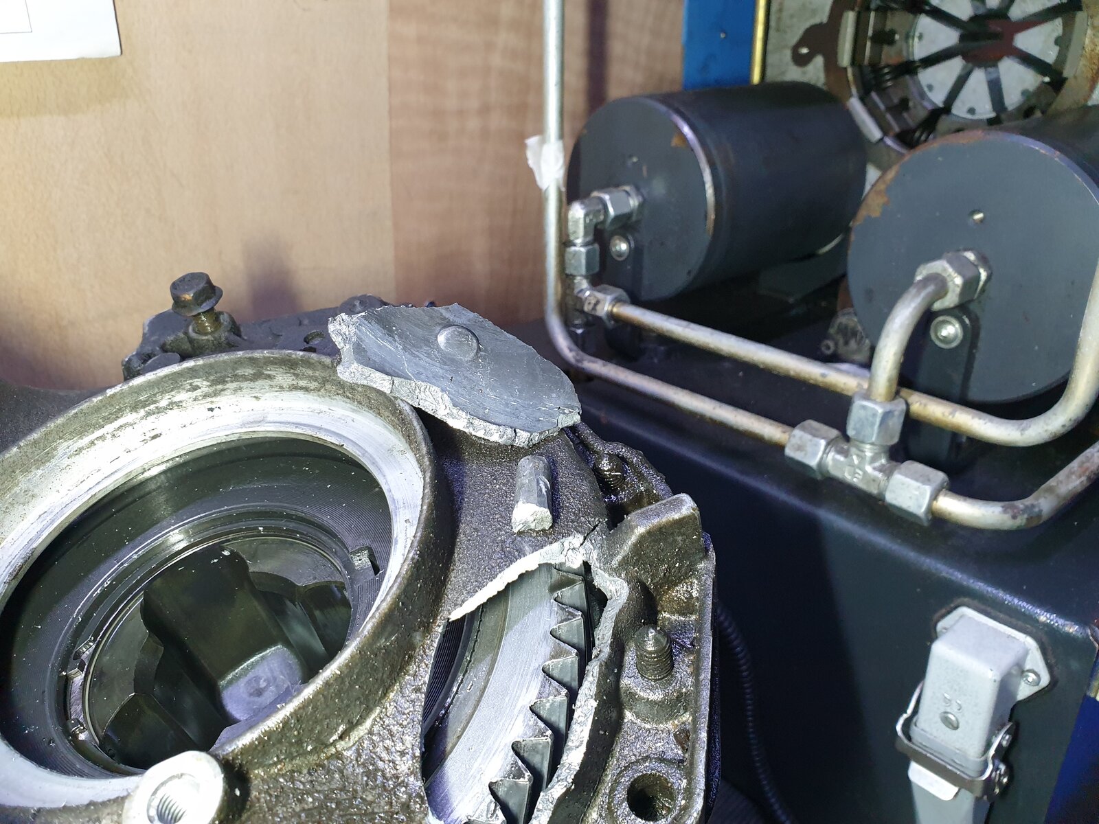

I've only got as far as loosening off the nut and bolt holding 5th gear on so far but I noticed a big lump of metal down near the diff so I made the hole a bit bigger to get it out 😂
It's aluminium so guessing it's from the casing somewhere? It's pretty mangled so I think this is the piece that's got stuck between the diff and the casing but will try and get the rest apart tomorrow.

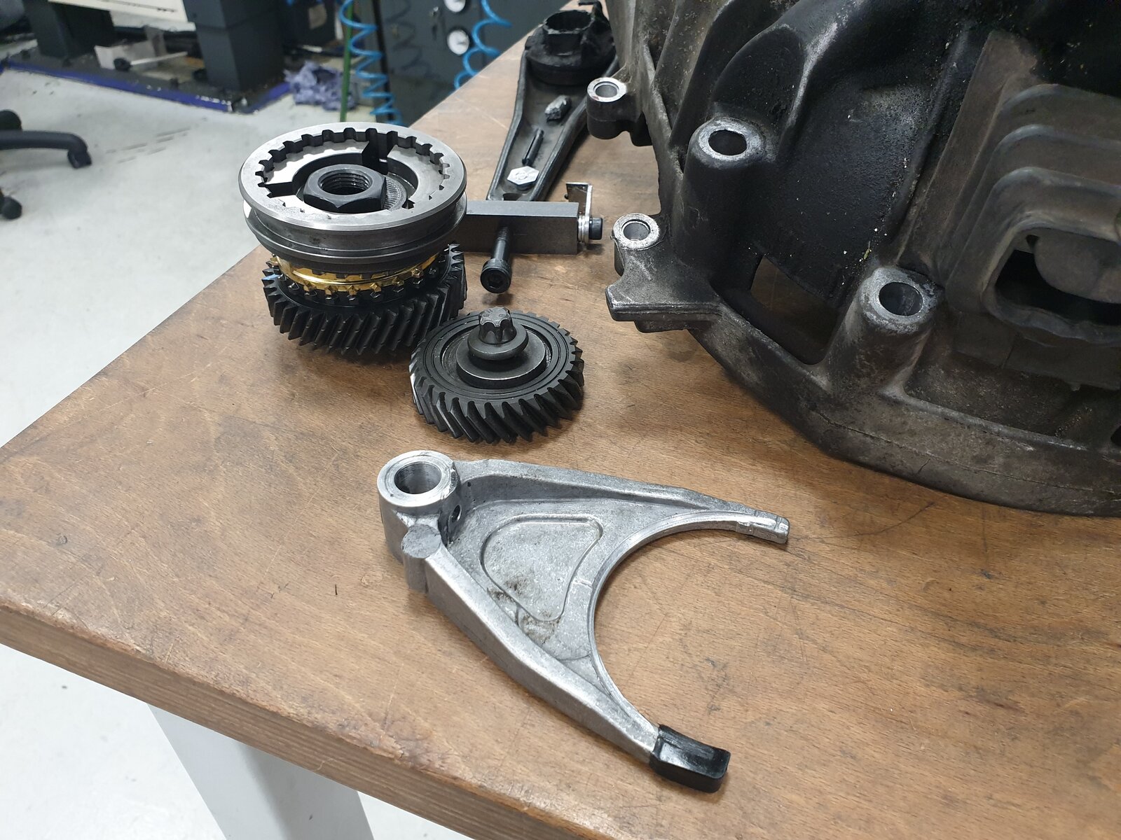

That looks like it’s off the 5th gear selector fork mate. It acts like a locating dowel when it’s in gear, but I’m not sure what would’ve caused that to break off. Other than it’s french and just decided to throw the towel in 😂

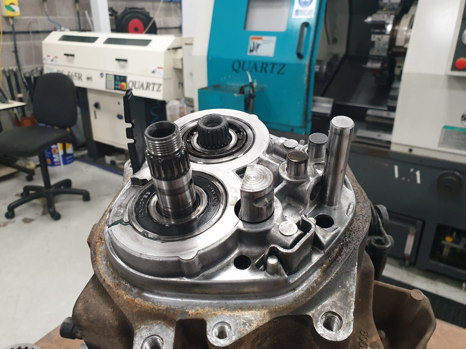

I’m afraid not mate. There’s 2x different bearing setups. Post a picture of the 5th gear end without the gears on and I’ll tell you which box to look for. 👍🏻
Bit of a delay as I had to make a puller for 5th gear. You were spot on about the broken piece being from the 5th gear selector fork, the plastic end is missing off one side of the fork too!
Right the good news is you can extend your search to a 130 box as you only need the upper half of the casing mate. It’s down to the bearing setup. It would be hit and miss as to if you’d get another 129 with that bearing setup, as Renault changed them part way through their build.
That selector fork is about £120 from memory, but you can get them off eBay for about £70/£80. They just look slightly different.
