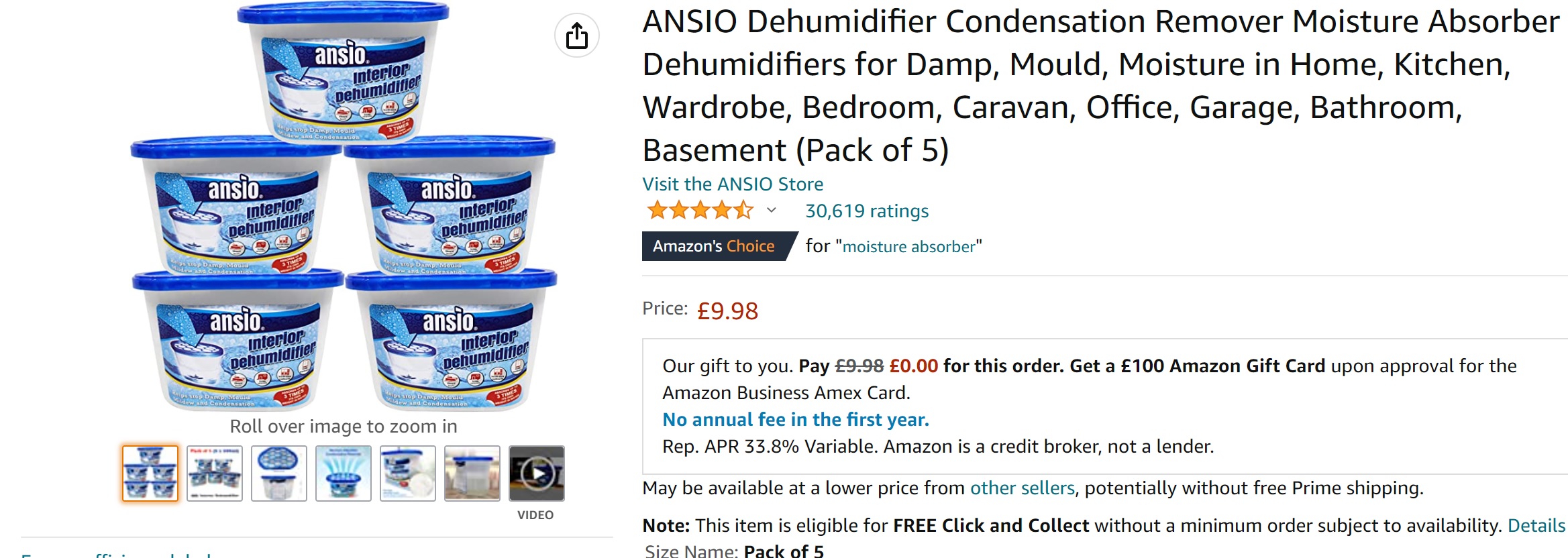

I've found that putting at least one of the moisture traps inside the car and one under the bonnet does wonders.
The first year I garaged my Clio, I had a bit of mold growing on the seat belts and my plugs were compleltely fouled as moisture had worked its way to them. Second year, I popped these on the rear seat and one on the fuel rail guard, plugs were completely dry and the car started first time.
Good shout, won't hurt to try a few of those.
