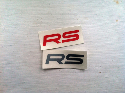

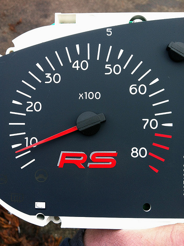

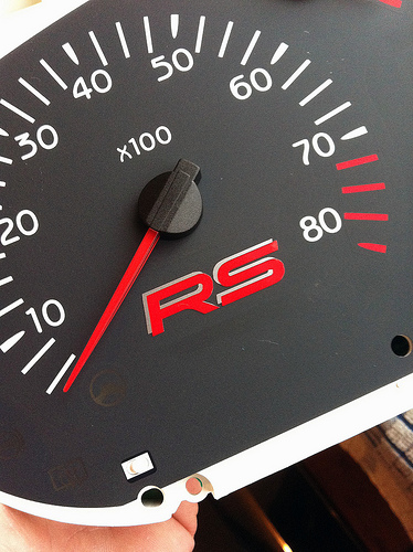

Had these done by Ady from n2grafix on here to put in the rev counter.
IMG_1258 by Dr-Jekyll, on Flickr
I just think it needs a little something but i was unsure on what colour to do them so after a little think i decided to use both.

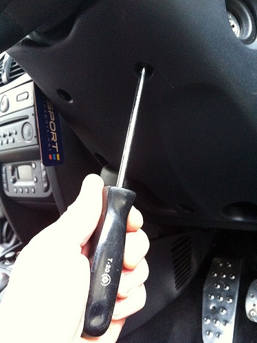

The tools needed to do this are torx bits 10, 20, and 30.
To start off i pulled the door seal rubbers off.
IMG_1316 by Dr-Jekyll, on Flickr
Then take the first screws out wich it t30. There is one either side and are the only t30 screws on this job
IMG_1317 by Dr-Jekyll, on Flickr

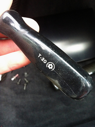

Next grab the t20. This will be used to take all the remaining dash screws out.
IMG_1322 by Dr-Jekyll, on Flickr

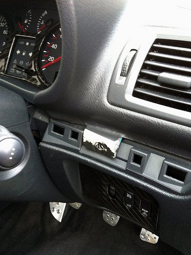

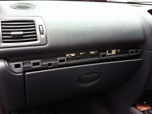

Pull both dash strips off. Only downfall with this is it really does show up the wonky glove compartment :( Undo the 3 screws on the passenger side and 1 on the drivers side.
IMG_1318 by Dr-Jekyll, on Flickr
IMG_1319 by Dr-Jekyll, on Flickr

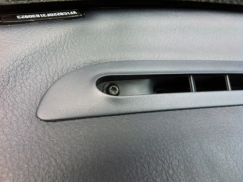

Then take the 3 screws thats in the top vent strip, being careful not to drop them in the vents!
IMG_1324 by Dr-Jekyll, on Flickr

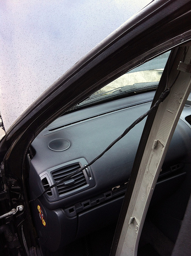

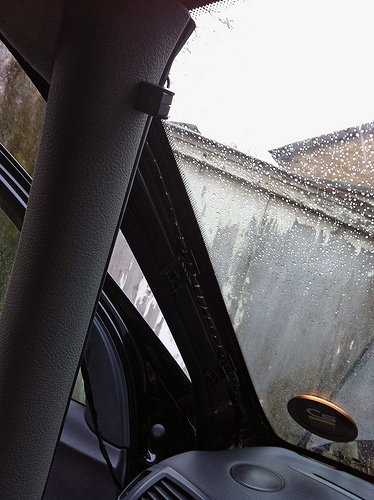

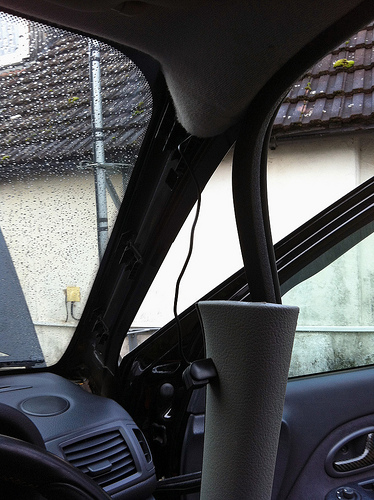

Then pull off the top of the steering shroud and undo the 2 screws that hold the clocks in. I didnt get a pic off this. Then pull off the a-pillar strips. these can be a little tough as i wedged my fingers in between these and the actulal metal so i could get a better pull. Pull the both off and just leave them hanging
IMG_1326 by Dr-Jekyll, on Flickr
IMG_1327 by Dr-Jekyll, on Flickr
IMG_1328 by Dr-Jekyll, on Flickr
Your dash is ready to be pulled off so get a good grip and pull, and dont be scared. I find its best to sit in the center of the car to get the best pull on the dash. Once its off just put it somewhere safe.

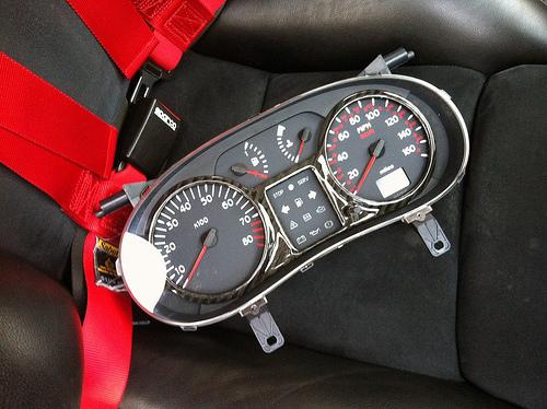

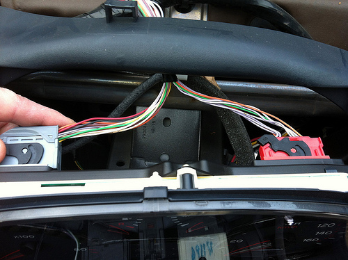

Next you need to undo the 2 clips at the rear of the clock. These have a little clip on the back on them securing them into the clock, which needs to be lifted and pulled to the opposite side to undo. Once this is done, then the clocks are free :)
IMG_1329 by Dr-Jekyll, on Flickr
IMG_1330 by Dr-Jekyll, on Flickr

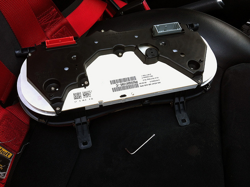

Turn the clock over and use the t10 to undo the 8 small screws on the back. Once they are all undone then front can be pulled off.
IMG_1332 by Dr-Jekyll, on Flickr

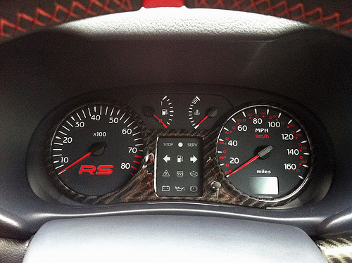

I couldnt decide wether to go red or silver with stickers so i went both
IMG_1334 by Dr-Jekyll, on Flickr
IMG_1335 by Dr-Jekyll, on Flickr
And fitted
IMG_1336 by Dr-Jekyll, on Flickr
Still a bit unsure on it but i'll keep it in for the time being. I might keep that design but go a tad smaller. This is currently 40mm wide.

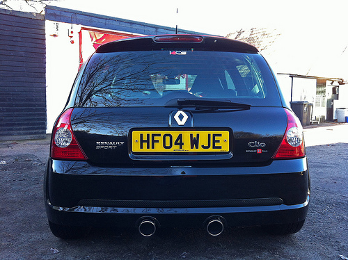

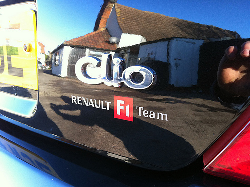

Also decided to use my other f1 sticker on the rear (sorry dom) I really like it and think its suites the rear
IMG_1345 by Dr-Jekyll, on Flickr

I can do 40mm lol :) they are a tad large lol, i like the decal on the back, subtle :)
I thought these were 40mm although I didn't measure. I do like the design, so I think it's the size I'm unsure on. Can you do them like I currently have them or would they gave to be 2 septet are sticker?
I agree with the boot sicker. Subtle yet effective. Really like them, thanks Ady :)
