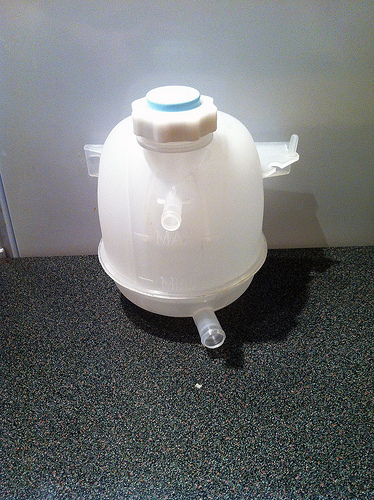

I decided to buy this, this morning :) Will really tidy up the bay. Once it arrives I shall look into a coolant change.

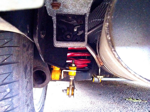

I have also ordered a new universal powerflex exhaust mount as mine is shot:
Knackered exhaust mount by Dr-Jekyll, on Flickr
This is is the one I've ordered:
http://www.ebay.co.uk/itm/161053133767?ssPageName=STRK:MEWNX:IT&_trksid=p3984.m1497.l2649
Make sure you trim the powerflex mount down so its a snug fit, dont just force it in as it is. It will go in as it comes but it wont last long!

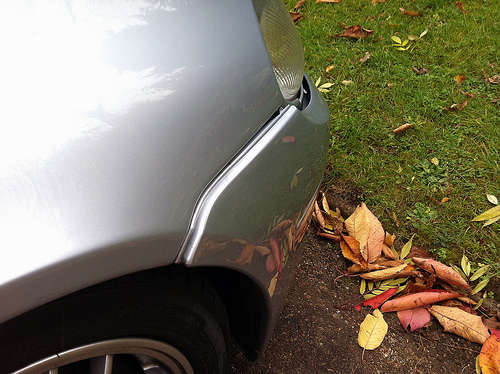

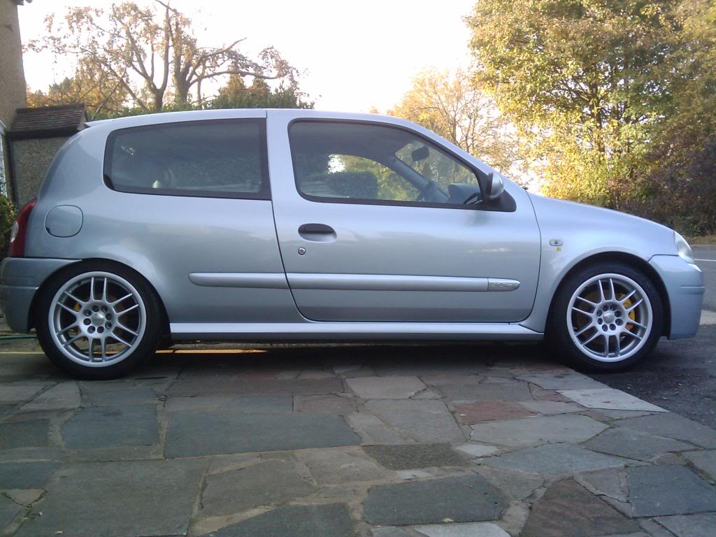

Looks smart Jon. I was unsure on the Ph2 sidestrips at first but seeing them in the flesh has changed my opinion.
Are those 16's? They look big for some reason? Spacers?

I see the exhaust was sitting a little low when I parked it up but have seen some stealth exhausts that are like that. So I had a look and there it was. Not a problem though.

I fitted a pattern mount last month its already knackered. Never thought about a powerflex one so im stealing that idea :) on my old Ph2 i found a bulky ford rubber in a parts bin and bonded that in did the trick fine.
There is a thread on it and that's where I got the idea from. I tigersealed my old ones but this seems a better idea. Worth a try for under £7.
Yea 16 inch f1s with spacers. Thought I would have seen it pop up on here by now it's been like 4-5 years since I sold

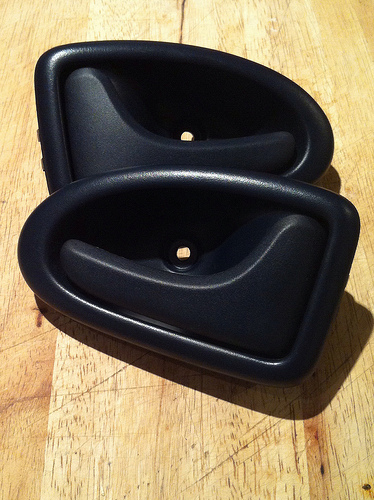

A few bits turned up over the weekend:
Ph1 interior door handles by Dr-Jekyll, on Flickr

What spacers and suspension were you on?
I was running non hubcentric 8mm spacers on the front just cheap universal ones that my mate had lying around and gave to me, only had them on the fronts nothing on the rears. i used to get slated for this but i ran apex lowering springs. Eibach didnt look low enough for my liking and as i was young i didnt want to drop 600-800 quid on coilovers. They where a bit crashy but nothing to bad atall, i never tracked it but it held the road really well. Kind of the usual sheep thing i think with the whole apex hate, one person had them slated them then everyone slates them yet i recon 99% of people who slated never actaully used em! The usual cs really!

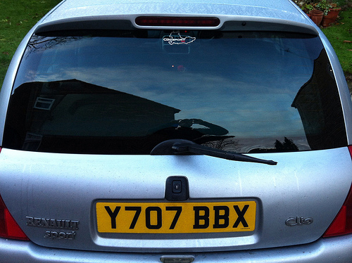

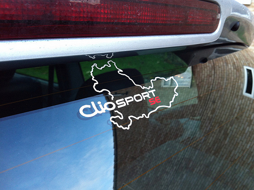

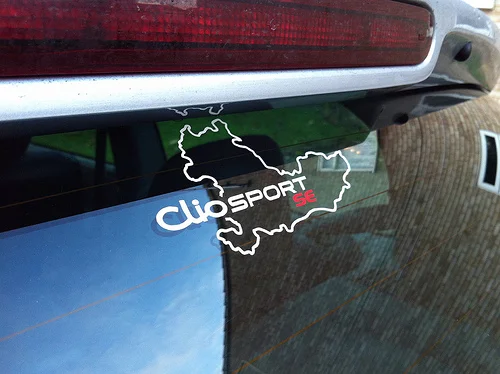

Added the stickers and my Lego Dr Jekyll today too:
Cliosport SE rear sticker by Dr-Jekyll, on Flickr
Cliosport rear SE sticker by Dr-Jekyll, on Flickr
Cliosport windscreen sticker by Dr-Jekyll, on Flickr
Cliopsport URL windscreen sticker by Dr-Jekyll, on Flickr

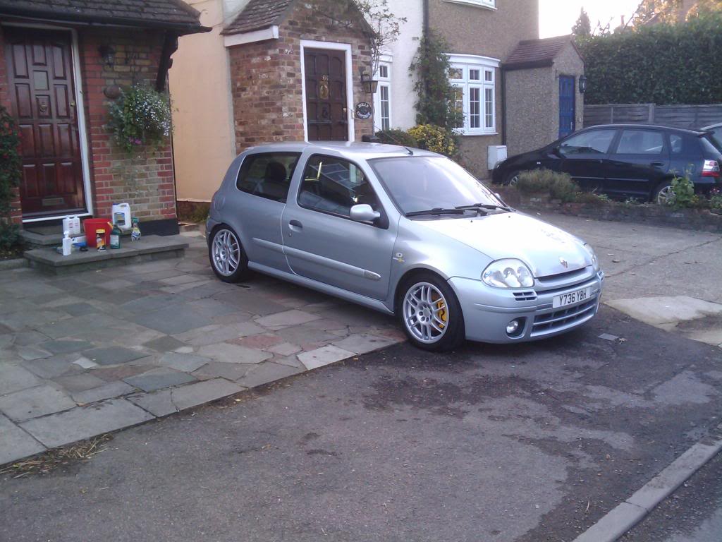

Did a few jobs today. Unfortunately i feel like crap and being in the cold didn't help but some jobs done are better than no jobs done.
Dirty parked ph1 by Dr-Jekyll, on Flickr

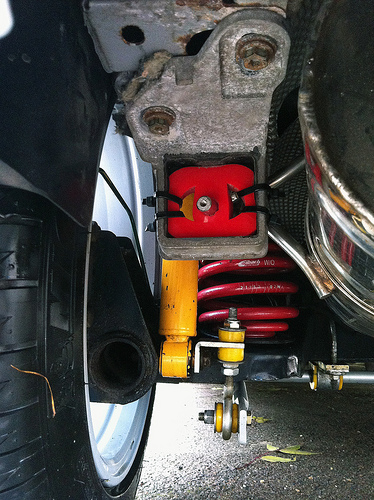

I then decided to fit my new powerflex exhaust mount. I jacked up the rear to get better access and cut the old center out of the mount and cut the edges of the new one as they are slightly larger, then drilled the hole for the bracket and fitted:
New powerflex exhaust mount fitted by Dr-Jekyll, on Flickr

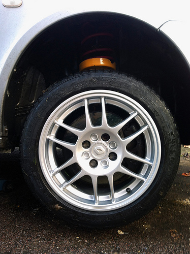

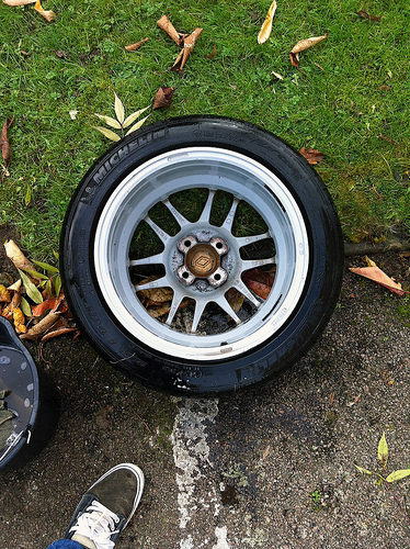

While it was jacked up i decided to remove the wheels to clean them up and also cleaned the shocks, springs and whiteline ARB.
Sportlines and Koni's by Dr-Jekyll, on Flickr

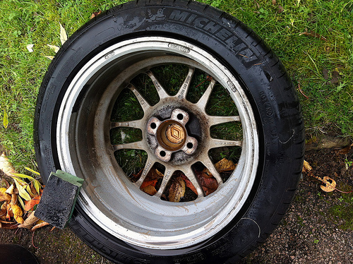

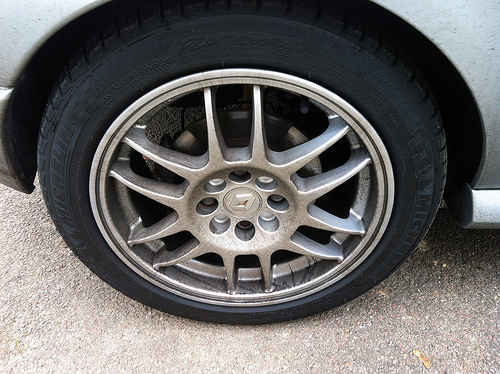

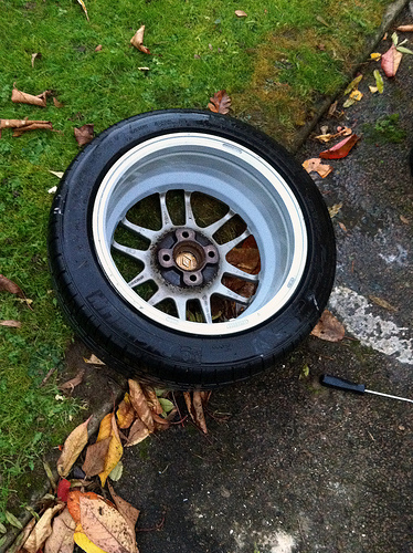

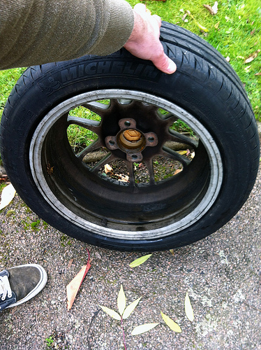

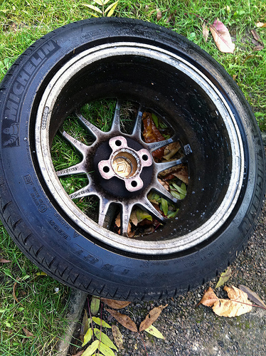

The wheels needed a good clean up tbh. Im not sure when they was last cleaned before i bought it but ive never cleaned them since i bought the car, which was nearly 700 mile ago :eek: I used Wonder Wheels and a washing up sponge, soft on the outside and the scourer (non scratch ;)) side on the inside.
A few before's:
Dirty F1's by Dr-Jekyll, on Flickr
50-50 wheel by Dr-Jekyll, on Flickr
Dirty wheel by Dr-Jekyll, on Flickr
A few after's:
Clean F1 by Dr-Jekyll, on Flickr
Cleaned F1 by Dr-Jekyll, on Flickr

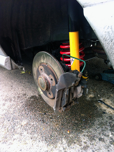

When removing the NSF wheel i noticed a CV grease spillage :( Having a look and it turned to be the clip that holds the CV boot on had snapped and the boot had just slipped off. Luckily i had some spare cable ties from doing my exhaust mount so i used them as a clip. Worked a treat. Ive been out since with no more visible grease :) Easier to tell with my cleaned wheels lol.
Before:
Before F1 with added CV grease by Dr-Jekyll, on Flickr
After:
Cleaned F1 without CV grease by Dr-Jekyll, on Flickr
There not perfect but a darn site better than they was. Tbh it was too cold and the Wonder Wheels was stinging the cuts on my hands!
New coolant bottle arrived this week so i took it to the garage near me and had them fit it with a full coolant flush and new coolant.
New coolant bottle by Dr-Jekyll, on Flickr
On my drive out tonight i noticed the temp gauge only reaches to this point even though i was driving for 1/2 drive to Tesco and back. Possibly a knackered thermostat?
