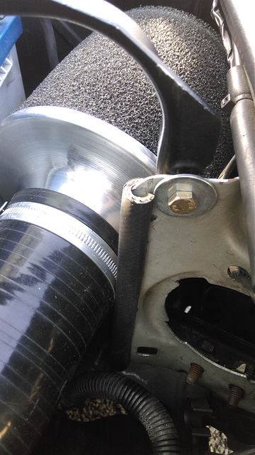

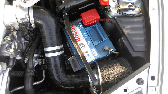

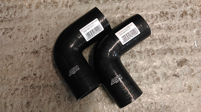

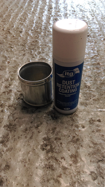

Noise ingredients came:
And all fitted up
And i love it! :up:
Thanks guys. I wanted it looking subtle so opted for the black hoses, plus i dont have any other big colours apart from black and silver on the car. I bought the ash pipes but didnt want the brand showing so i twisted it so it was plain black and kinda OEM looking.

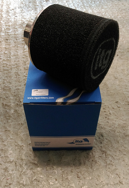

The biggest cost is the filter. This one cost £40ish but you can get cheaper like the RamAir ones for £25. I contemplated the Pipercross C0171 filter (The ones that bolt onto the RS2 manifold) but opted for this one as i like the ITG brand and it looked like the ktec filter. Looking back now having had the Pipercross, don't waste your money. It sounds quiet and crap. Use this filter or the RamAir I currently have on my RB.
Breakdown of the kit at the time of purchase. Prices I believe have gone up. Slightly for the hoses.
Breather filter: http://www.ebay.co.uk/itm/300685158785?_trksid=p2057872.m2749.l2649&ssPageName=STRK:MEBIDX:IT
90 Degree bends x2: http://www.ebay.co.uk/itm/310793012250?_trksid=p2057872.m2749.l2649&var=610218955014&ssPageName=STRK:MEBIDX:IT
Ally joiner: http://www.ebay.co.uk/itm/321660872627?_trksid=p2057872.m2749.l2649&ssPageName=STRK:MEBIDX:IT
ITG filter: http://www.camskill.co.uk/m35b51s3496p63333/_ITG_-_Maxogen_Air_Filter_-_JC60_67_
I had the jubilee clips at work so i didnt buy any of them. I think ive got some pipe also for the breather filter.
I also used masking tape to the end off one of the pipes as a guide and used a 4" angle grinder for a clean cut rather than a blade or saw. The throttle body end needs to be cut shorter and at slight angle for it all to fit.
@mintno1 Hope this helps.

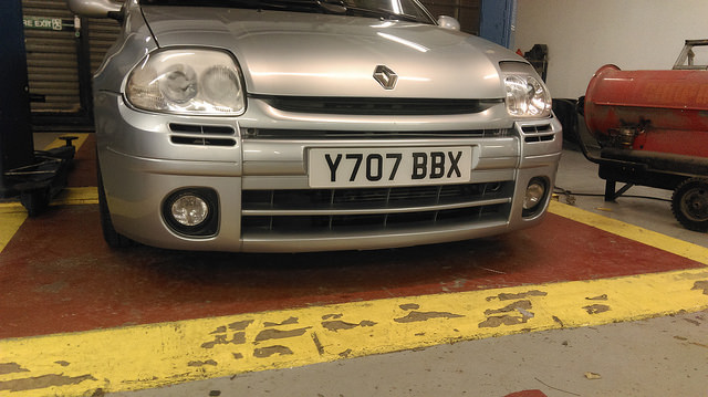

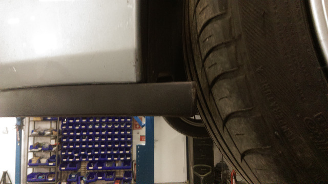

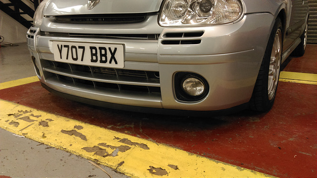

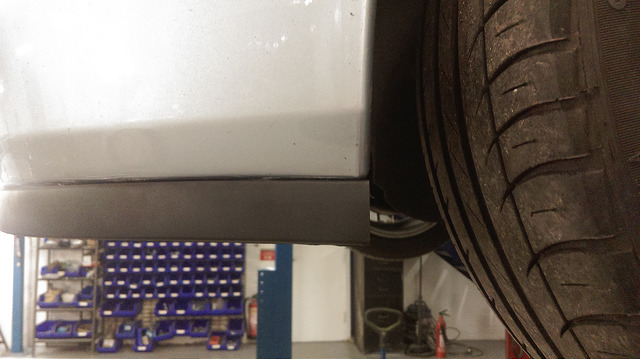

Got the splitter fitted tonight.
Front bumper before splitter fitting
by Dr-Jekyll, on Flickr

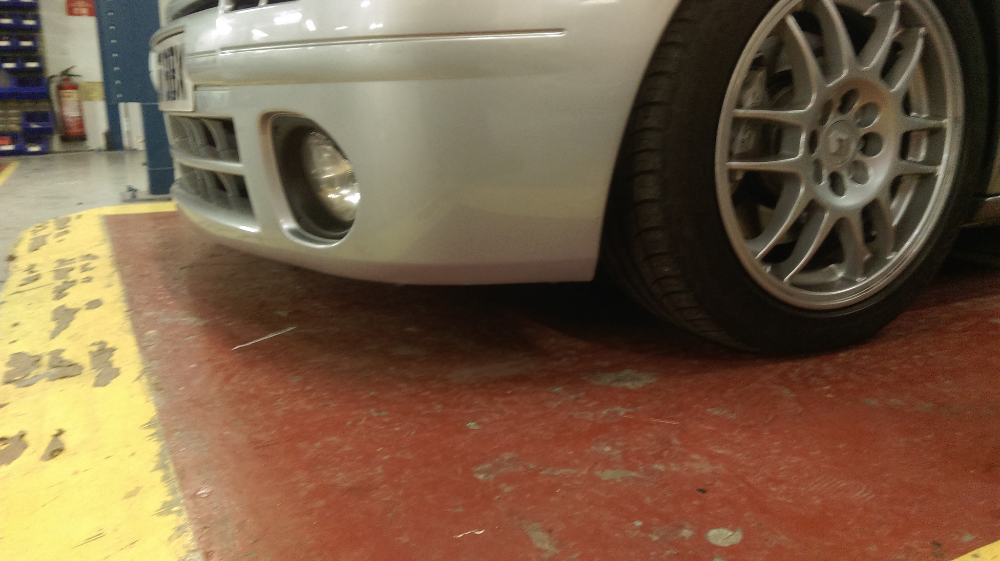

Front bumper during splitter fitting

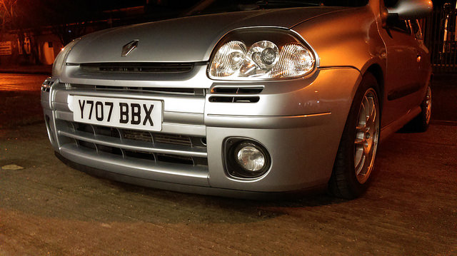

Front bumper with splitter fitted
It also hides a few of the bumpers battle scars! :blush:
@mintno1 Here's a few pics of the fabia splitter fitted.
