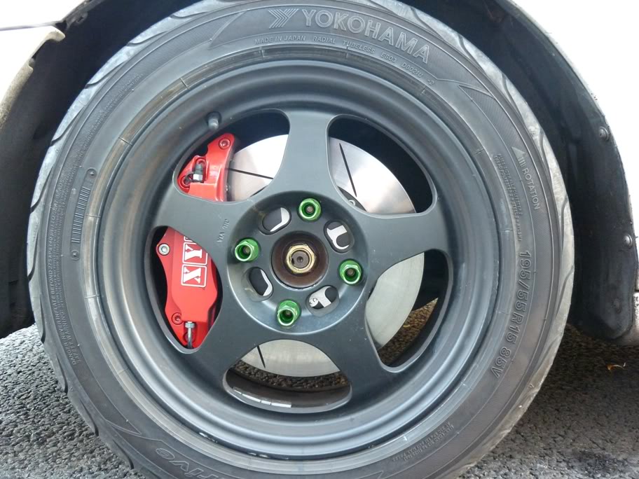

Depends what its for, I guess.
If your going on track, then uprate to better calipers etc too.
If not, solids or grooved with fast road pads + good lines will be more than enough.
Good fluid is a must too.. RBF etc. And a Brake stopper.
I say go the whole hog...
