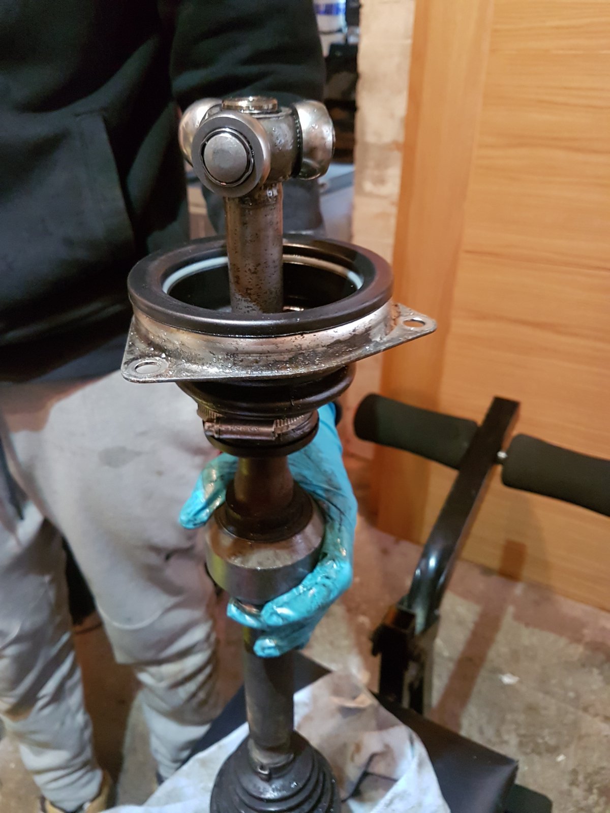

Hi,

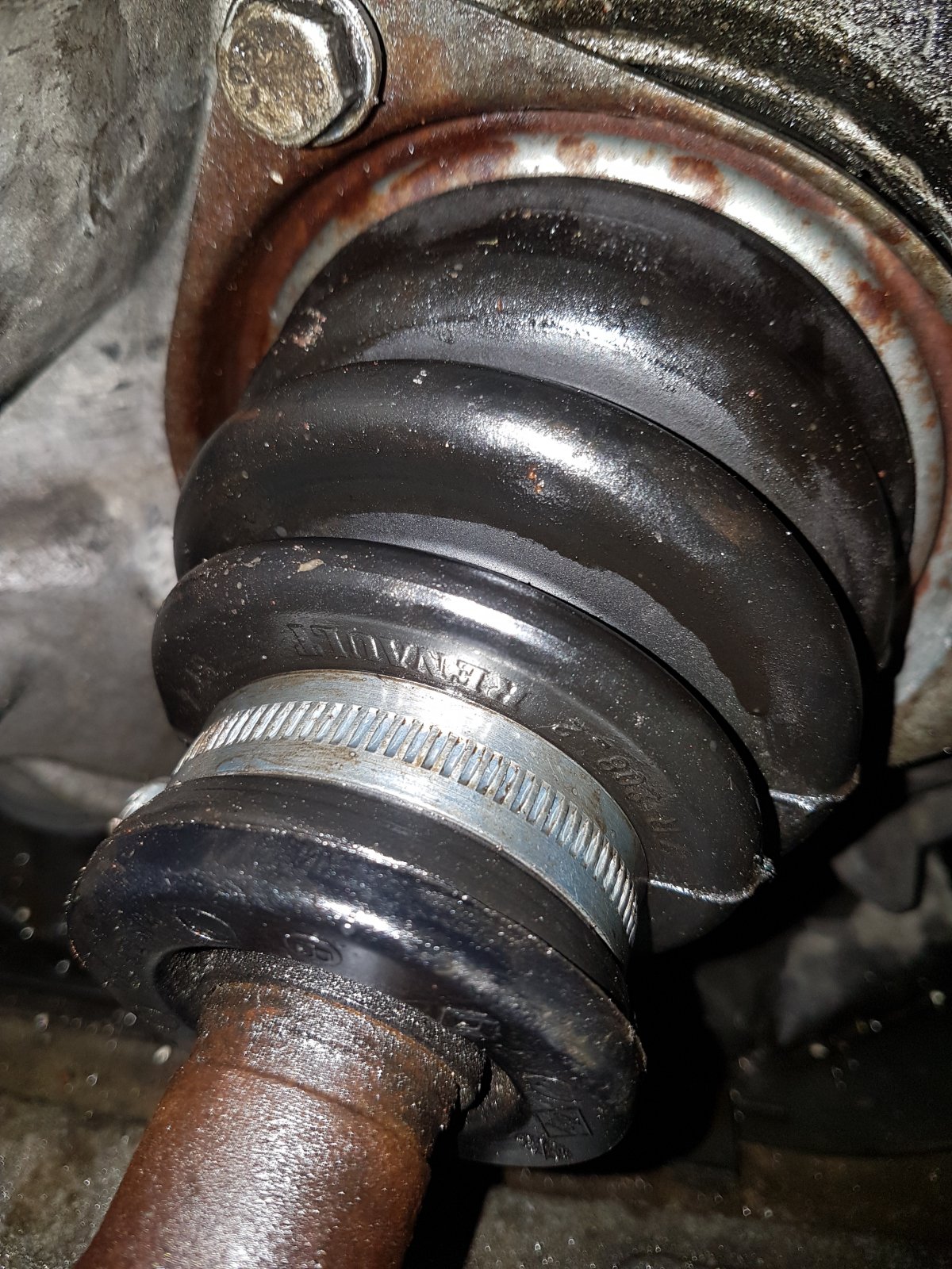

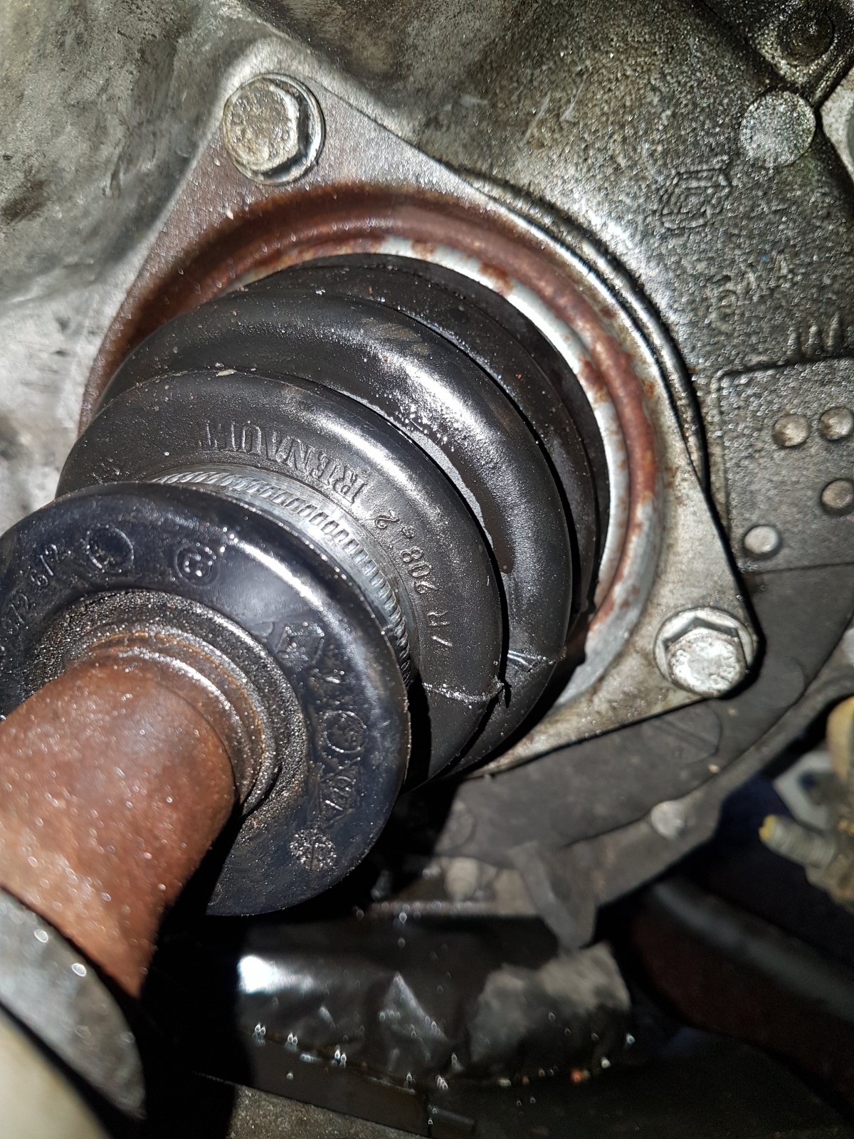

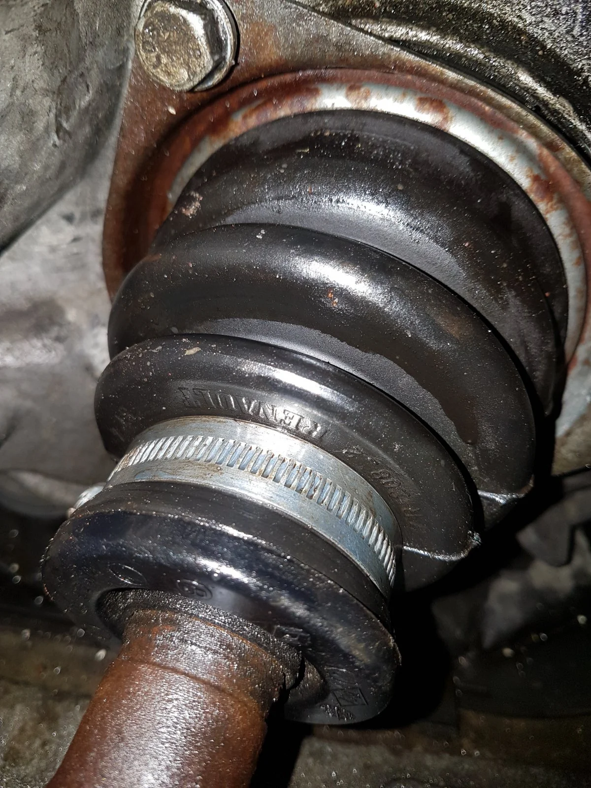

Accidentally pulled the CV boot off the driveshaft on the passenger side of the car while taking the hub off for a bearing change, car of course let loose plenty stinking gearbox oil. I replaced the cv boot clip with a Jubilee clip as that seems the standard on here with most people who are pissed off that it keeps coming off.

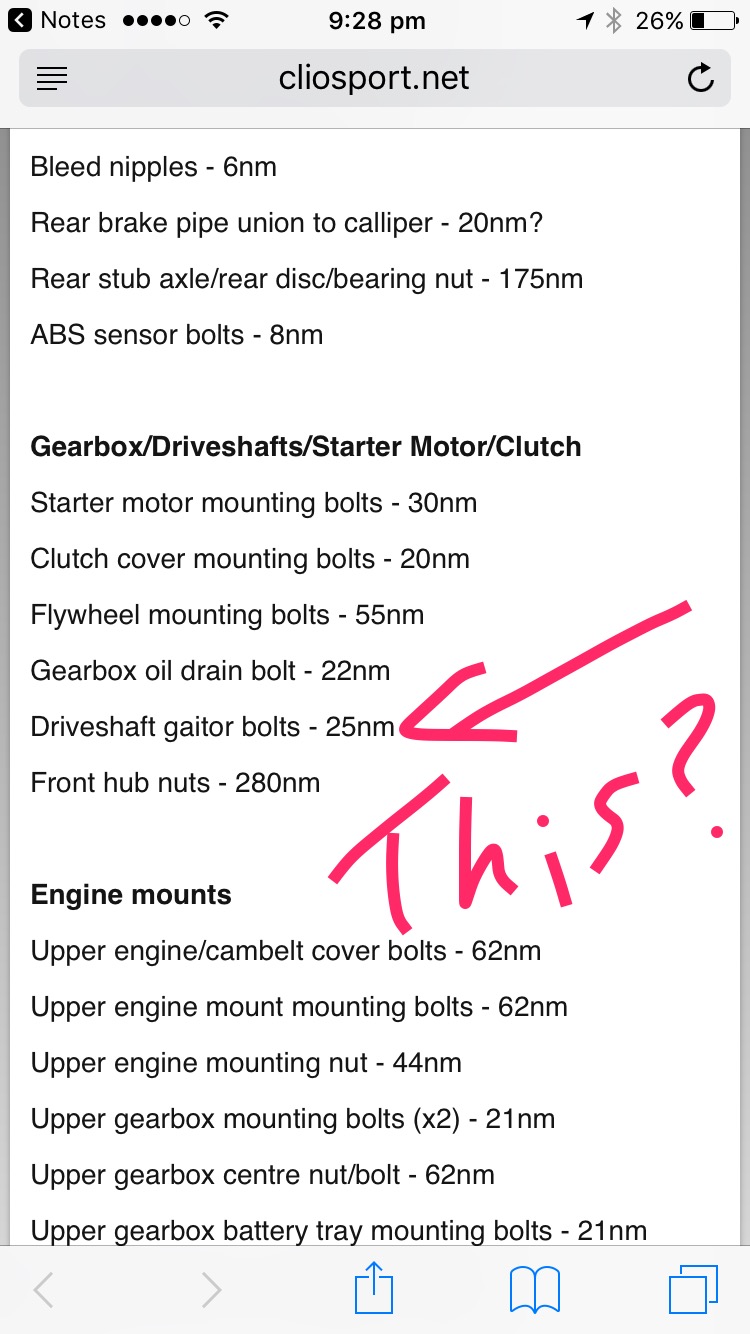

My question is when placing the driveshaft back in, what is the torque setting for the 3 bolts that hold the boot to the gearbox?
Also, please point out if I've done anything stupid here (first time doing this) and any tips for replacement, other than replace gearbox oil ect.
