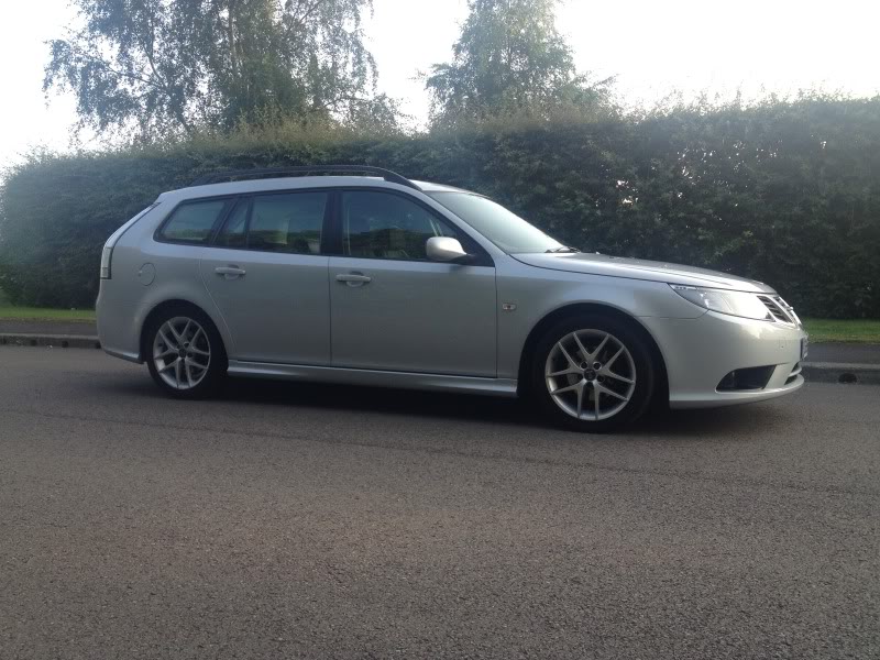

I recently bought a Saab 9-3 Estate and have noticed the rear quarter has been resprayed at some point. Upon closer inspection you can see where it's been masked off against original paint work! The overall finish is also a little duller than the rest of the paintwork and actually looks a bobbly if that makes sense?
Can anything be done with cutting compounds to bring it back to life or does it sound like another respray will solve it?
I'm afraid I don't have any photos at the moment but will get some this weekend. The car in question is below, it's an odd colour because it's not metallic as such.
