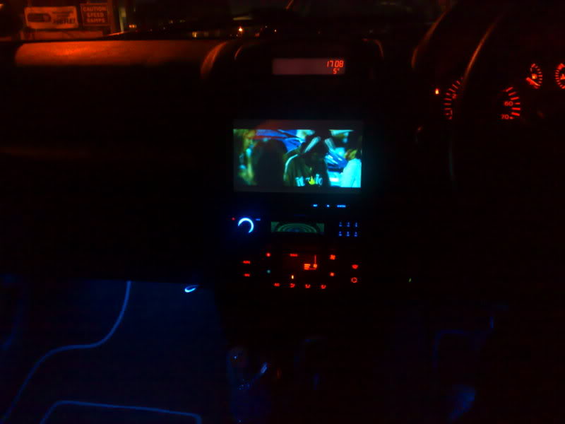

Cheers guys, fitted and working fine now :)
