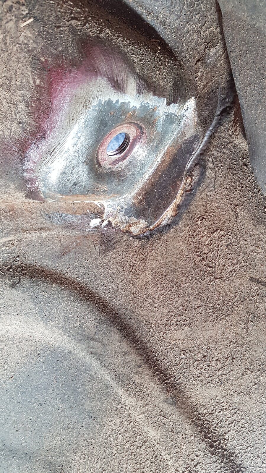

I'm in the middle of an underside restoration (car is still on the axle stands after all the wind!) Where I've had to get back to bare metal I've coated with 2x hydrate 80, 2x electrox and was going to finish this off with Dynax UB. Will this be sufficiently robust or should I be putting a stone chip type product on?

UB dries to a rubbery finish intentionally to absorb stone impacts.
I scrapped some off in me offside rear arch when doing the fuel flap that was consistently a good 2-3mm. I do like UB but only used the spray form which begins to run quite quickly so to get a thick coat I was finding difficult.
Give it a 3 thin coats and that will be all you need.
It is designed to be fairly thin (80microns) so equivalent to thin paint on car panels. But the rubbery finish will absorb rather than chip like paint.
