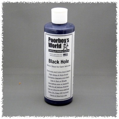

On your car/colour I would use this as a quick and easy fix... It will "fill" the swirls rather than remove them and give BG a glass like appearance. You'll be shocked at the results.
http://www.polishedbliss.co.uk/acatalog/poorboys-black-hole-glaze-cat9.html (free delivery aswell)
Use these... http://www.polishedbliss.co.uk/acatalog/blackfire-ultimate-applicator-pad-cat24.html
Cheap and easy fix.
Obviously your car could probably be doing with a clay and a good 2 bucket method wash before hand but if you're not that into detailing this stuff is a quick fix.
Follow it up with a decent long lasting wax to seal in the fillers. I'll have a think about a decent wax for you. :D

Will the poorboys stuff take a lot of polishing, is it easy to apply and remove? I've got a few applicator pads and some cloth's to remove excess which ive owned and hardly ever used lol

Yes it will last a few months mate, the wax will keep the "fillers" in the glaze in the swirls so they appear less pronounced.
Lock the fillers in so to speak, eventually the fillers will dissapear through washing so then you will have to strip it back and re-glaze say every 3/4 months if the wax is doing it's job.
The product is so so easy to use you cannot go wrong with it, it won't mark trims and if you apply nice and thin while working the product into the paint it'll come off easily. Research on Polished Bliss' website to understand what the product does.

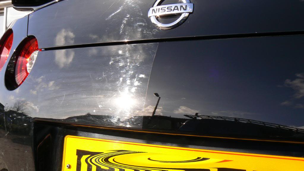

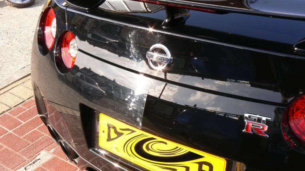

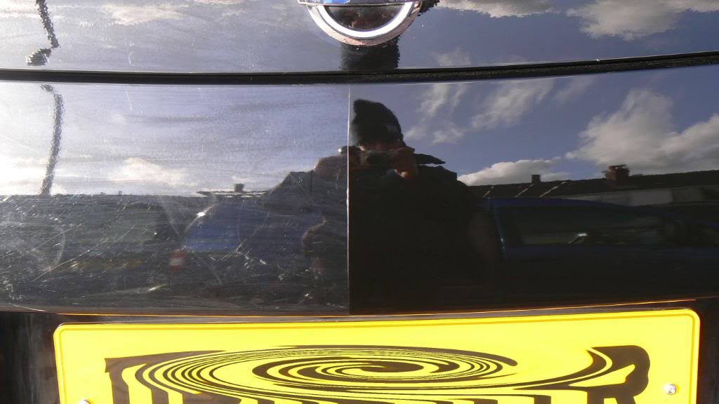

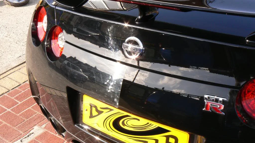

Here is what Blackhole does...
Please please bare in mind these results aren't permanent and will degrade quickly with poor wash media.
Drying towels :eek: how many would I need to dry the Clio? I think I'll defo purchase the Blackhole stuff as that looks like it does a great job! I understand it'll need re applying but keeping it to a minimum is good for me.
So at a minimum I should purchase the blackhole and auto glym wax?
Yes. and you only really need 1 drying towel.

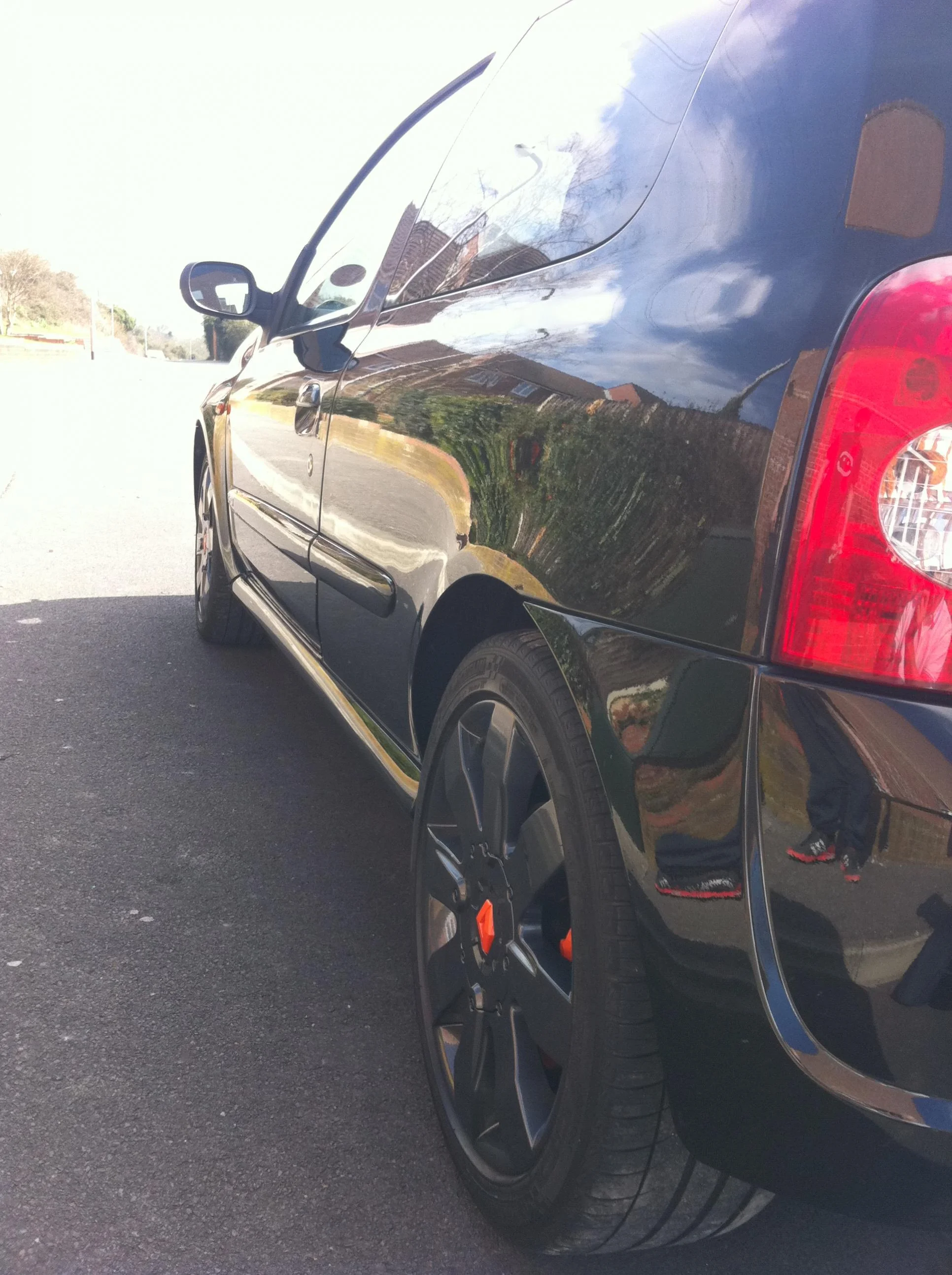

I'd also chuck a vote in for AG ultra deep shine.
I know there aren't many fans in the detailing section of all in one products (and I am by no means in any way a detailing guru like gally, JD etc...) but for speed of application and ease of use for a novice it ticks the boxes. Can't comment on the longevity of it as it's only been on mine a week, but filled swirls nicely and gave a good shine.
See my media thread for results on BG 182 (from a polishing and cleaning newb):

I never knew pb blackhole was that good :eek:
I must add that was applied via machine and the nissan paint is so so so so soft. But it'll still give impressive results. :)
Quick question..... How difficult are those machine polishers to use? Can anybody do it or is there the possibility of causing a major f**k up?
Yeah, the pad that you are using will determine the kinda cut involved. Using a pre-wax cleanser like Lime Prime on a yellow 3M pad can correct some cars due to the cut of the pad. Understand.
Don't get me wrong that GTR is not corrected but it will have removed a few swirls due to the 3m Blue pad offering a little bite. :)
I doubt there is softer paint out there, the GTR is a nightmare according to some detailers and black is obviously very bad so in most cases it's actually best not to do too much to the car for fear of marring further. :)

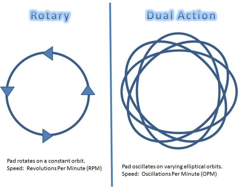

If it's an orbital you shouldn't do too much damage or cleacoat removal, with a rotary and no training you could end up with strike throughs. Using a rotary with cutting polishes should always be preceeded with a paint depth guage.
Next silly question. What is the difference between a rotary and orbital? I take it rotary in the right hads would produce better results?
That's a pretty good explanation.
The DAS6 Pro is the best DA machine. Funnily enough DA's are more expensive than rotary's.
