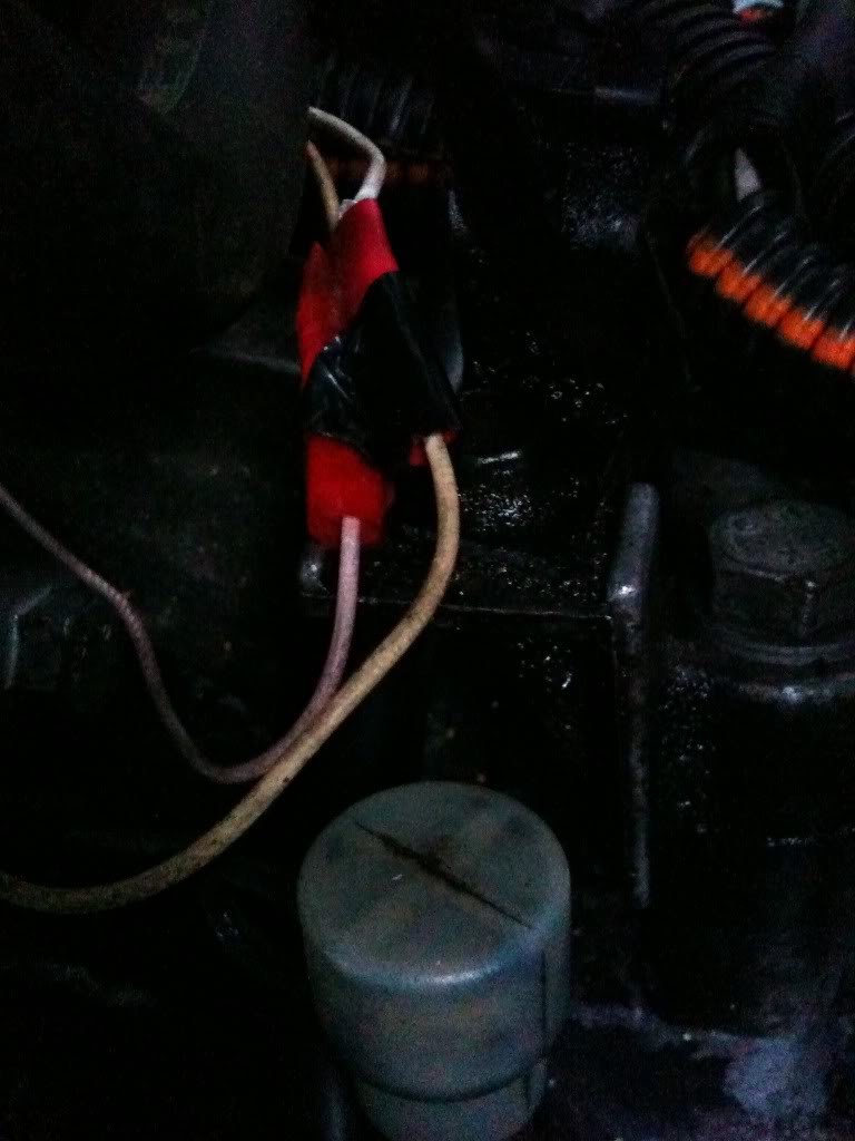

Regardin the TDC sensor this is how mine look,
i have a feeling that your goin to say that the wires are on the wrong order
Had a quick look before it started raining and the black fuse looked like it was in but infact underneath the fuse had come out alot, so i shoved them back in and fuse sits fine now,
How is that connected? Looks like the looms been butchered at some point, there should just be a couple of wires running to a plug that goes directly into the TDC.
Gotta be worth switching them over just to check

It has the new style TDC sensor fitted, with the new one its blue but also had a different plug so you have to wire it to the old loom hence the butchered look, its been connectd together properly but i added that red tubing which crips to both sides so water wont kinda go into it lol,

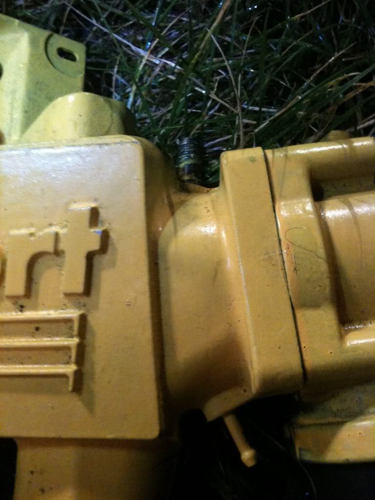

Ok, so iv been workin on the car for a hour, to try and see why its revving so high,
Removed the inlet mani and check for the egg shaped ring and it was there and in place correctly as you could see the mark on the rocker cover were it was resting against.
Next i checked the connector on the back of the mani and that was on properly as i have a jubilee clip holding it on tight, the only one i dont have anything to connect is the front one..
see here:
But iv had my next door neighbour to block that with his thumb when i turn the key and it still goes up to about 4k+, .
Now i think i should mention this but when i turn the key for a split second it will idle at about 1k then up its goes high,
  Astra 1.9Cdti SRi
noo huge lol, hes blocked the one in the front(small yellow one)
So im just curious why the heck its revvin so high, could it be a dodgey sensor on the left of the inlet manifold
  Astra 1.9Cdti SRi
ahh ye, could they be at fault?
