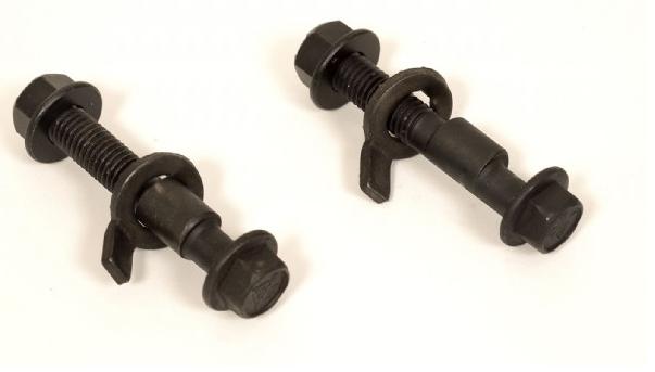

I Have a set of these bolts for my front suspension but need some help to install them:
Do these bolts goes at the lower "hole" of the strut?...the strut has two bolts to hold it to the axle piece, I guess this camber bolts goes where the lower bolt goes but not sure, second is: It doesn't fit my strut, the diameter of the hole is smaller than the "eccentric" part of the camber bolt, Do I have to drill a larger hole(same size of accecntric bolt)?
Thanks!
goes in the top hole, bin off those washers, they do fit, just loosen off the lower one when you fit them
