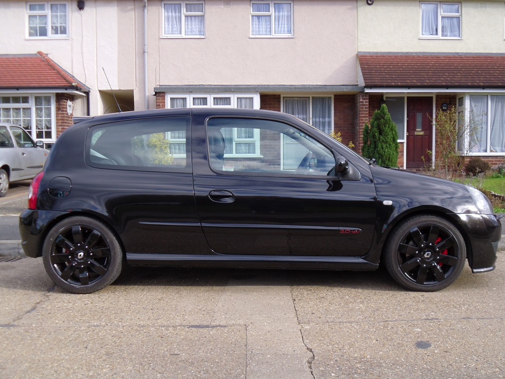

sportlines. it shortens the arch gap slightly, more so than the prolines. the ride is slightly more bouncy but still comfortable. no rubbing at all and im currently running 205/45/16
i know it needs tyre shine, but it gives you an idea of the drop.
jack how are they - regarding stiffnes, bouncines? did the handling improve with this setup or not?
They're progressive so stiff enough when they need to be but without being crashy or bumpy. If it wasn't for the fact that my arch gaps are too big now I have 15's I'd happily keep them. Combined with a whiteline ARB they're all you'll ever need on the road.
Tgaz16v - they'll settle another 5-10mm mate. Don't worry :)
