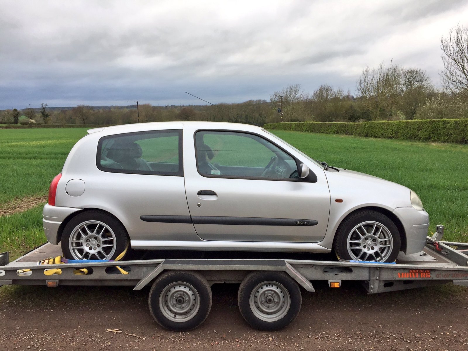

Nice, will have a search for some pics. Mine looks funny cause the front sits a bit higher than the back so want to see if Sportlines will sort this out.
search for alans old 182. looked superb on the sportlines. im getting some for mine
