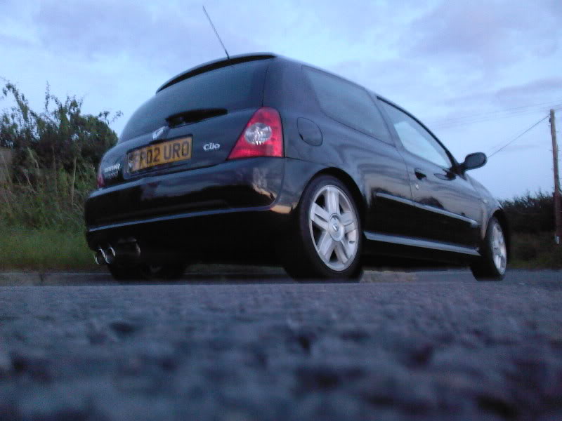

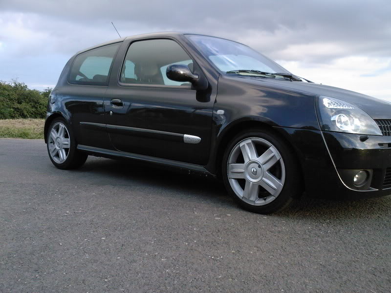

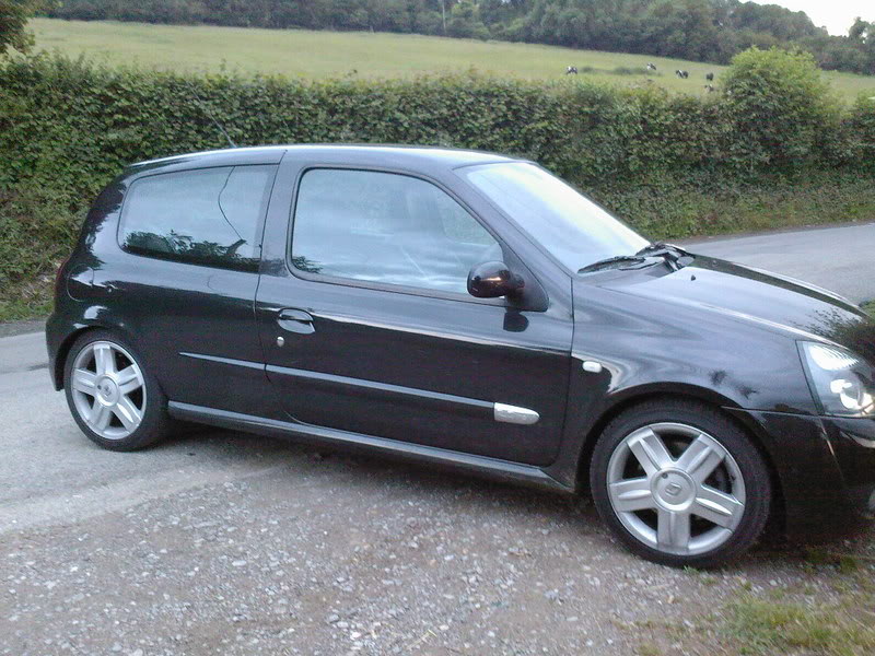

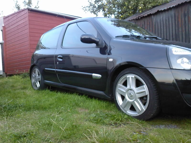

Few of mine for you mate.

the thing i find with sportlines is they dont all lower the same. Lemon's car above is a good drop and noticeable whereas i have seen others on here where they aint noticeable. sometimes higher than standard!
I noticed the same on some of the 182s posted with sportlines, but Fubar commented that cup/cup packed stay the same (or maybe go up a little according to some peeps) and non cup packed see a heathly drop.:)
lemonnobby
Yea they do i had them on my 1.6 as well so i dont know if thats something to do with it, but everybody says it very much looks dropped.
