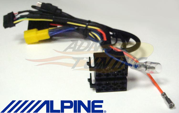

Found some pics online
alpine-apf-d101re-interface-commande-au-volant-et-afficheur-deporte-renault-44986-750x475.jpg
alpine-apf-d101re-interface-commande-au-volant-et-afficheur-deporte-renault-44988-773x650.jpg
Looks to me like the red wire goes in the top pin and the white wire goes in the bottom next to the black wire
Fingers crossed that's right :D
I'll put a bit of solder on them and try hooking it up - see what happens
