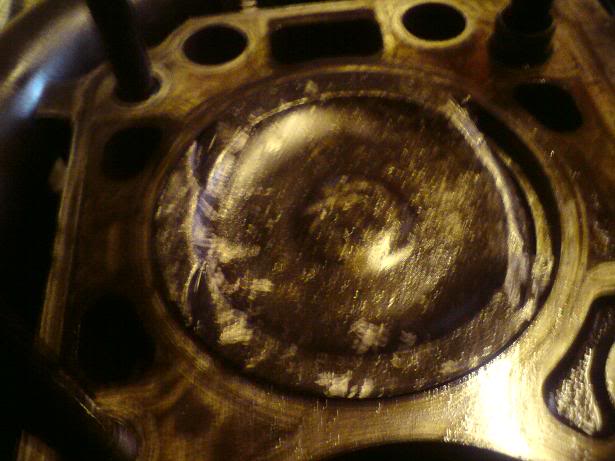

This is Gary's just run in and mapped engine 120 miles after it left the JDM dyno:
Literally nothing left of the back of the piston, you can actually see the ring.
But if its who your engine builder recomends then the simple answer would be to ask him to take the car down and give it back to you when tis finished, its his problem if it melts then?!
cheers mate, After seeing this pic i'll definatly be speaking to the guy thats doing the work on my engine about using a diffirent tuner.
