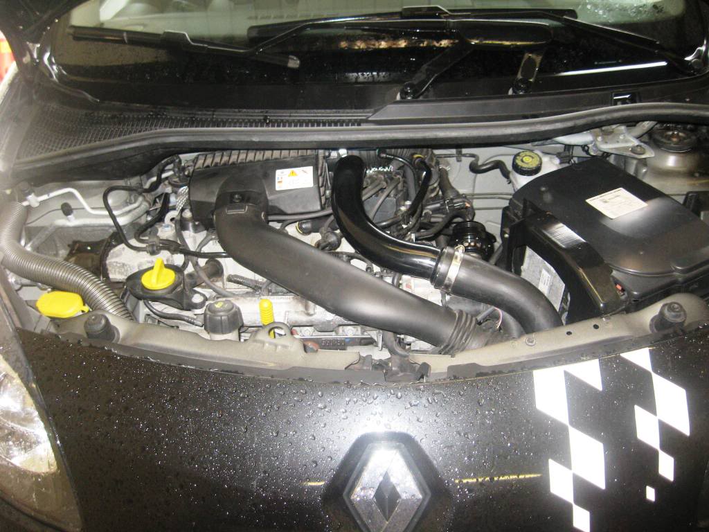

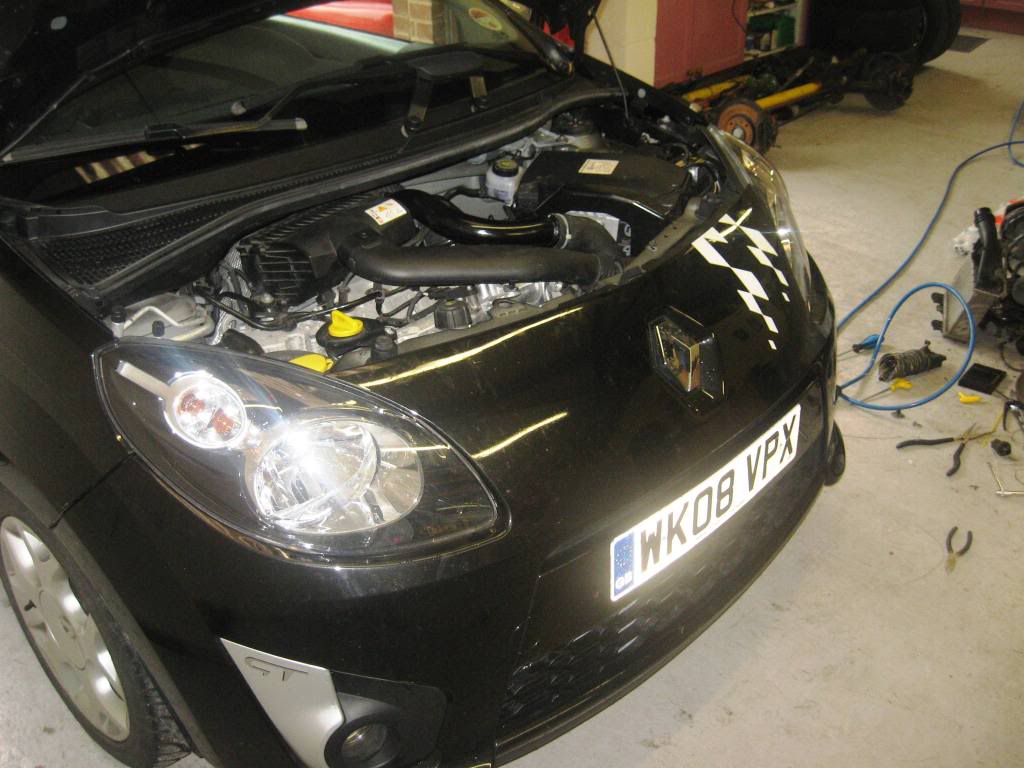

welll i have the GT model aka the 1.1 TURBOOOOOOOOOOOOOOOOOO!!!!!!!!!!!!!!! lol but can only get 130 hp on standard injectors and its easyier and cheaper imo to drop a 172/182 in there. will post some pics of mine but the engine bay is identical, notice the strut tops etc. and engine mounts.
