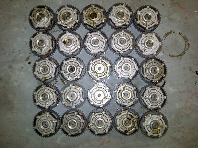

Its your dephaser mate. Luckily for you diamond motors is on your doorstep. £5-600
I'd put money on the dephaser! Makes them sound like a diesel!
Problem ive got is ive just spent most of my dough on the car! Is it something that i should take the car off the road for? Or can i run it till next months pay day? Like i said you can hear it clearly when youre stood next to the car..
I ran mine with a rattling dephaser for a good 12 months . I took it to Mick at Diamond motors , lucky that I did actually , because the water pump was on It's way out too . So the answer to your question is yes , if it is the dephaser , which is highly likely from the description of it sounding like a tractor you'll be ok until next pay day .
It's 100000 percent the dephaser. Cannot possibly be anything else. Do the water pump and obviously coolant too at the same time. Not worth leaving it out tbh

Just to update. Had the dephaser, cam and water pump done and noise has gone. The cam timing was also out and was causing some crazy acceleration too. Felt like a diesel till 5000rpm then shot off like a rocket. Got a nice accel curve peaking at 5000 now. And its gave me an extra 10mpg.
I know so people say it can run forever after it starts knocking, but seriously guys its money well spent. No more embarrassing looks when i have to stop at lights are anything now!!
