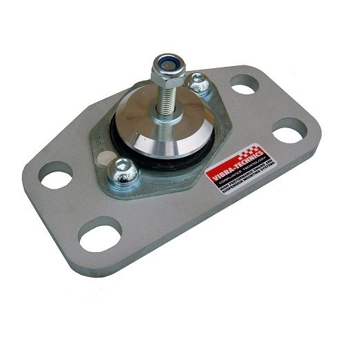

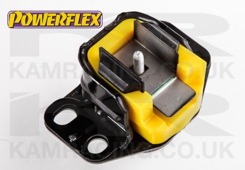

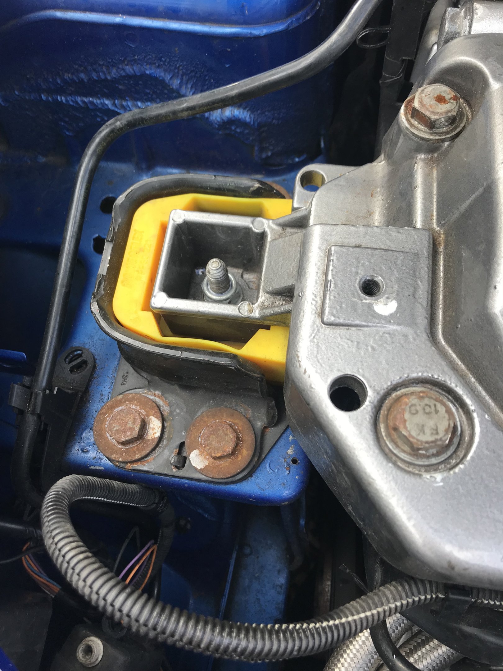

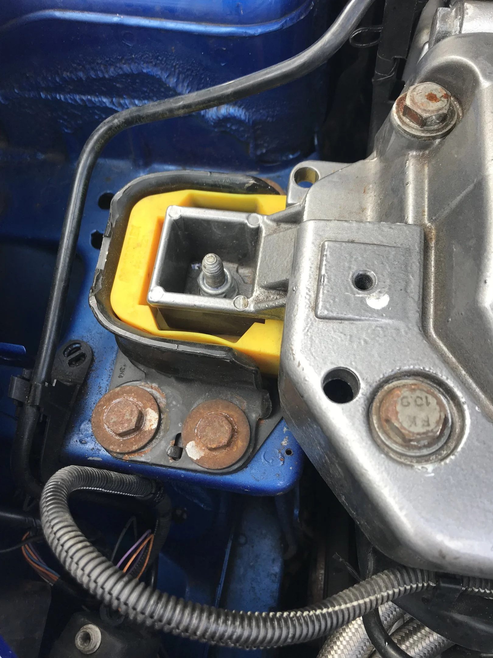

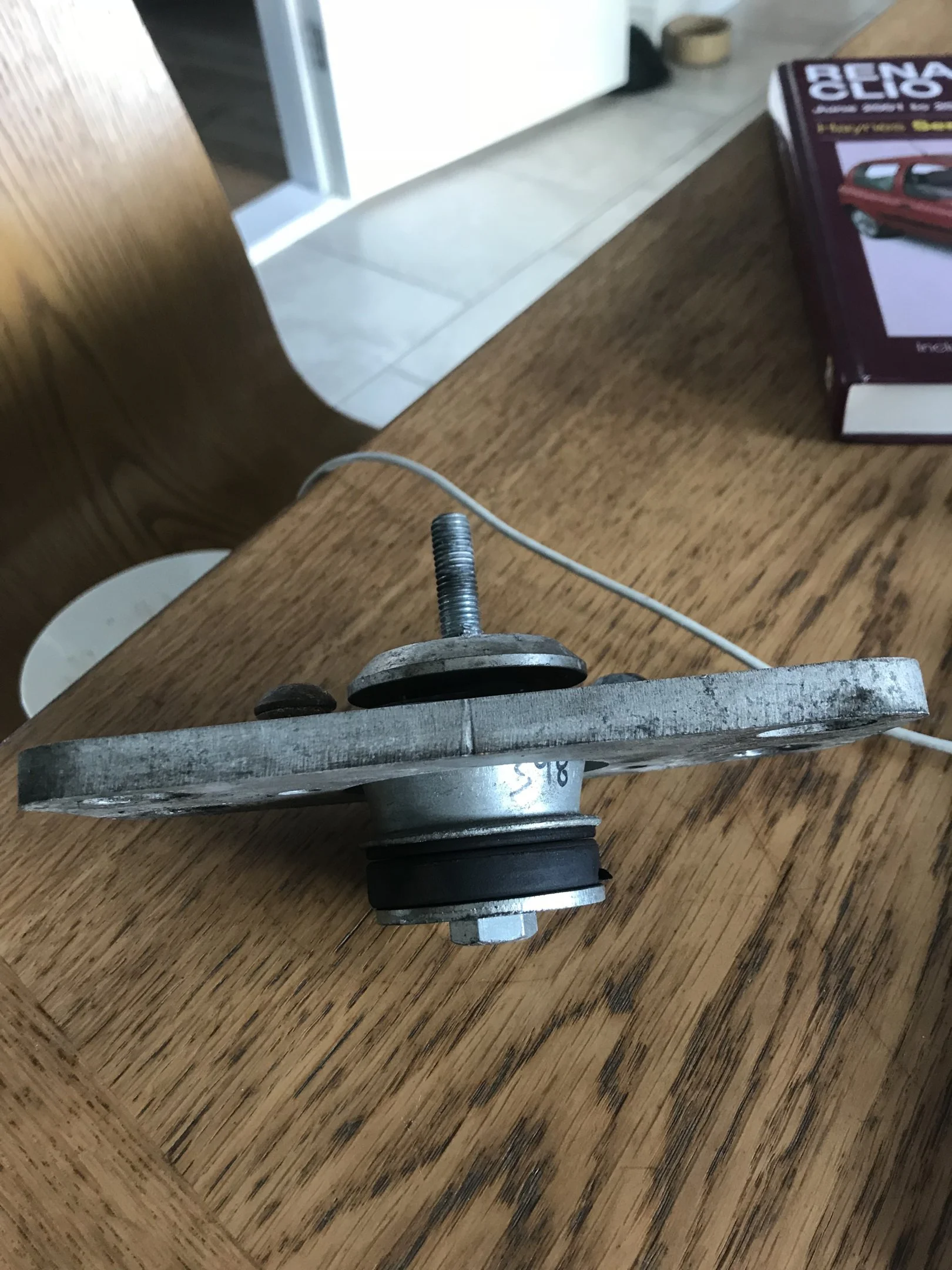

I have just changed the driver's side engine mount on my PH2 172 cup from a vibertec mount (photo attached), to a standard mount with a yellow power flex insert. To do this I supported the engine on a jack removed the old mount and offered up the new mount. However, I found that the engine was sitting much lower on the old mount 20-30mm and so I have to jack the engine up to get the mount bolted back on. Is this normal or have I done something wrong? For information, the gearbox mount is also a vibertec unit.
Thanks all

The old mount was installed the wrong way up?

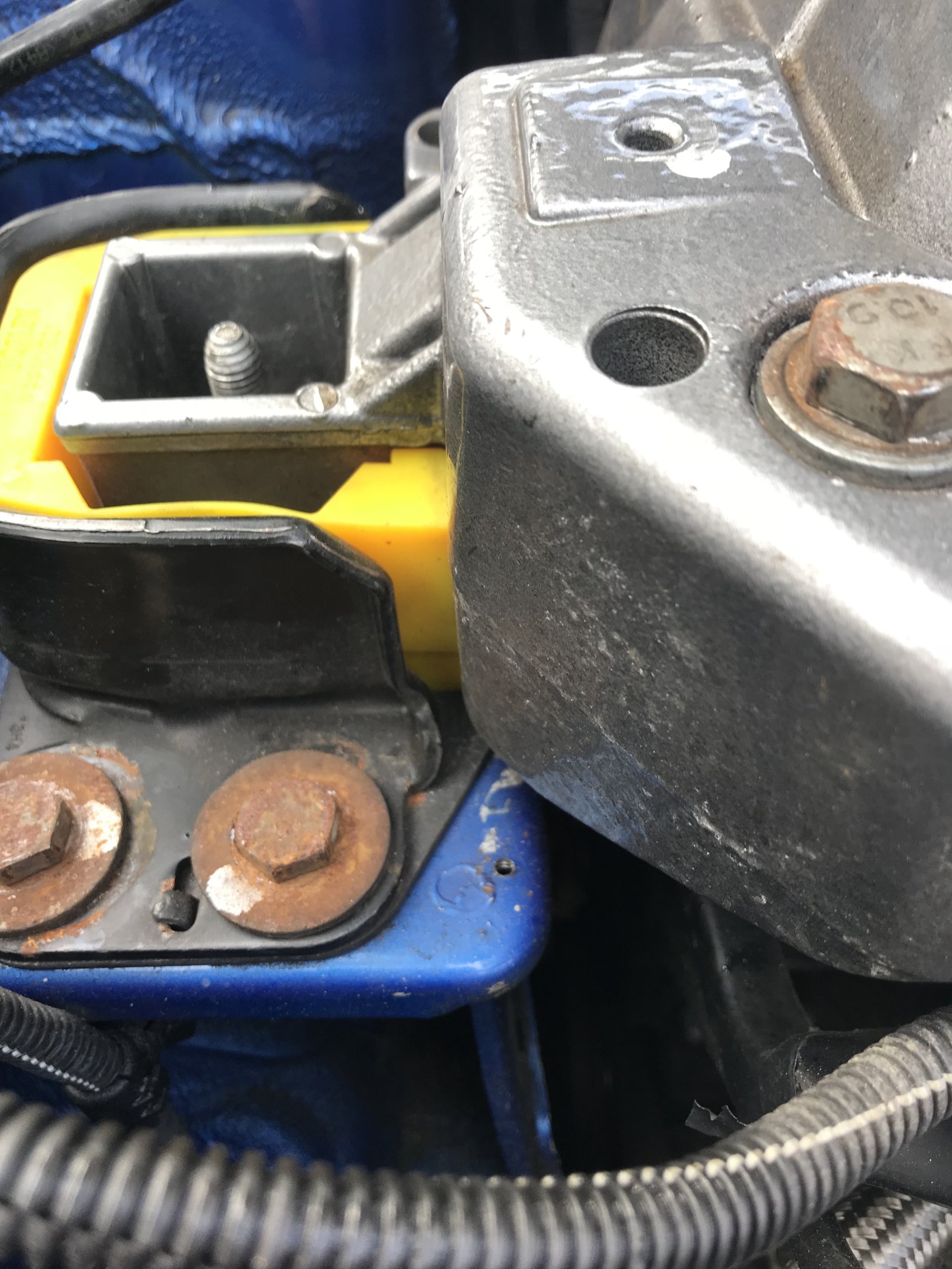

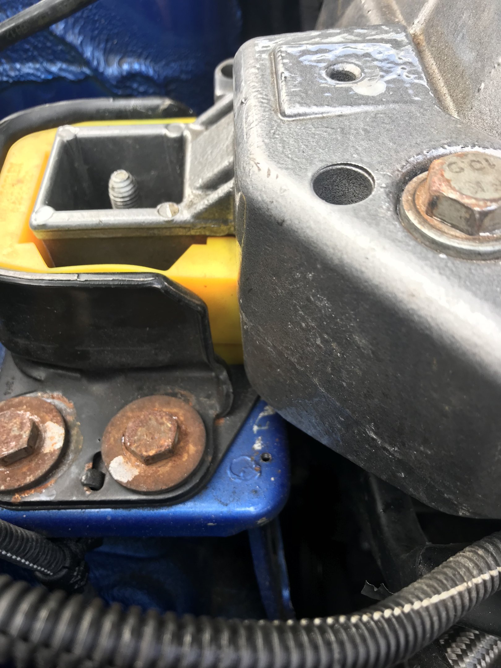

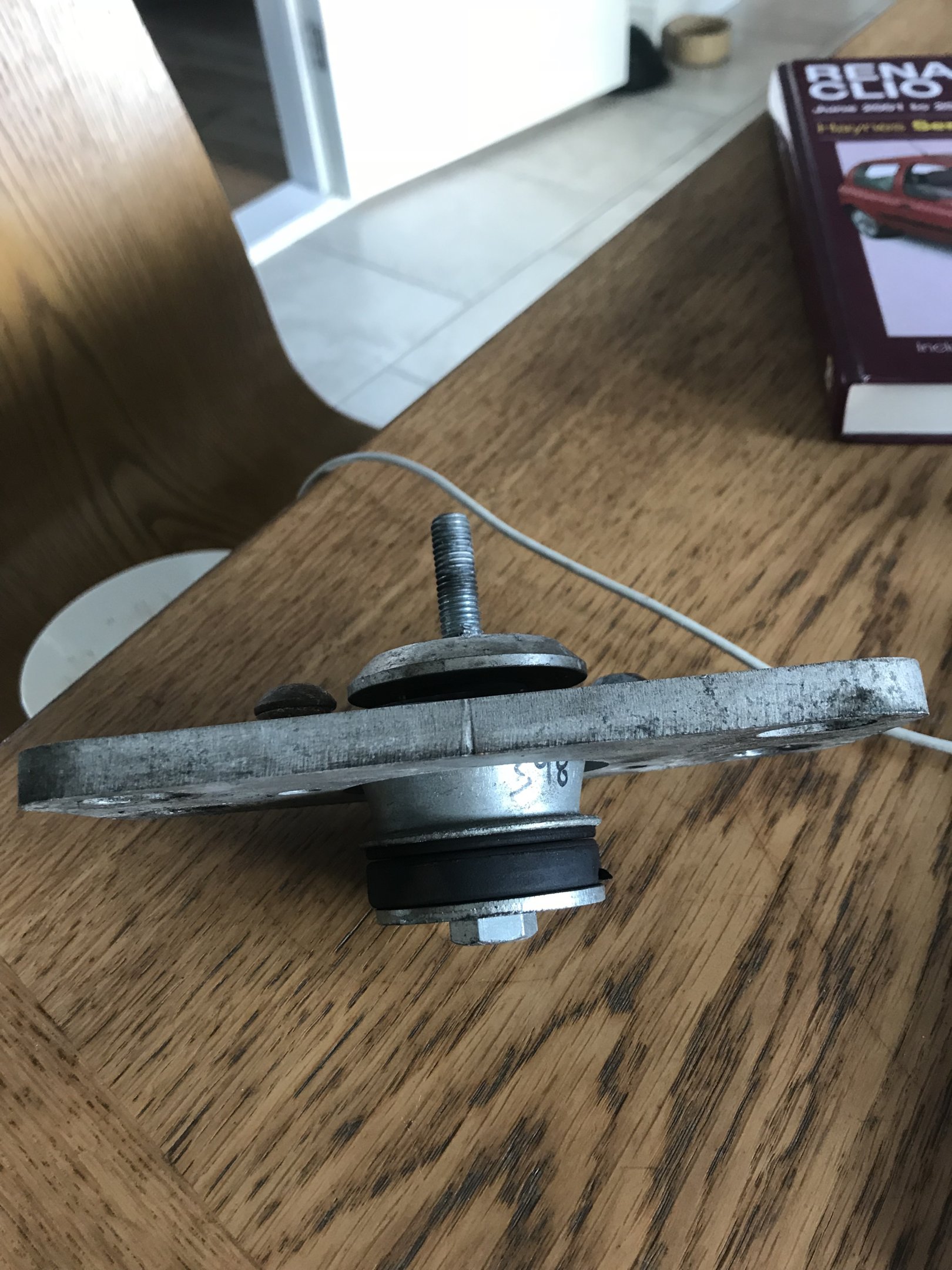

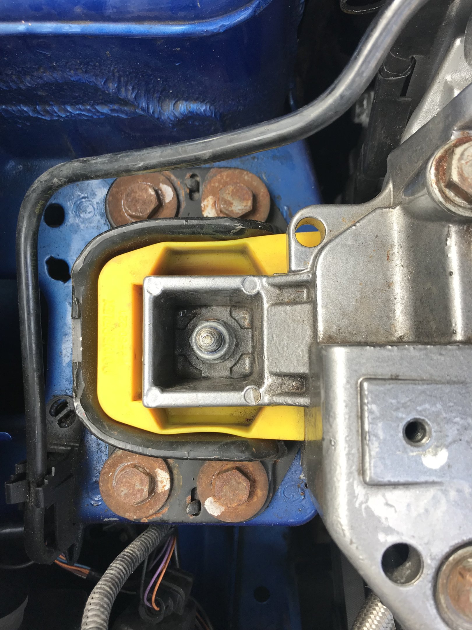

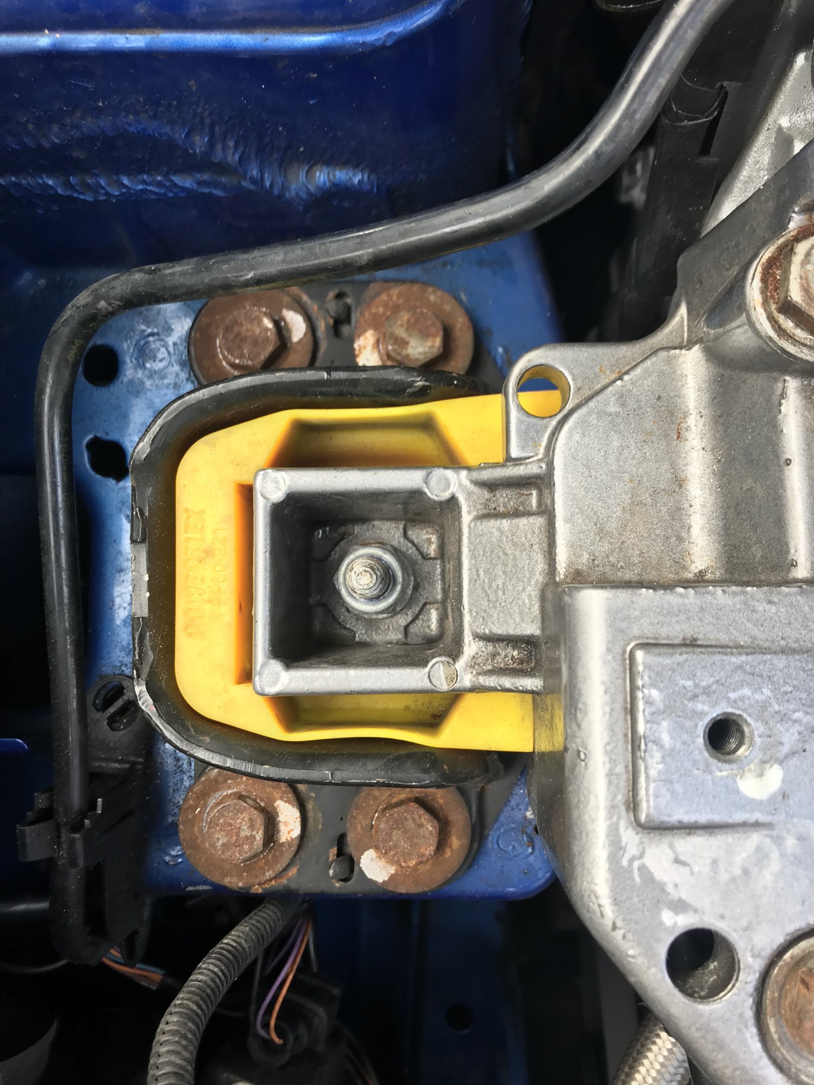

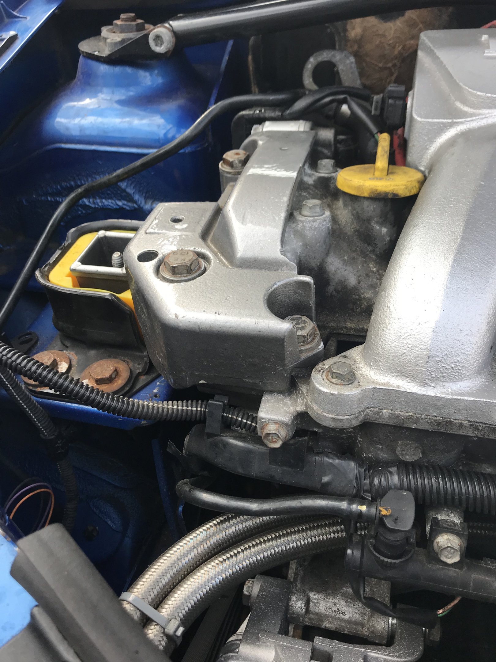

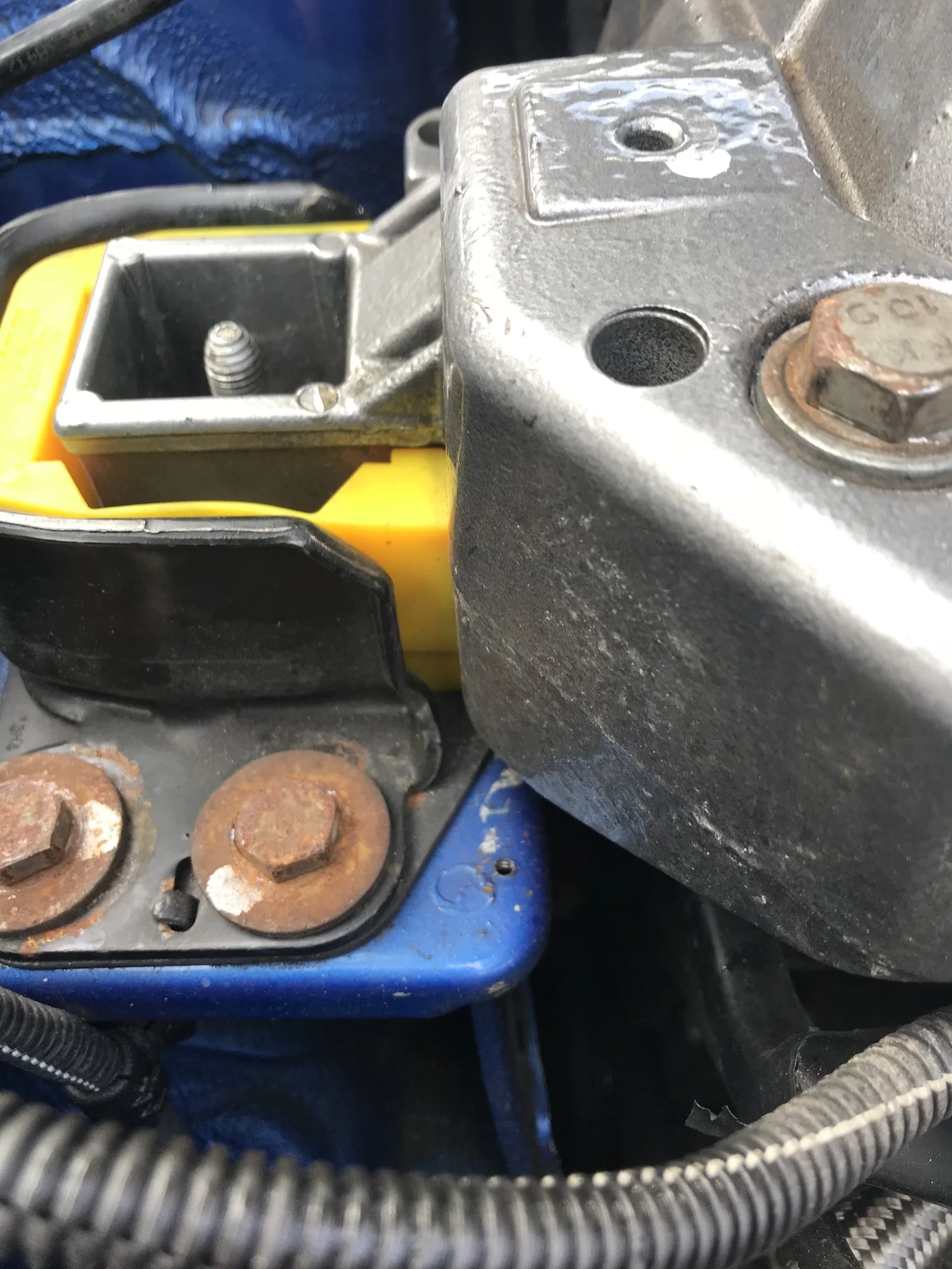

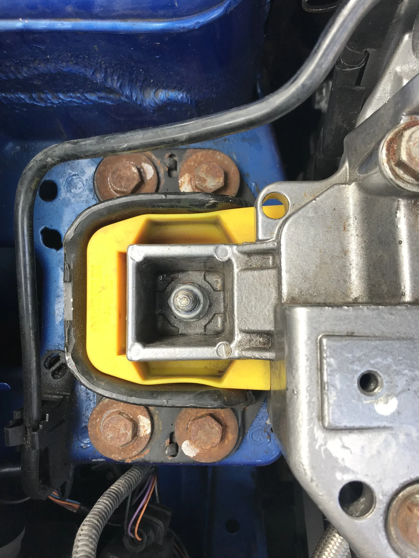

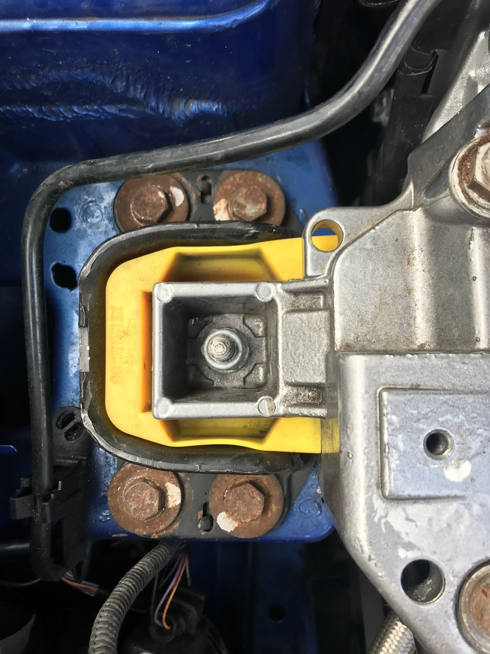

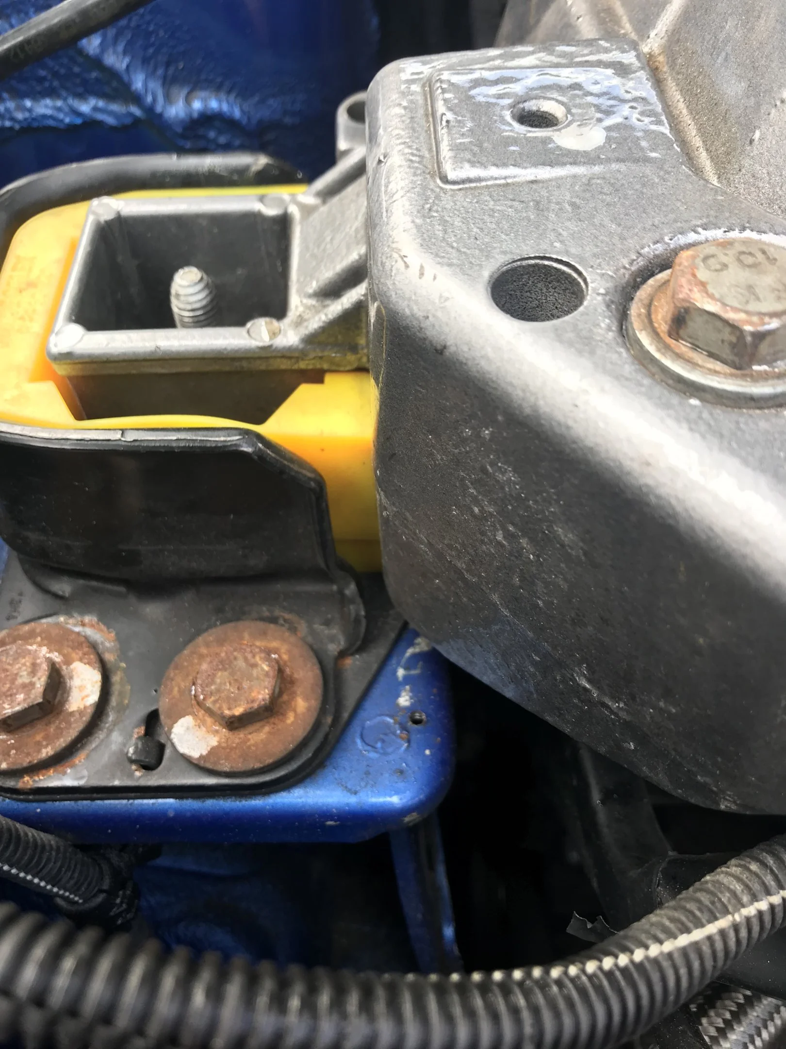

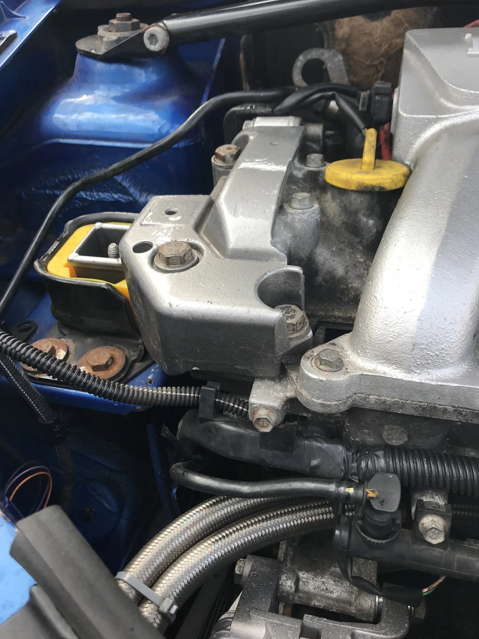

I don't think it was installed upside down, as the nut was threaded onto the vertical bolt shown in the picture. This is how the mount is sitting at the moment - am I missing something? I cant see any way of getting it lower.
You have omitted the plate, though that is not relevant to the height question.

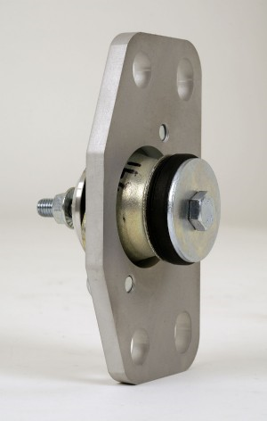

If the Vibratech mount was installed as per your picture, it was upside down.
Thanks Steve,
Yes, the mount was installed as shown in the picture (not by myself I hasten to add, must have been the former owner or who rebuilt the engine).
Hopefully it hasn't done stress damage to any of the other mounts etc.
I'll get the other plate installed as well, that should reduce the movement. The only reason I was replacing the vibratec one is due to the vibration, which was probably caused by the mount being fitted upsidedown....FFS!

You could reinstall the vibratec the right way up, but don't run the Powerflex with plate missing, this will happen.
https://www.cliosport.net/threads/power-flex-bush-split.817011/#post-11582736
My picture is prooving quite useful lol
The benefit of the Powerflex yellow is you can potentially remove it between trackdays to soften the harshness of the mounts. Dont try that with the black mount though as theres so little flex they are an absolute bugger to take out.

So I've been looking at this again today, and can't work out how the vibractec mount is upside down. It looks exactly the same as the pictures from their website.
Can anyone elaborate?
That's normal vibra technics makes the engine sit lower although not sure its 20-30mm?
You & I have been a pair of numpties over this, which give someone a chuckle.
What you have done is correctly supported the engine on a jack & then removed the 4 bolts from the casting covering the cambelt.
No longer anchored to the engine, the front of the car has risen on the suspension springs, so when you went to fit the new mount, it gave the impression that the engine must have been lower on the original mount.
If you had been fitting like for like, you would have probably worked it out.
For my part, I accepted what you said, looked at the Vibratech mount and thought if you flip it, it will sit higher.
It`s up to you to choose to refit the Vibratech, the standard mount with the powerflex insert or just the standard mount.
The first two will give some increased vibration on tickover, but the payback will be improved gearchanges and reduced lateral movement which can bind the driveshafts when you are up on 3 wheels.
The Vibratech was installed correctly in the 1st place.
