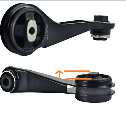

Looking to replace the rear engine mount/ dog leg bottom mount.
2 questions
1. How do you modify the original one to be more supporting and not get wobbly beyond silicone in the gaps.
2. The one for the automatic gearbox looks way more stable, will it fit manual cars?

I'm tempted to do my own poly job on it. Do you just make sure the bolt hole is centred and pour around it? It's not a moving part so I can't see why ya can't just do that.

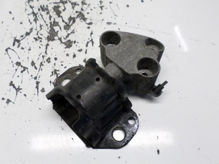

Not sure if the 4th gearbox to subframe mount from the 172 will fit the JB1 but that's a good solution if it does, I fitted it to a JB3 with no issues

Well I've got a standard 1.2 so powerflex and front gearbox mount aren't applicable. It's not got too much movement in it, but always best to play it safe. Will get new top mount as well.

And for the rear engine mount in principle yes, the bolt hole is offset so as long as you take measurements and replicate fitment it should work
