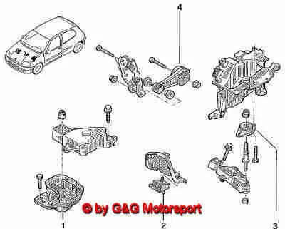

Right I have read everything on here and cant find the following.
- Pictures of engine mount positions

Dogbone - just access to undercar, 2 bolts
LH top Mount - hold engine up with trolley jack, undo 8 bolts
top and bottom g/box mounts - remove battery, access to under car, support gearbox on trolley jack, remove bolts to both mounts then move g/box up or down to get each mount out
no pics, sorry
as above with posistions. i'm a total novice when it comes to mechanics but me and a mate managed to change all the mounts on my ph1 172
hard to see positions but thought it might help a little
thanks for the advise, I have a phase one 172 so will have a go a the weekend, might take pics and create a guide. Thanks for the technical pics that was really helpful
