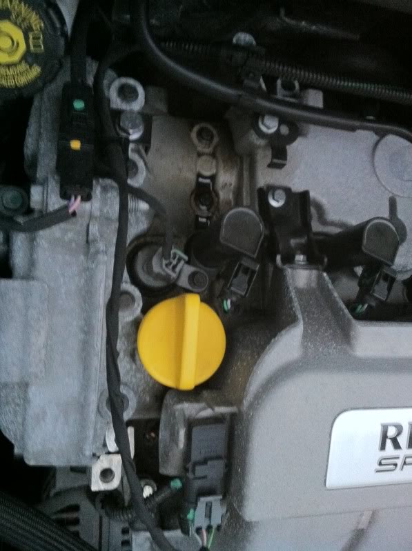

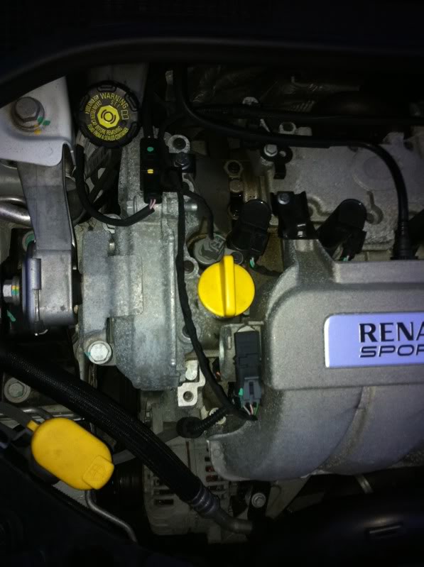

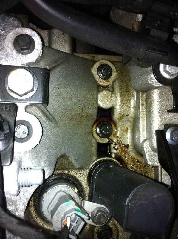

Engine oil leak.
Car  GTD, Lupo
I can remember seeing a similar thing happening with 197s but i cant seem to find it. Just want to get an understanding of what the issue is before i head down to the dealer and they all run and hide from me.
Is this a head off job and will the cambelt need replacing?
Cheers
Looks like the same issue that 1*2s have. Usual fix is some sealant under the heads of the bolts and torqued back up.
If that didnt work then it is a rocker off + cambelt job
