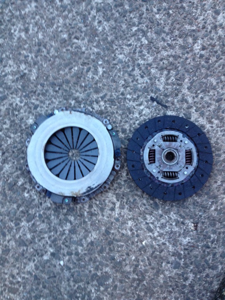

Pulled the gearbox off again and find that the clutch plate, pressure plate and flywheel have oil on them and the bottom half of the bell housing is a little bit oily.

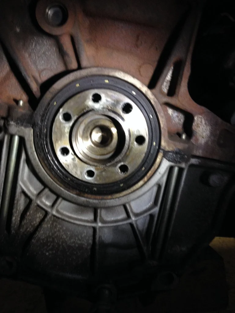

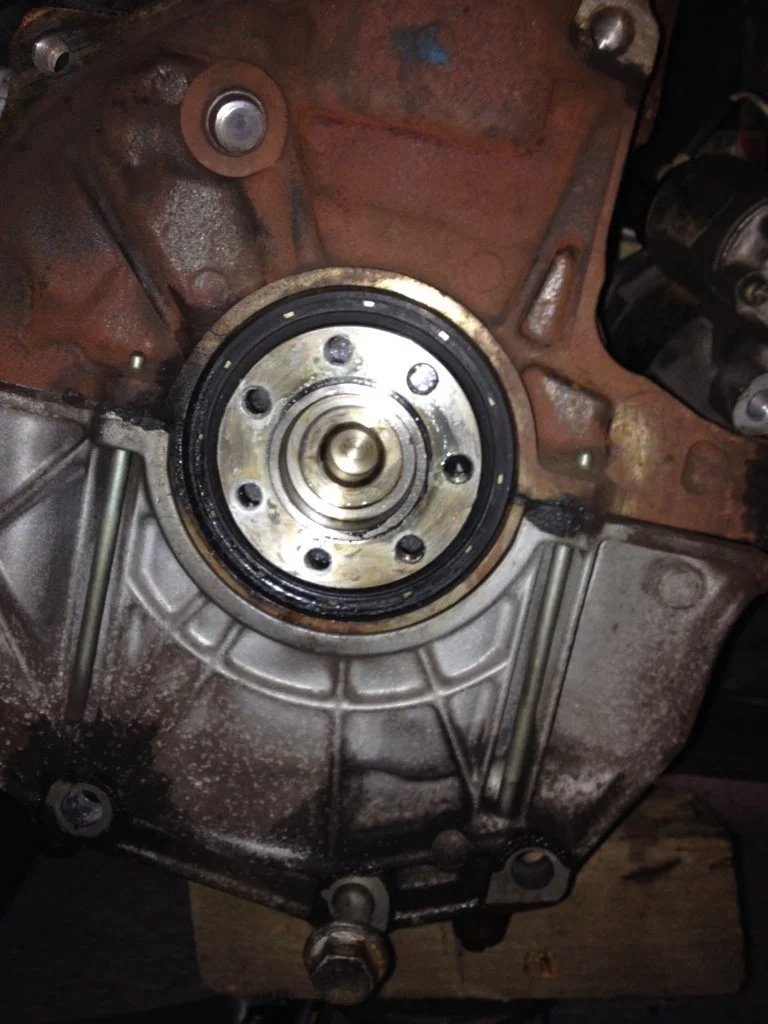

I'm assuming that the only place that the oil can be getting into the box and into the clutch must be from the cam seal as there is no sign of oil that could be leaking from higher up and down into the box, is this correct?
If this is the case, whats the procedure/best way to remove and refit a new cam seal?

If its the actual seal, you will have to take the box off, if its just the maincap not sealing properly its just about possible with the box in place still although awkward (assuming its same as a 172 which I would expect, but I know little of the DCi specifically)

Box, clutch and flywheel are off already so that's not an issue. Just removal and refitting I need some direction for!

just dig it out and push a new one in if its the seal itself you think is gone.

Dig the old one out (be very careful not to damage any of the sealing faces), then simply push the new one in, giving it a smear of oil on the outer and inner faces.
Make sure it is flush. Job done.
I did the crank seal on my Megane, it looks more daunting than it is. It's quite simple really.

From looking at the pictures does it suggest that the seals away? It was only dropping oil when it's hot and I can't see anywhere else that the oil could be coming from.
