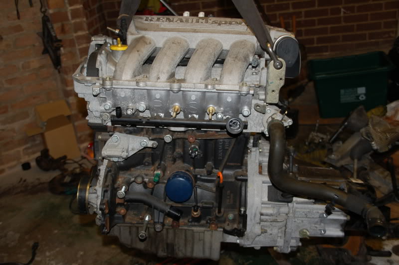

where's the connector to the low pressure switch?
probably need a pic :)
front of the block, you might have to whip off the fuel rail cover
i honnestly can't remember! i think so
the top one is the knock sensor
and the bottom one is the level sensor
a few months of not playing with them and you forget!
Freds right green one. Surefire way to test the pump would be pressure gauge in that port if it looks bad.
