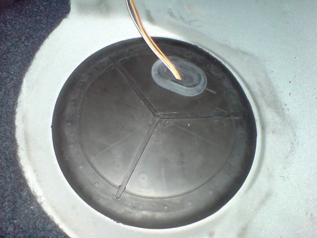

2) Open fuel tank inspection hatch under the rear seat and have a look at the connections and at this point try and start the car again and listen for it start up.

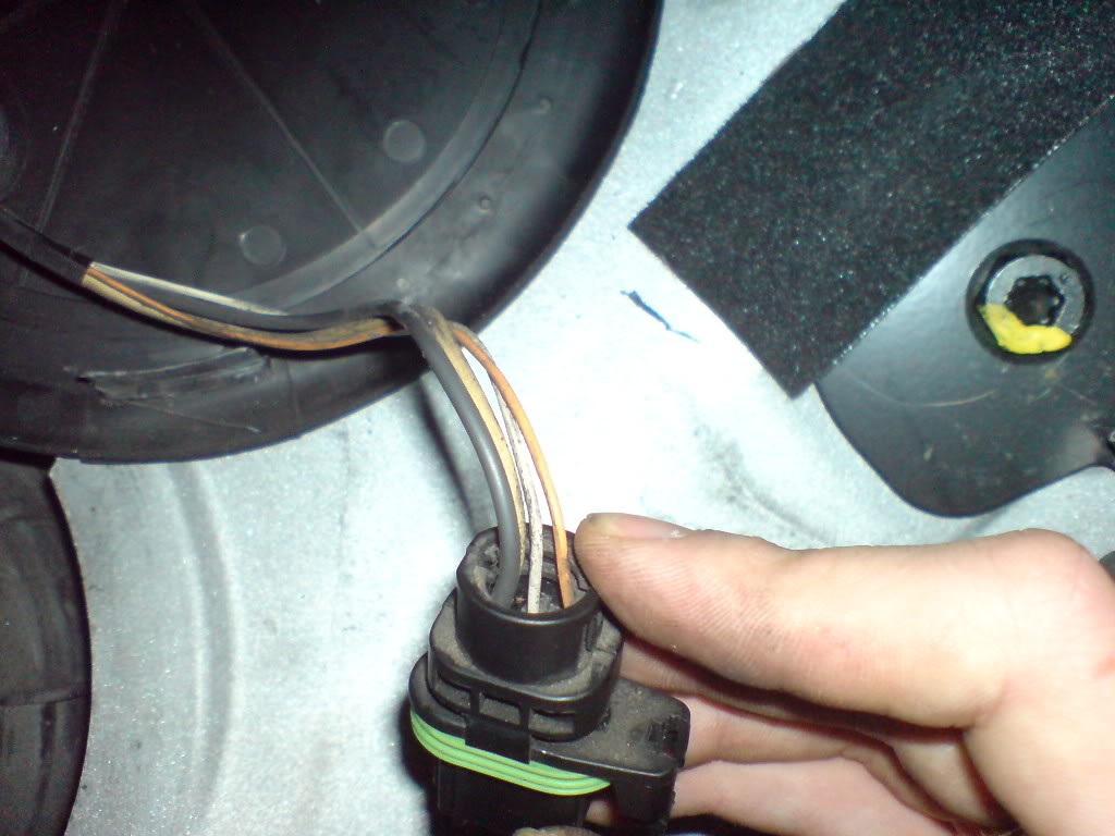

Cheers for the info mate much appreciated.......I have checked all the fuses I can find in the engine bay (5-6 fuses in total), where do I find the relay switches and are they easy to get to and check?

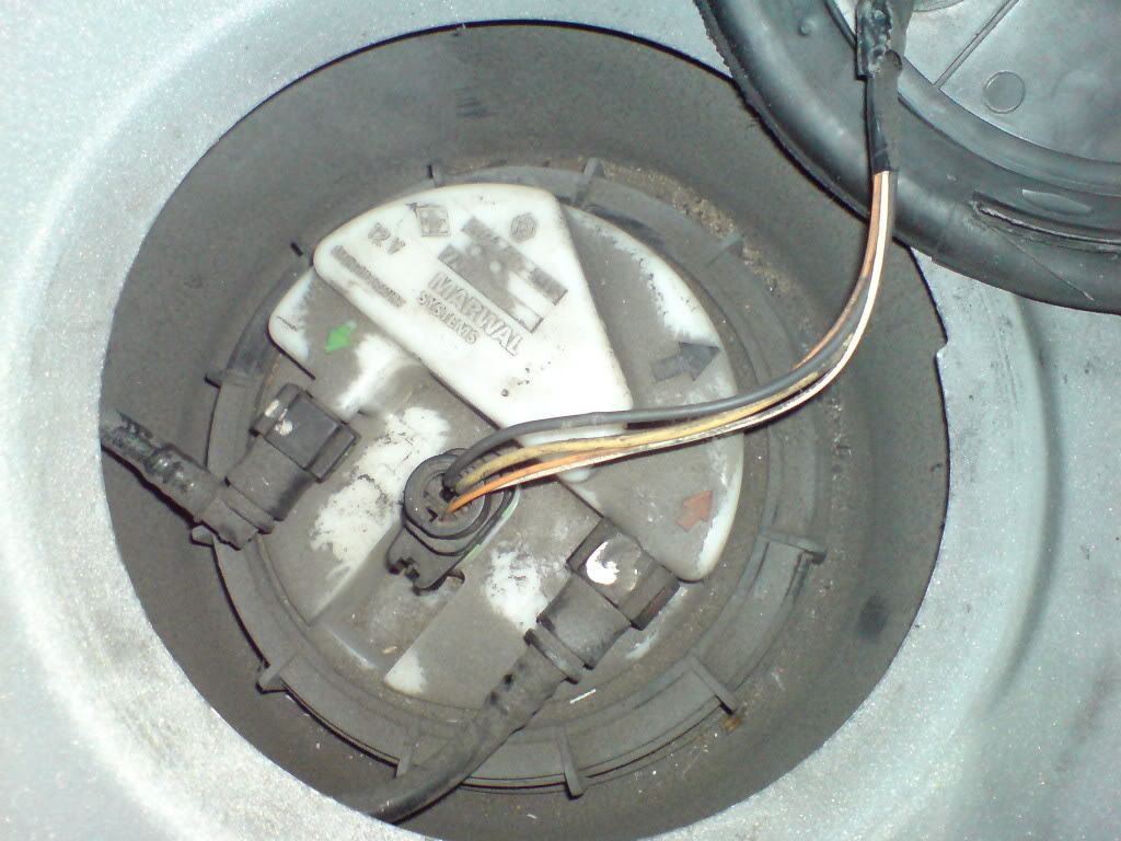

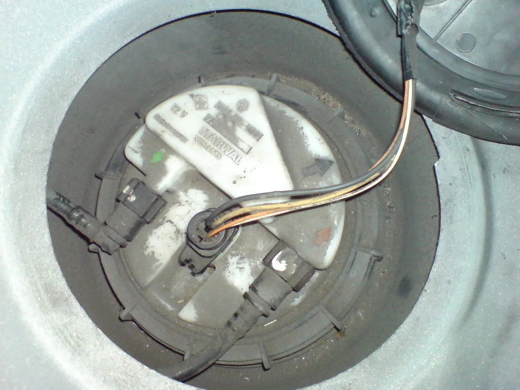

I have had the back seat up and opened the plastic lid to check the connections but I have no tool to check if there is power or not (will try and borrow one)......saying that though the fuel pump did not sound like it was switching on at all

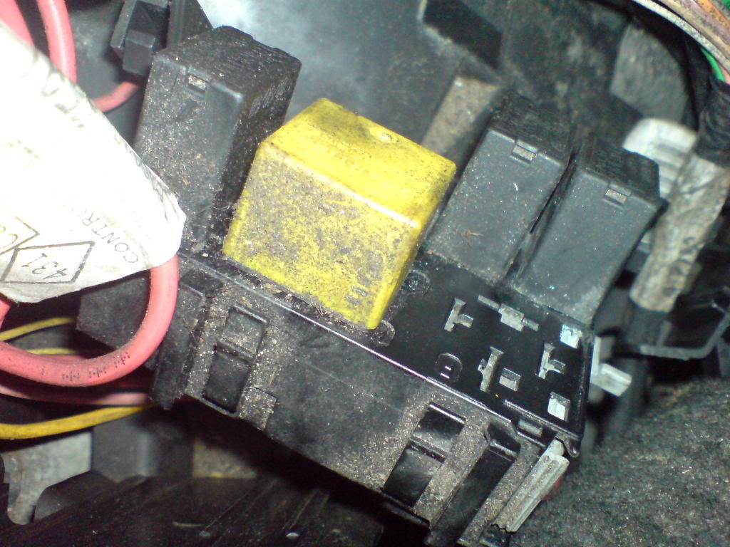

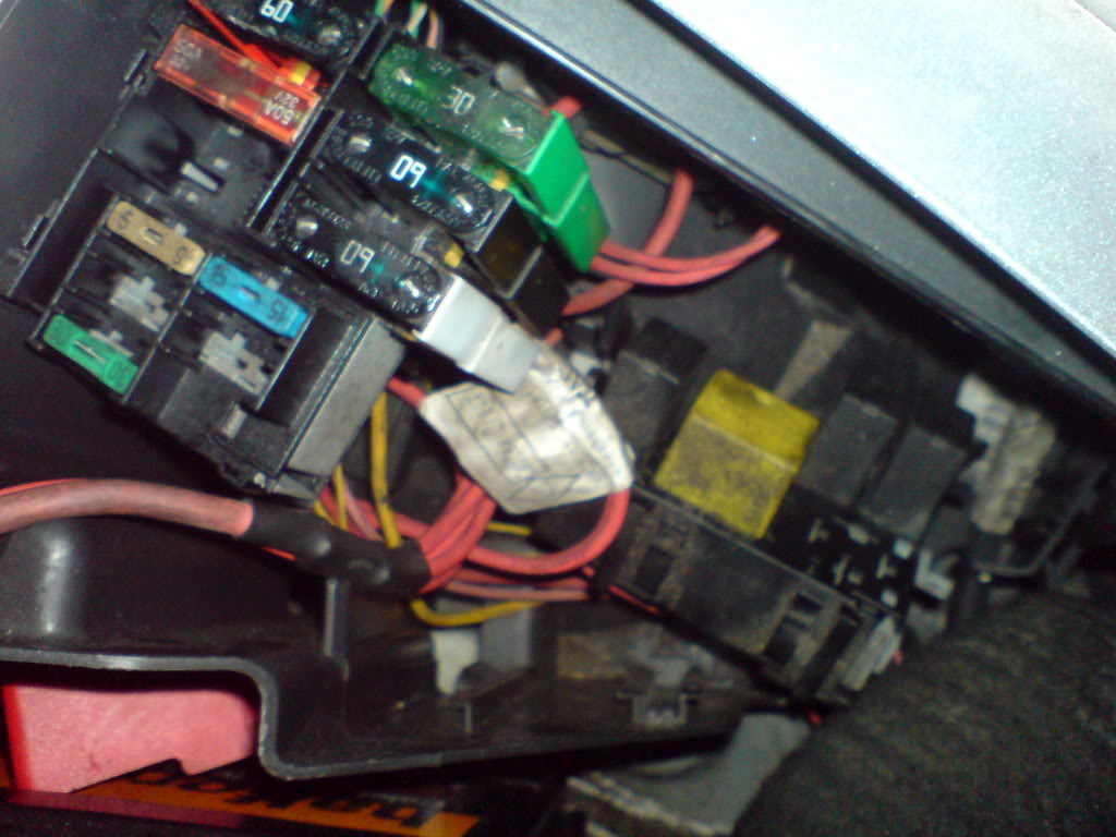

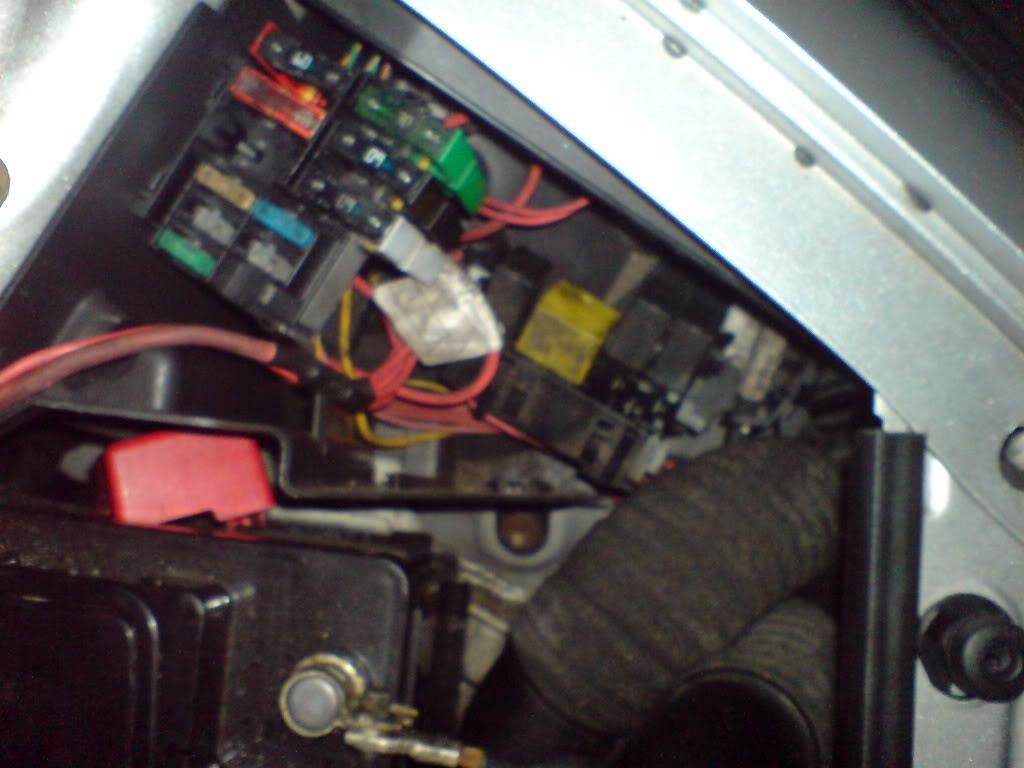

Need a little help on location of fuel relay switch.
I have located 4 relays which sits under the fuses in the engine bay
3 x black
1 x yellow
Is one of these the fuel relay switch? If so how do I test it and if not, where is it?

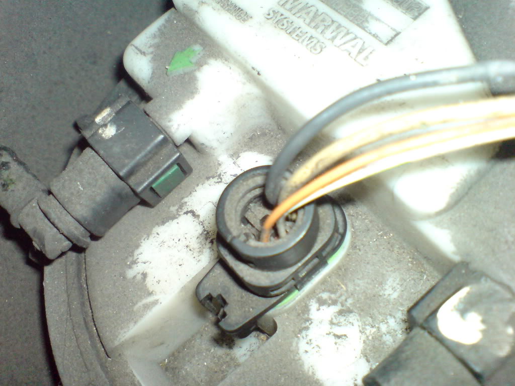

Another query I have is....How to test the connections on the fuel pump with a meter as in what wires do I test?

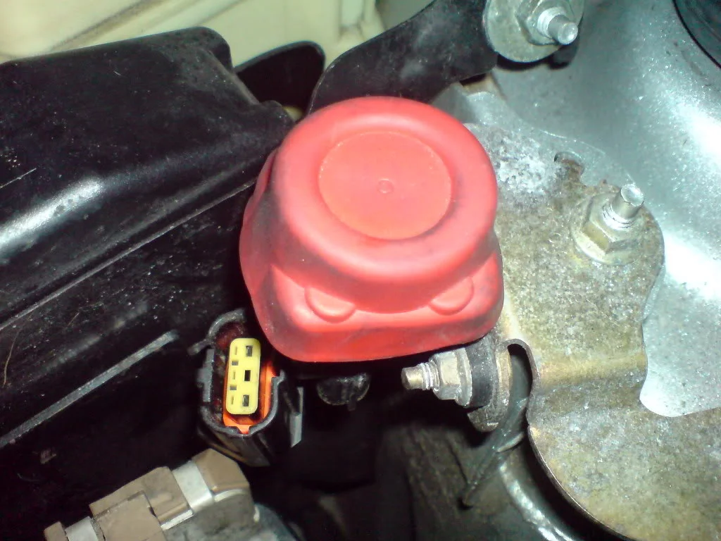

2 x wires fed from the fuel cut off switch
2 x wires, which I am assuming is the + and -

Going to need a pic of the engine bay relay box please. Does it look like this?:
Cheers bmh.01 for your help...much appreciated mate
Here is a pic of the fuses and relays in the same place as yours
As you can see it differs from your pic and you seem to have 6 relays + 1 yellow when I only have 3 black + 1 yellow......
Right finally got a meter and tested the car today. The read out at pump end connection is 8.13V so I know the relay switch is working and feeding power to the pump.
I left the ignition on when I re-connected the clip to the pump so I could have a listen but no noise of the pump switching on at all......so am I safe in saying it's the pump?

On the connection block at the fuel pump end there are 4 wires am I right in getting just a reading across the + and - and no reading across the fuel cut of switch wires?

The fuel cut off switch doesn't show up on the autodata wiring diagrams so I forgot about that. I don't know how thats wired in tbh, at a guess it'll be in series with the pump and cut the 12v feed to it.

I then checked the fuel cut off switch again and took a reading at the terminals to the left of the red button
here I got 8.2V
Am I right in saying the 8.2v at the fuel cut off switch has something to do with the reading at the fuel pump connection?
It is 1 of your black relay's mate. Theres 1 for your indicators, 1 for the cooling fan and 1 for your fuel pump aswell as spark plugs. I had the same problem because the relay was corroded inside due to the crappy fuse box cover is not very water tight. I just used the fan relay one for the time being (and it started first time) before i got a new 1. But watch your temp gauge lol. There £15 - £16 from renault.
The other two pins in the fuel pump plug should be for the tank level, are you sure they go to the cut off switch?
Yes i'd say theres a problem somewhere if your only getting 8.2v at the switch, time to trace and check the wires in the bay.
Well I assume they are the wires that connect to the fuel cut off switch because of the same colours either end.

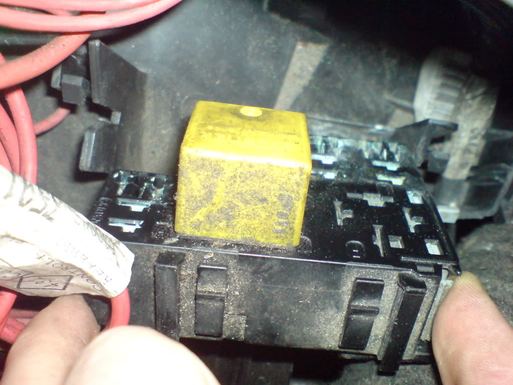

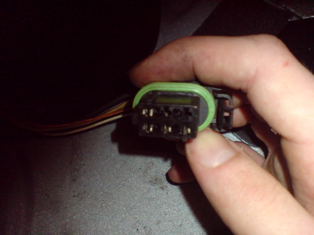

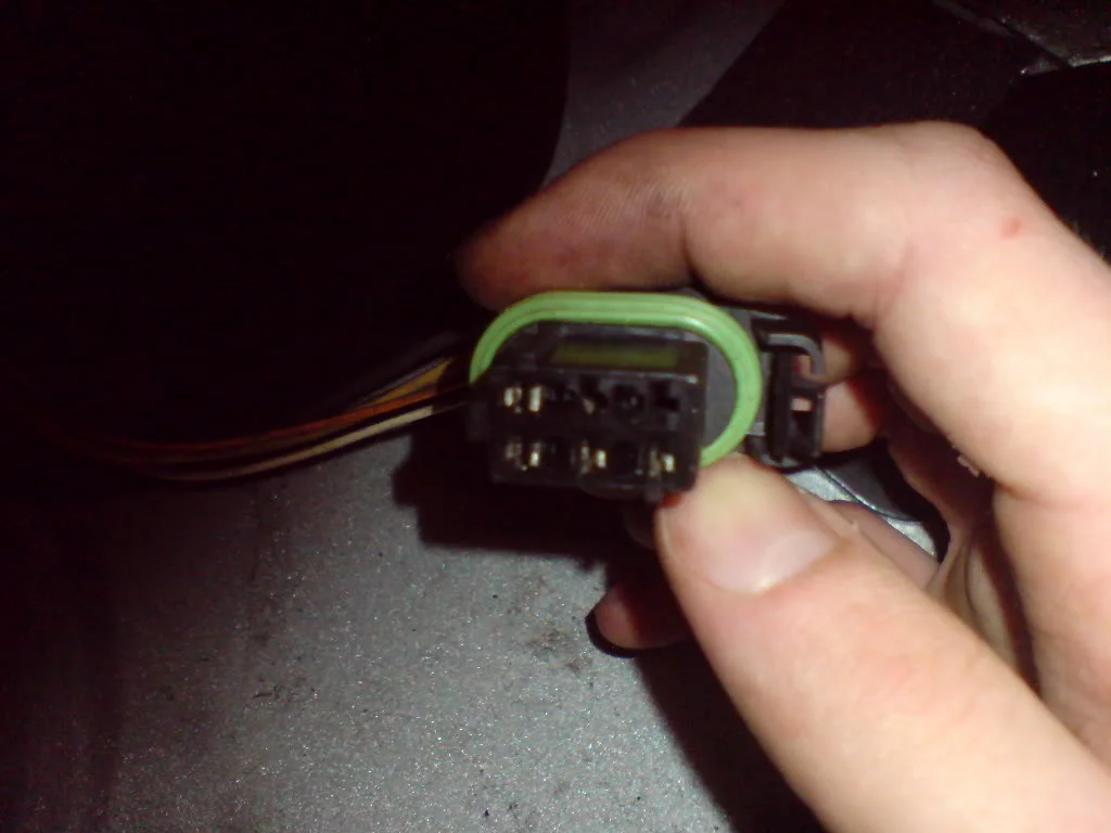

From the look of that picture, water has been getting in there and corroded the terminals (green is copper corrosion) could explain low voltage from excessive resistance. clean with contact cleaner and old toothbrush and try again with voltage checks

Cheers for the heads up mate I will try and clean that up and give it another go and see what happens:quiet:
it's just i had that sort of corrosion on my oxygen sensor (lambda) and was playing up. cleaned it and fixed the prob

Inside the relays they are corroded aswell, which means you have to buy new ones. The reason you have no power to your fuel pump is because of your relays are f****d. I had the same problem. I ran a wire from the battery to the fuel pump and it worked, but the engine still didn't start because there was still no power getting to the spark plugs because of the relays. Clean the terminals inside the relay holder and swap the black relays around (the smaller rectangular shaped ones) and see if the engine starts. If that doesn't work then there is some more relays under the glove box inside the car. These are for the wipers etc. And there should be another black one which is for your indicators. Try using this one if the other relays dont do anything. Just move the realys arond in all slots and see if anything happens.
All the relays that are the same colour are the same so it wont damage anything if you swap some of them around.
