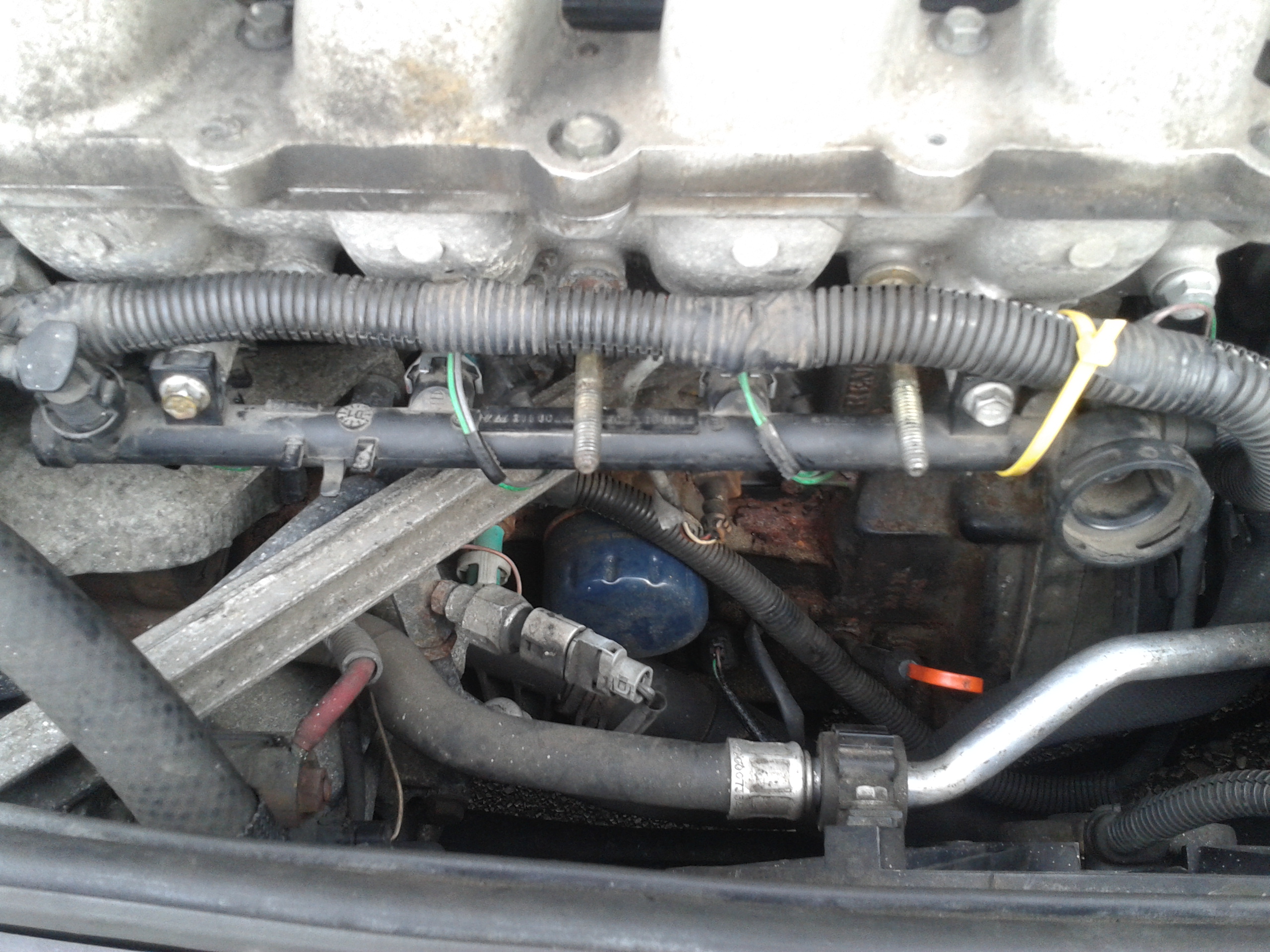

Should look like this with the guard off , loom on show on the rail
