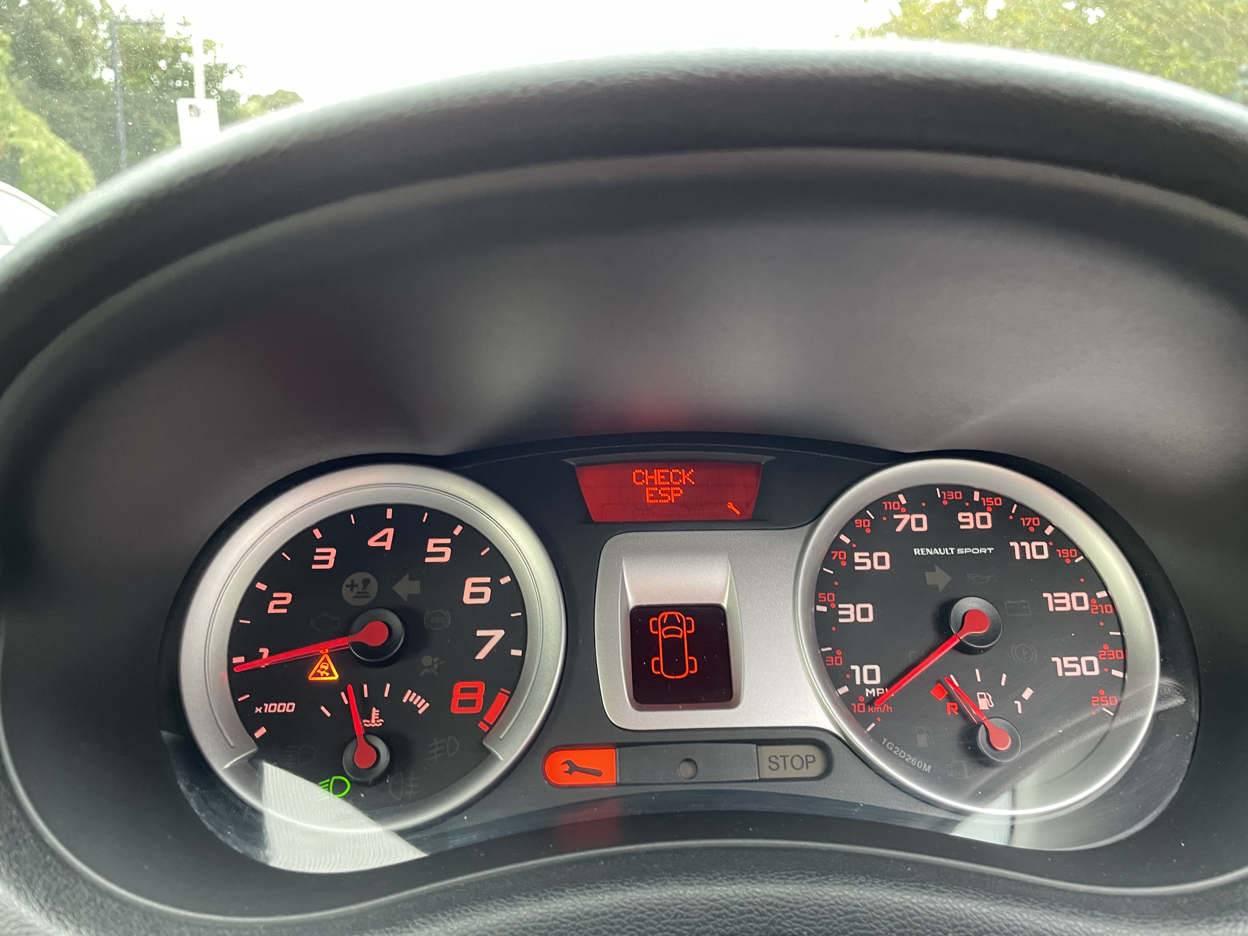

Morning all, I have been battling with an intermittent fault on my 197 to do with ABS/ESP for a while now and was wondering whether anyone has experienced/found a solution.
The car is pulling the DF126 fault code - "Control Panel Sensor Information Plausibility".
2 things occur when driving:
The ABS kicks in sporadically without even touching the brake pedal. Keeps you on your toes but also not very desirable!
The dash lights up with check ESP.
Attached are pictures of the diagnostic read out and dash.
It feels to me like a sensor issue of some kind but even the Renault main dealer is struggling to clarify which sensors are causing the problem.

The dealer needs to update CLIP as we’re on v220 and generally are behind dealer Net.
From the description I’d say it sounds like an issue with the ESP Switch. Check the switch status in PR’s and then remove it, load test the wiring back to ABS and possibly strip the switch down, clean and reassemble.

Thanks very much indeed Mick let's give this a go....
