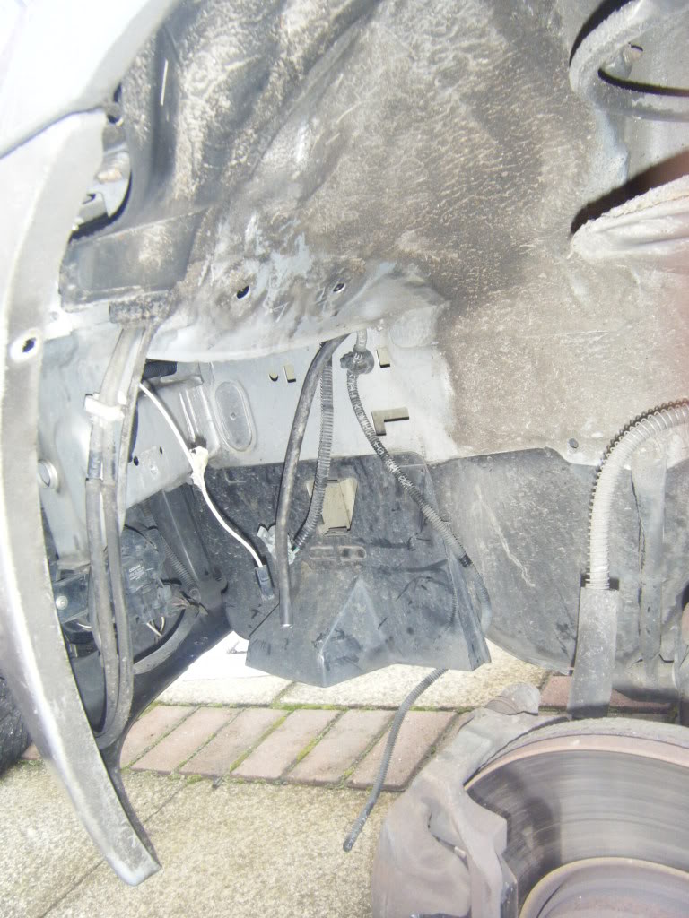

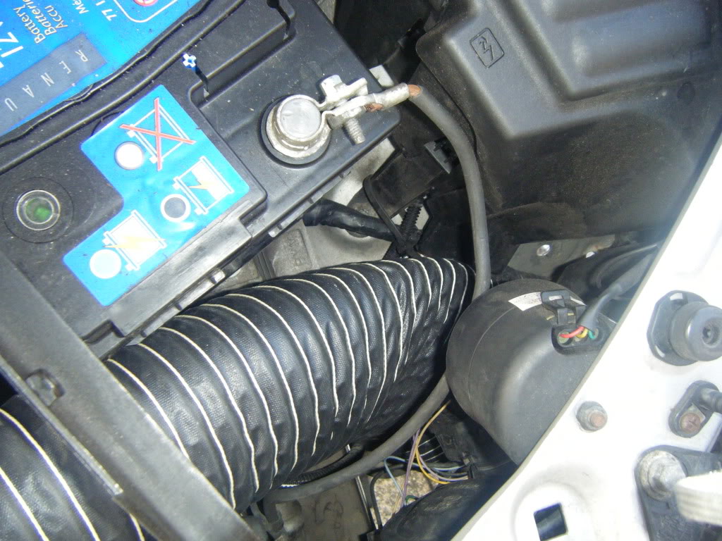

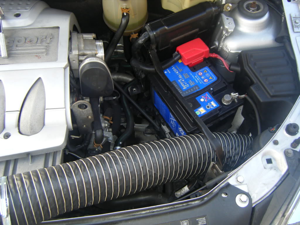

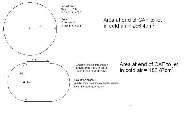

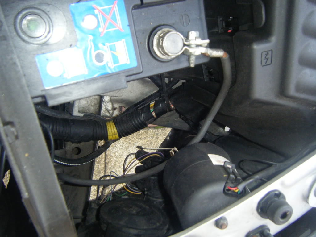

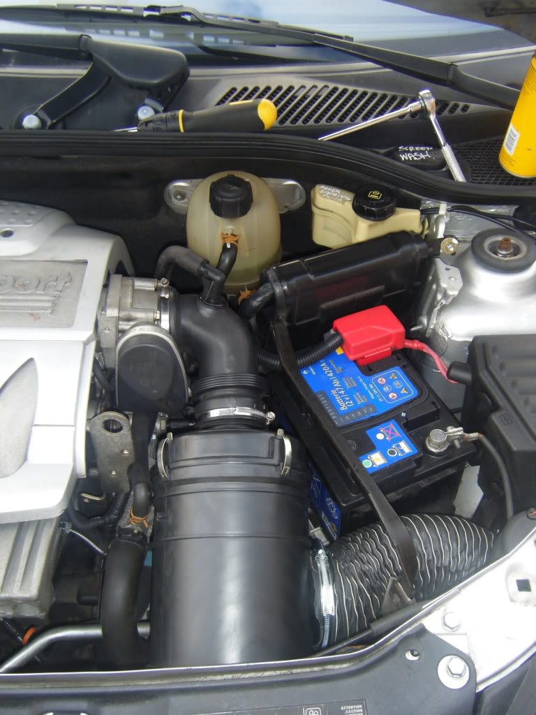

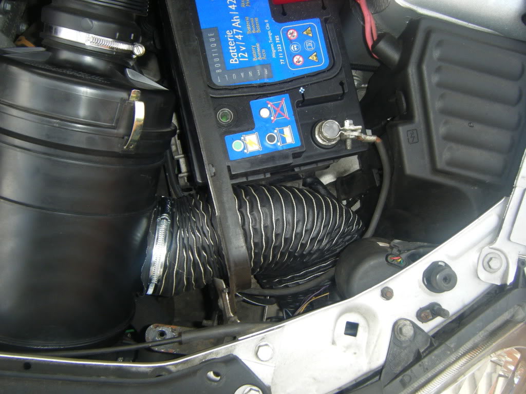

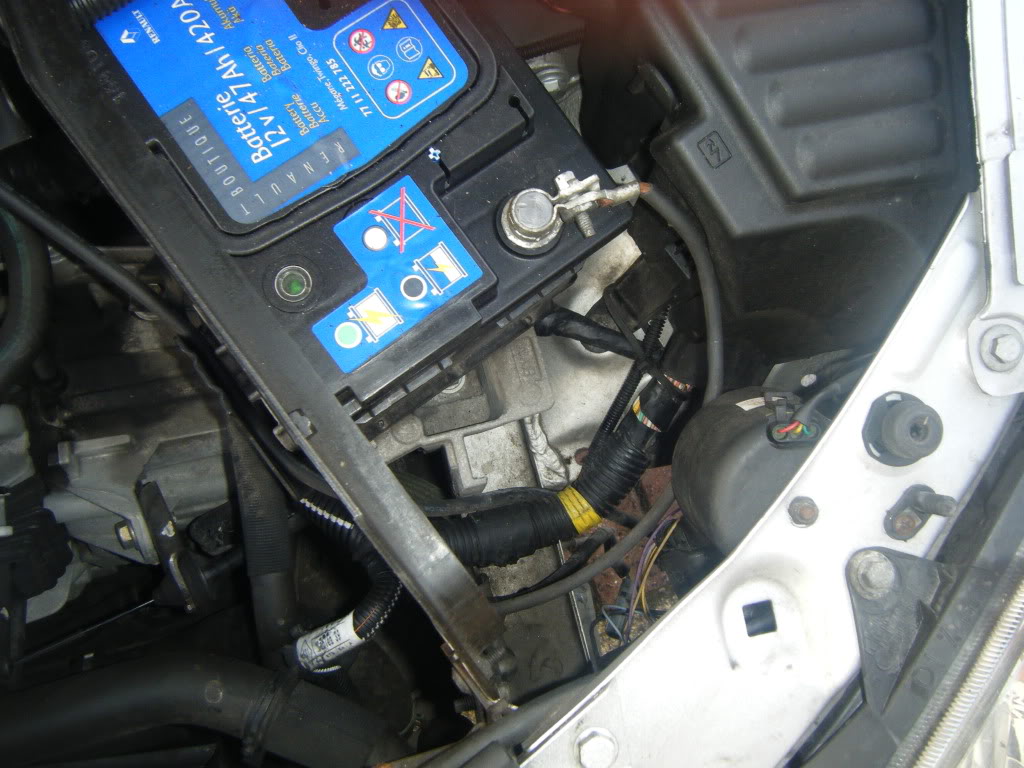

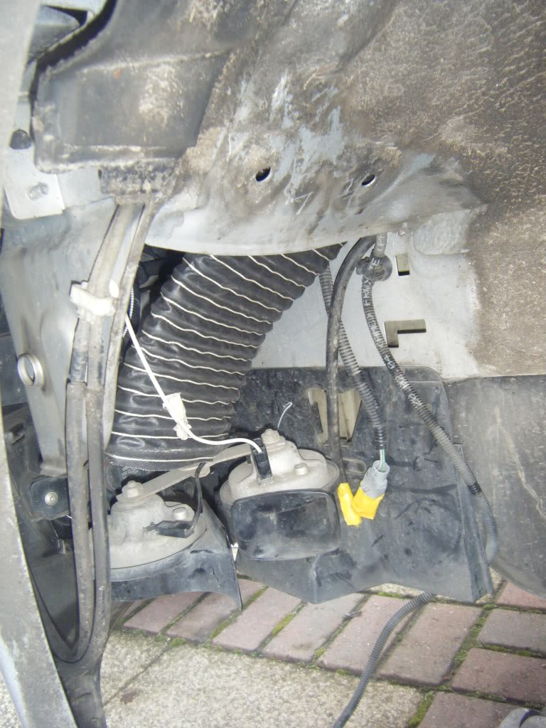

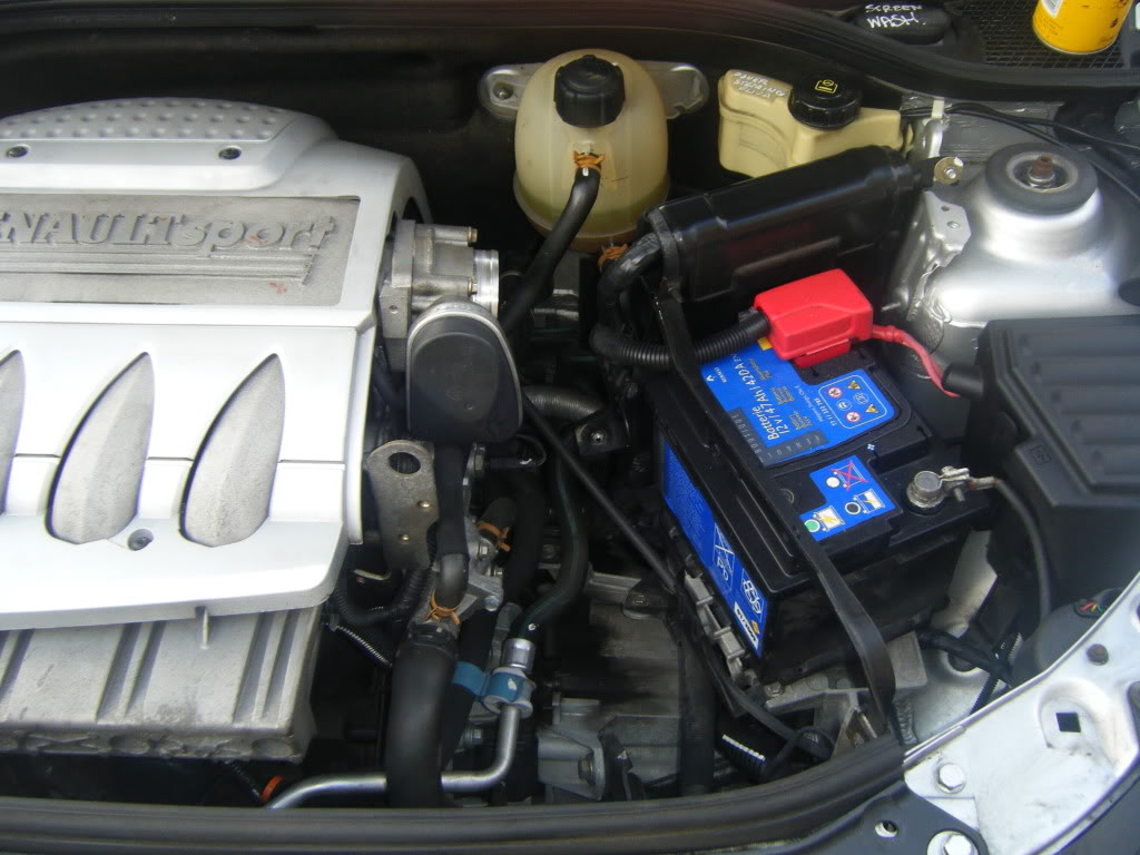

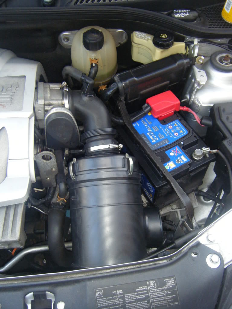

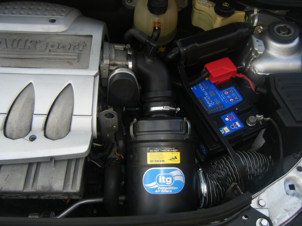

Anyways, thought i'd show you all my mornings work! Whoever said feeding the CAF was easy is lying LOL, had a right mare lol! Got there in the end and dead chuffed with the results!
I used the Trophy guide to remove the acoustic valve, that really was a pisch easy task!
Here are a few progress pics and pics of the end result, enjoy...

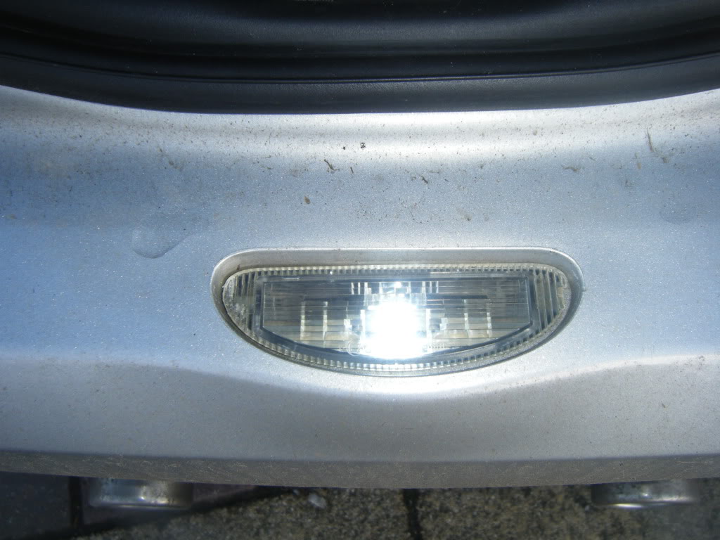

Oh yea, also got round to fitting the number plate bulb too lol (cheers Curley)...
Note; i know my engine cover is brokedid and even though they're handy, i didn't tipex my engine bay lol! Previous owner did that
