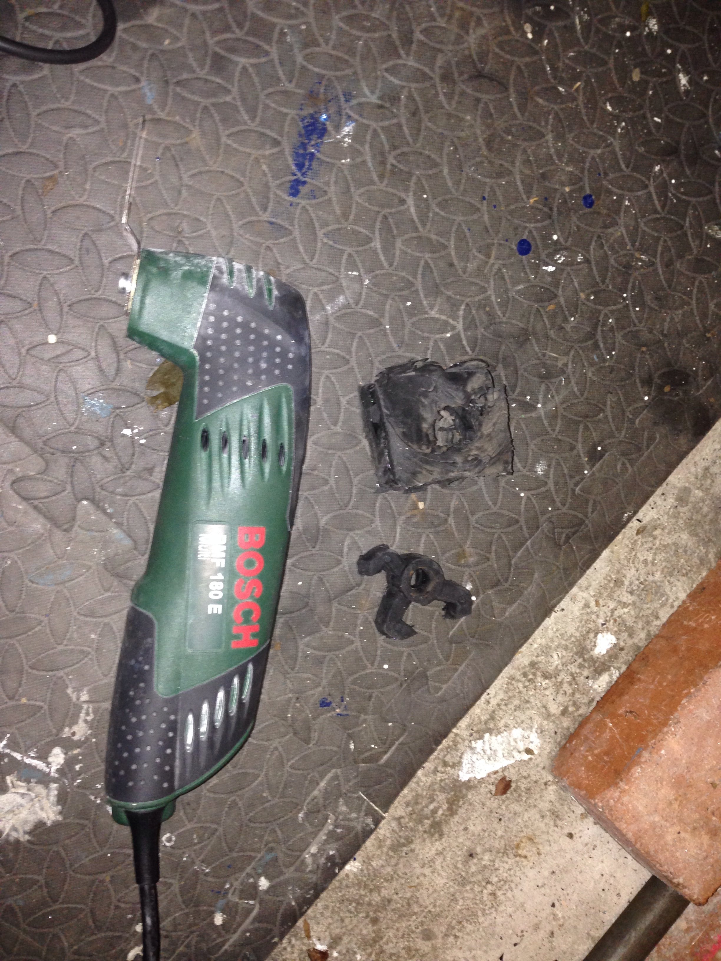

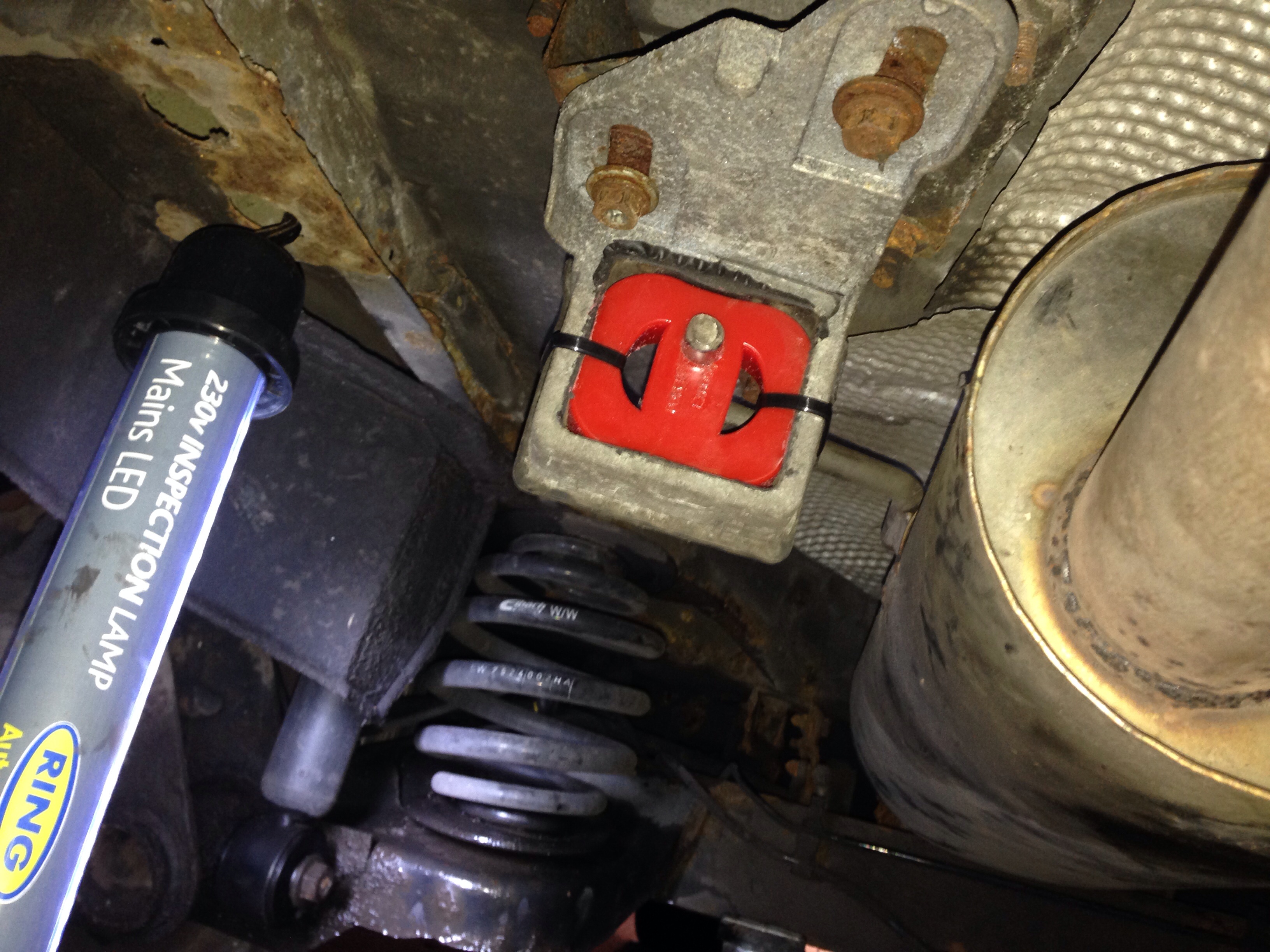

You can fit them in situ, ive just done it this afternoon.
Was not as hard as i thought i used a bosch cutter to get rubbers out, just cus i had it to hand could easily be done with a knife etc.
I used a jack to hold my exhaust in postion whilst marking the mount for where to cut.
Once marked i drilled a hole slight above the postion marked to allow for the weight
Very pleased with outcome. Give it ago mate.
