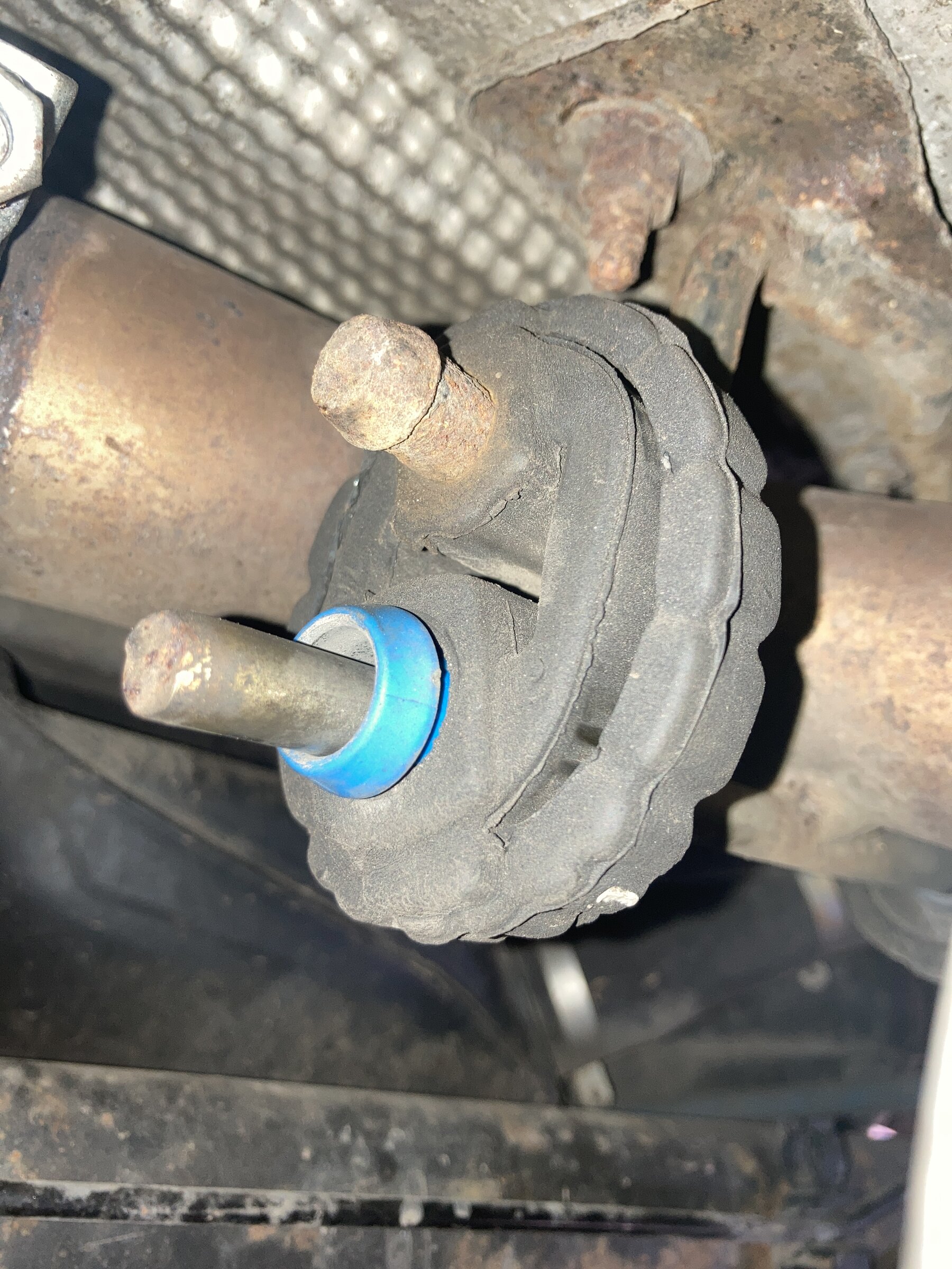

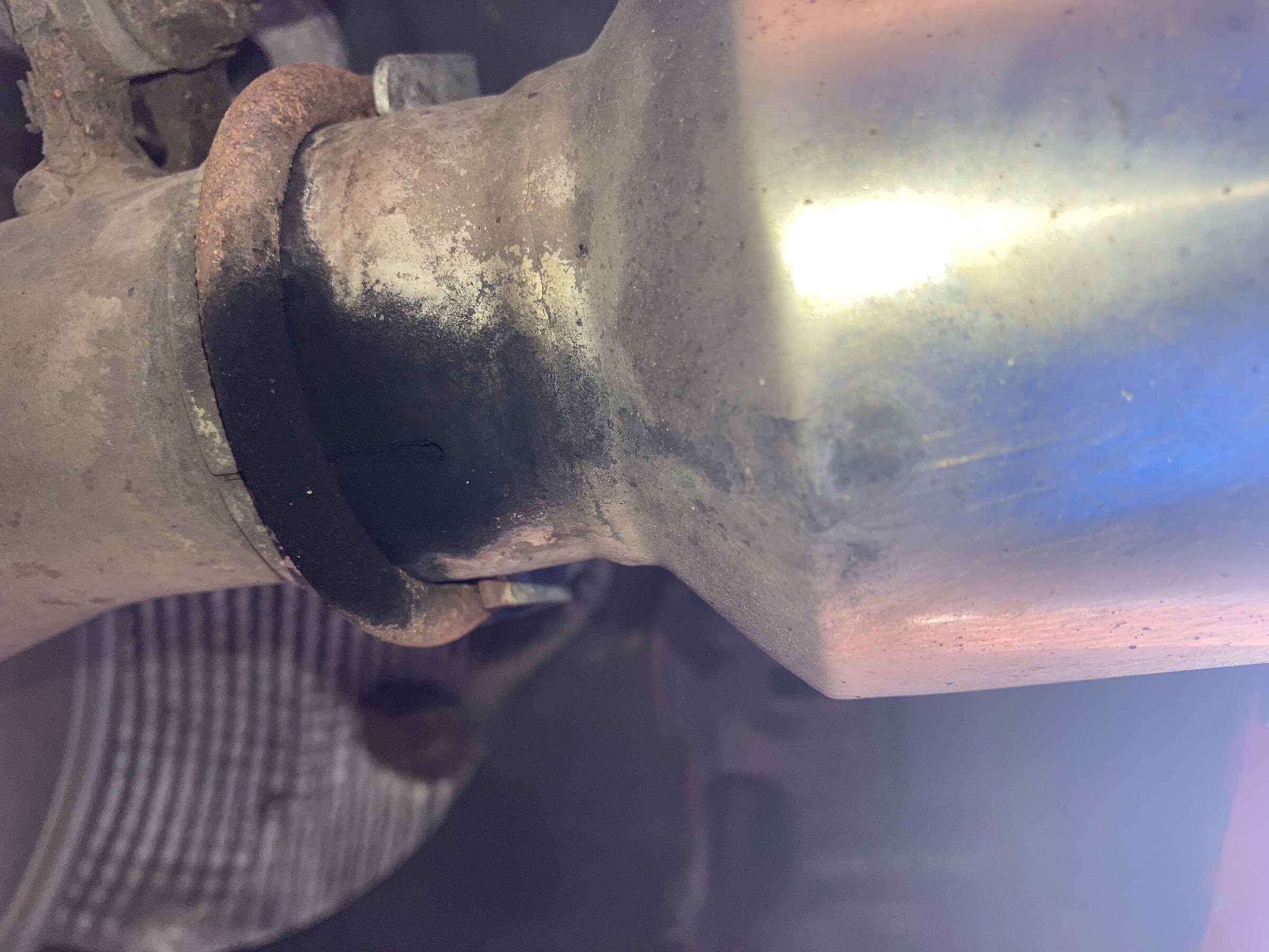

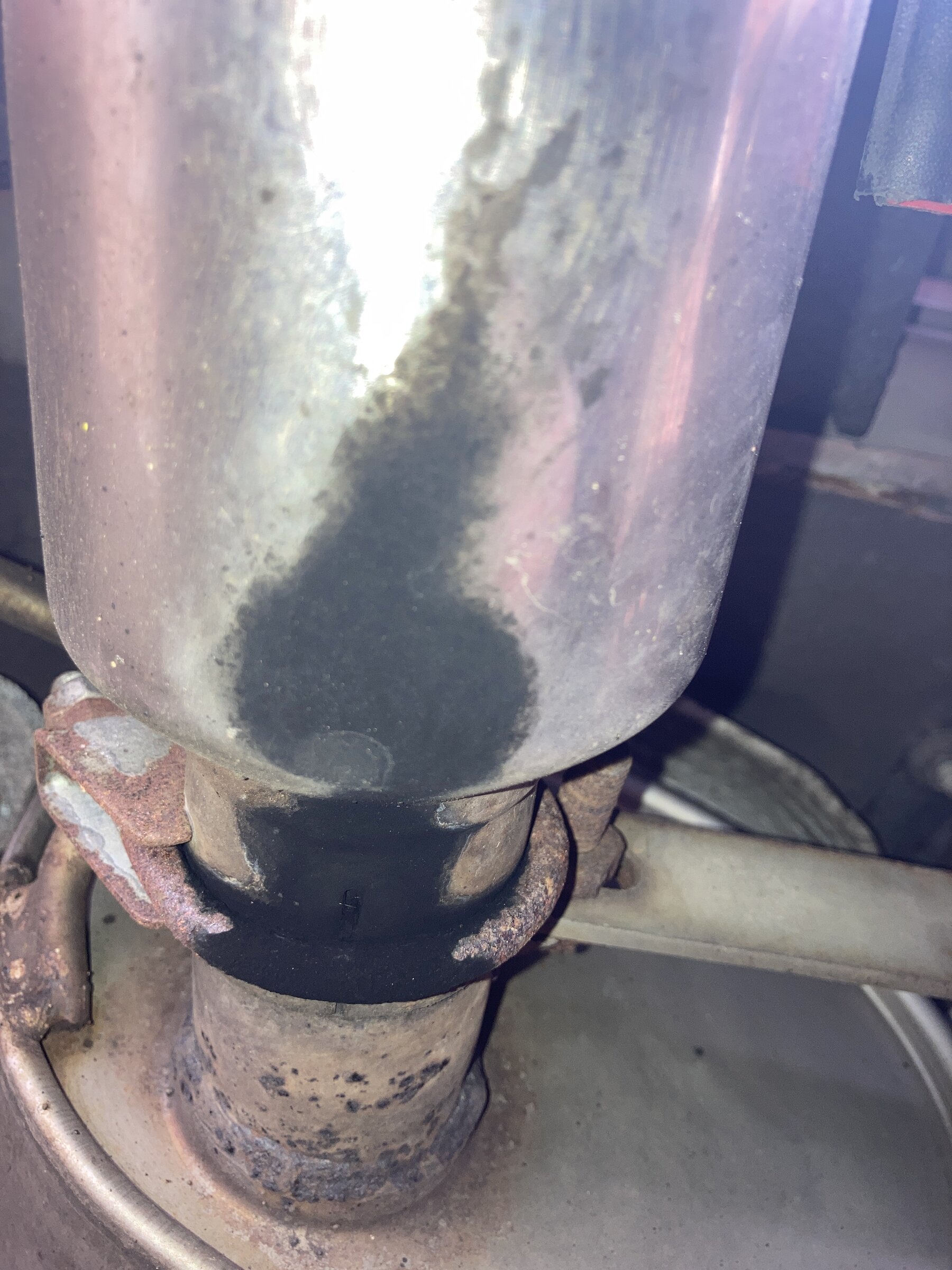

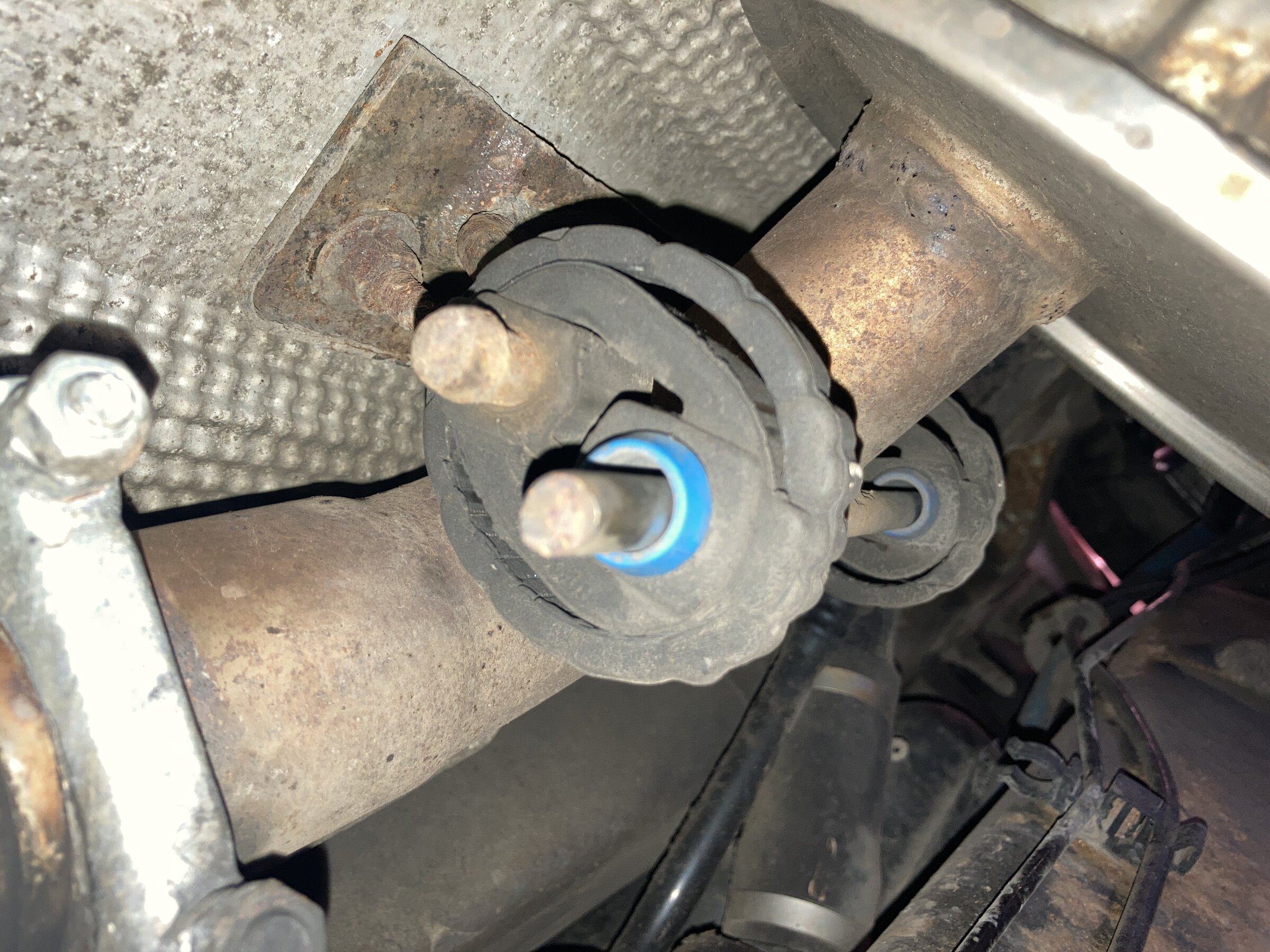

Need new mounts for rear of back boxes and have carbon deposits around tailpipe joins to back boxes (make of exhaust unknown, no markings)
Lots of play around the blue bits causing rattling.

Looks like tailpipes need pushing on, may be some exhaust paste, possibly new clamps required?
