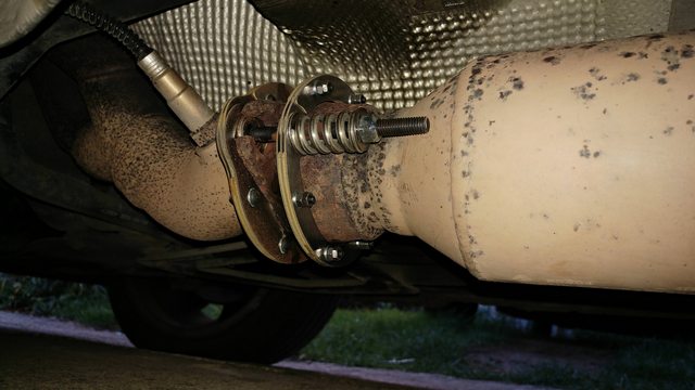

I had exactly the same issue with my cat flange disintegrating. So I designed an easy-fit flange that requires no welding and uses some of the parts from the standard fitting kit. Although I'm now thinking the kit could be eliminated, as springs are available separately.
The bolts are currently the wrong length, but this proves the concept works. I also have a flange that fits the manifold side too, as it had rusted so much that the fitting kit cups wouldn't stay in position. The previous owner had simply fitted large washers and bolts - another tell-tale sign of whether a vehicle has been looked after!
  BG Clio 182
That's a damn good idea
