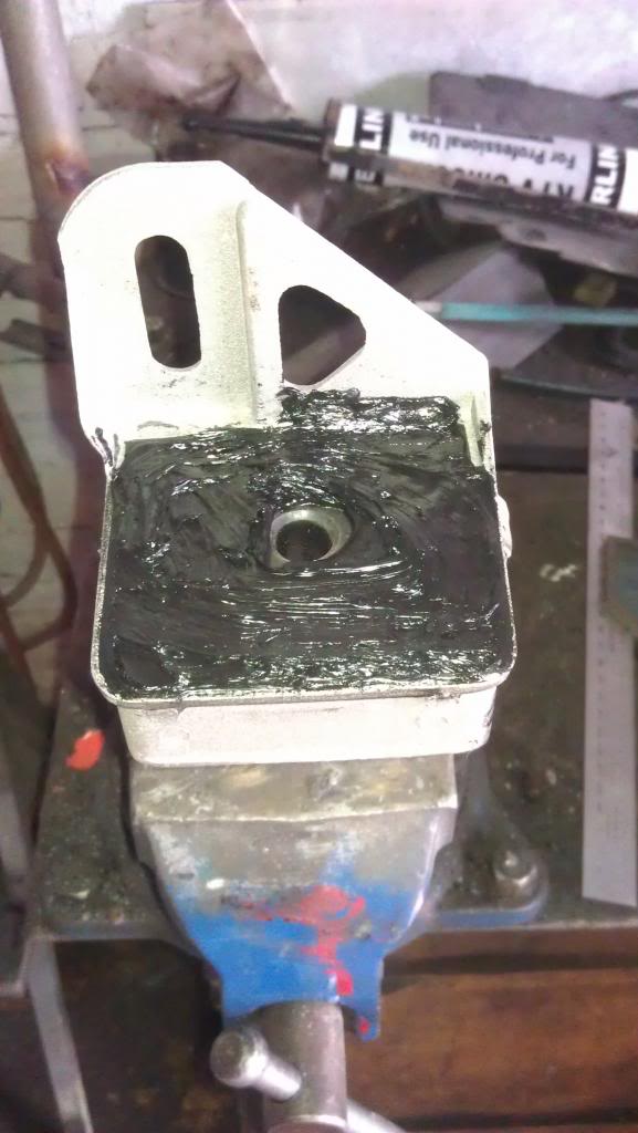

Can cut them out and burn out the old rubber thats what i did the other day for if my silicone mod fails..

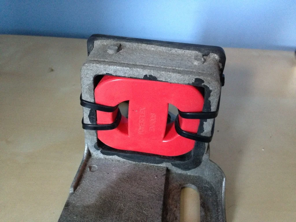

Cut out the old rubber then trim a couple mm off the end on the Powerflex rubbers, side them in and add cable lies for good measure :) job done

I have also went round the edge with tiger seal to fill the holes.
I never cut my powerflex bushes, I forced mine in with some spray lube so i know they are in tight .

Cool, thats just got me thinking of fitting the mounts as they come and putting the powerflex in my old mounts after removal rather than damaging new ones. Will use those until they're buggered then replace with the powerflex.
