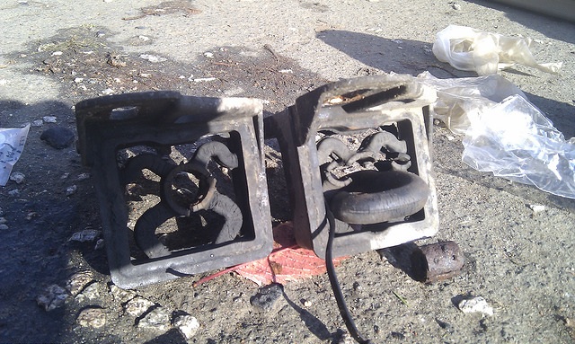

I would be having a word with Fred to see if you can get a couple of the new mounts he has developed. They look way better than the old ones and the rubbers should last longer and if they do perish they cost pence to replace.
Dammit, I was settled on playing with a bucketload of sealant but that powerflex bodge looks pretty good....

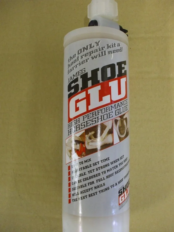

Mine are bodged with copper pipe and some of this stuff jameg.webp been on the car for over two years and still looks as good as new.
Lol. Trying this at the mo ;) did you burn out the old rubber? They are a bugger to remove
removed them with a very sharp knife.
still going fine on my dads Clio that we fitted a week after doing mine. although we cable tied mine, we also ran a strong sealant round it and ended up removing the cable ties. still not moved
