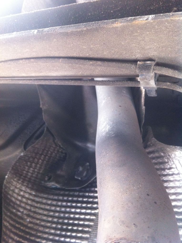

I know this has been asked a million times, but I can't seem to find an answer.

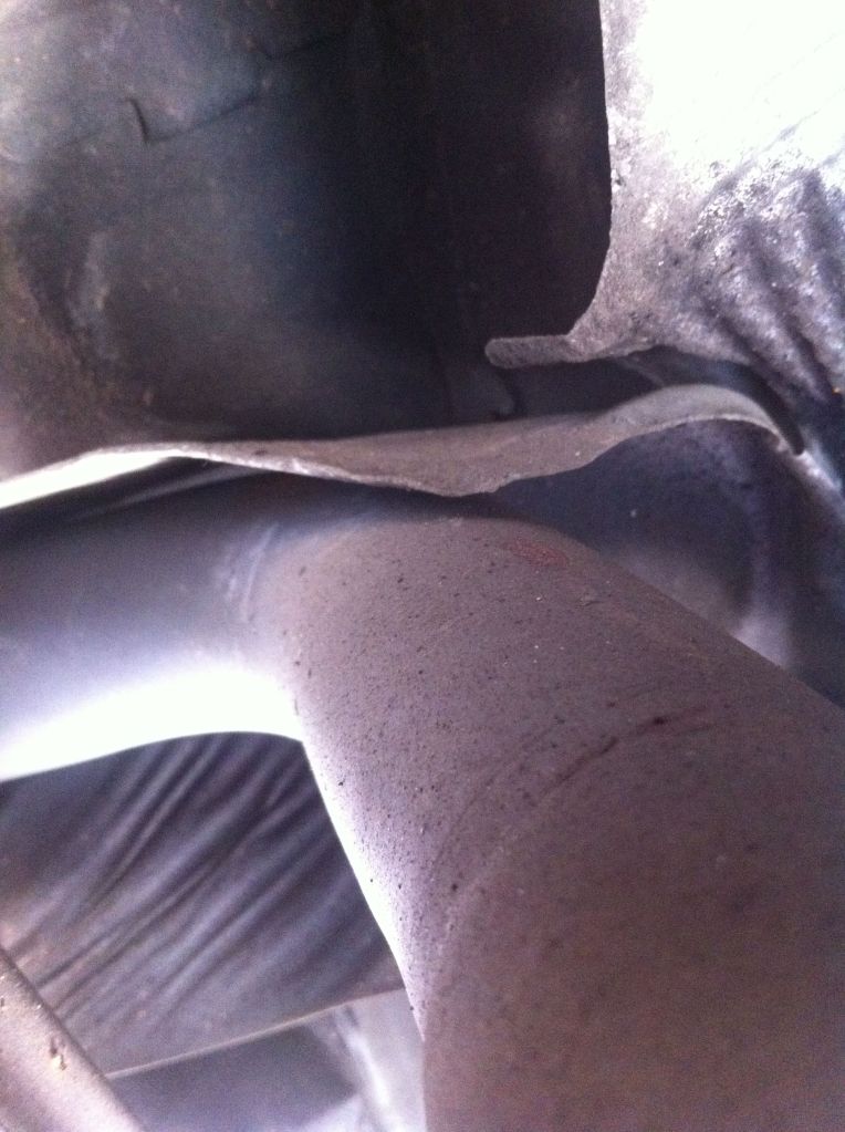

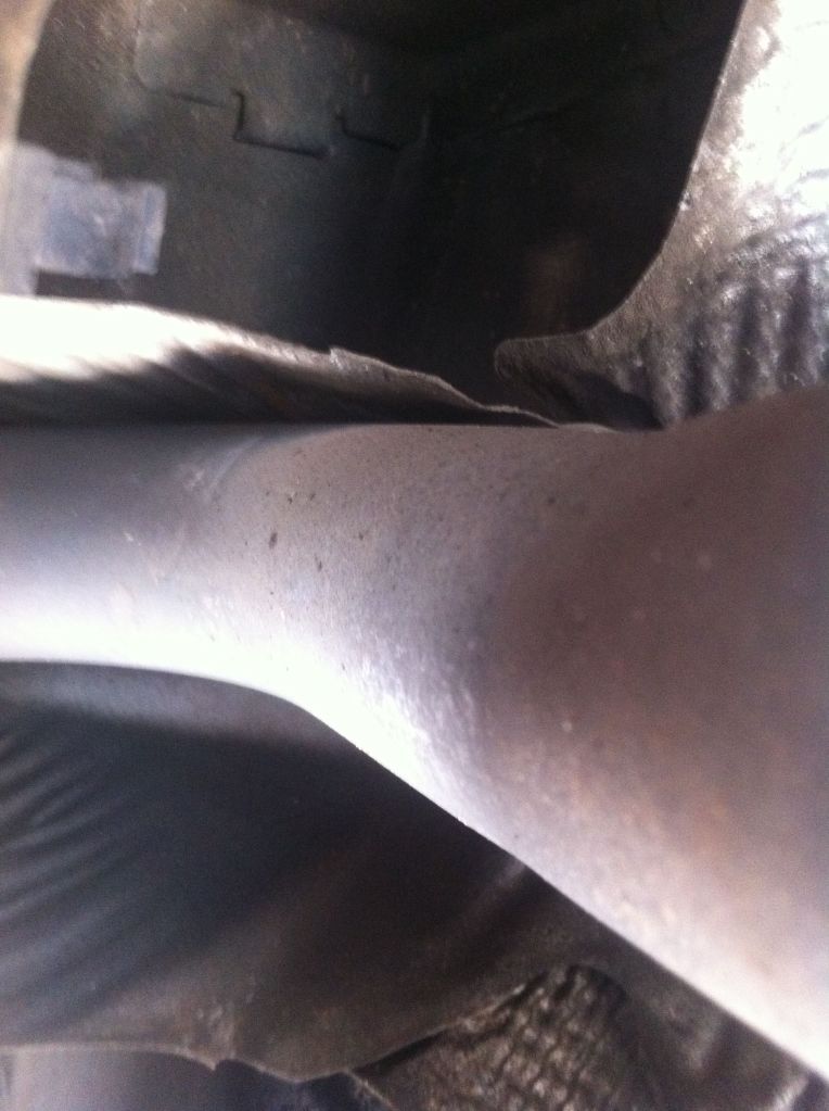

I am assuming my exhaust it rattling against a heat shield as its touching it right above the rear beam:
I've tried bending it away but it just reverts back to sitting against the exhaust, shall I remove it?
EDIT: Yeah I know I spelt assuming wrong!
  Clio RS 172 /Trafic

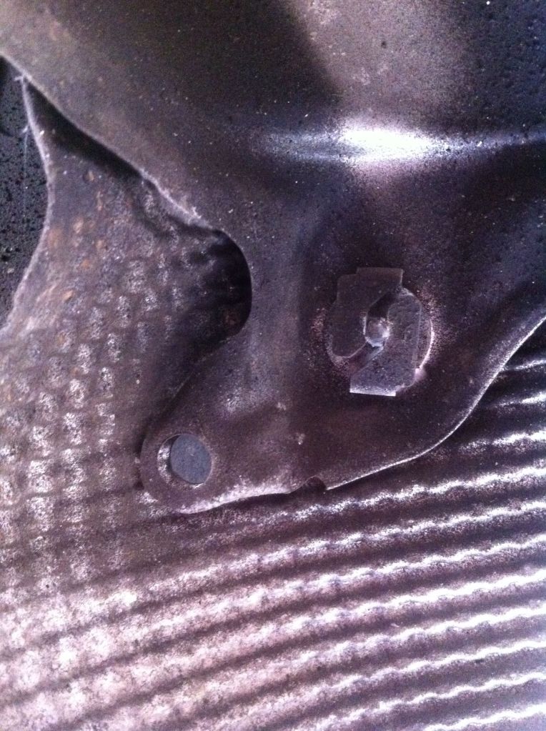

It's the rear heat shield. The fasteners break and the shield comes loose. Get some self tapper nuts and flat washers and fit them instead of the spring clip type fasteners.
