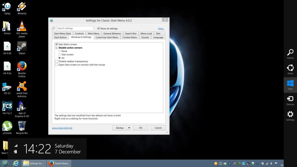

The stupid charms bar or whatever it's called on the right hand side keeps coming up, even if my mouse is only 3/4 of the way right on the screen, doing my head in.
i've tried to disable it with registry tweaks, also running classic shell thing and there are options inside that to turn it off, tried that. Still doesn't work.
Looked at my track pad settings and disabled the side swipe gestures and anything to do with the edges etc. Very annoying!

If you're still using classicshell:
Right click on the start button, and go to settings. In 'Windows 8 settings' disable all active corners. That should fix it.
  FF RB 182
Thats what i did before mate, it works for sometime, then it starts appearing again. It's not doing it, but it will more than likely start doing it.

Just removed classic shell, re doing the reg' keys so its enabled, then will install classic shell again and disable it in that.

Edit. Classic shell DOES disable it, if i enable it then disable it, it's obvious just have to put my cursor to the right and it pops out. But STILL with it DISABLED something is drawing the f**ker out.
